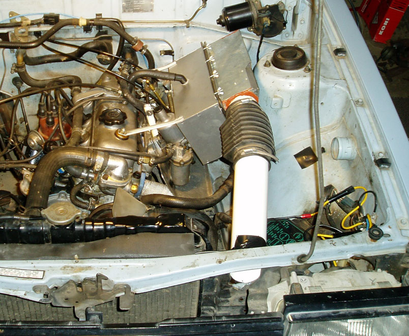

Like the job on the airbox.

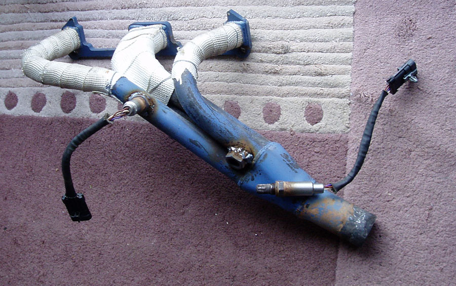

OK, I have the two VT oxy sensors, two 18mm nuts to be welded onto the extractors and a Jaycar fuel mixture display..but no second car as the wife has gone up to Northern NSW for a few days to pick up the daughter in the Altezza.

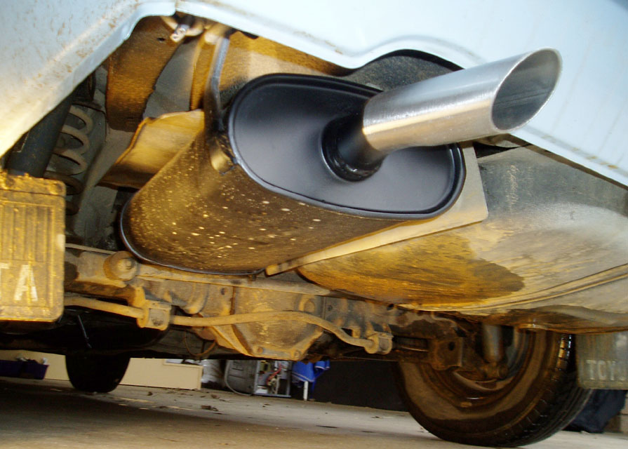

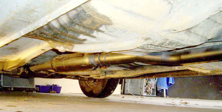

So the rolla went down to Central West exhausts to have the sports system completed. When I fitted the exractors they ran them into a 2" pipe and a 2" resonator, then back into the stock system. Now it goes from the resonator into a 1.75" pipe and terminates in a chambered muffler- Redback I think.
It sounds great- too quiet for any of you young guys with a straight-through, but its hardly noticeable inside the car and growly without being raspy outside. It reminds me of an MG-B.
Even came with a polished stainless tip! :jamie:

i love that airbox, and how youve got that huge filter in there. very nice design.
i wonder why you never see such a thing on 4age's with quads? i guess the brake booster is in the way a bit.

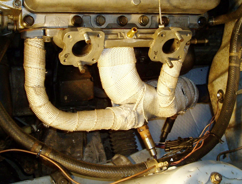

Well, I starterd with a pair of Commodore VT oxygen sensors from the wreckers for $40, and a pair of 18mm nuts. I drilled and filed the holes in number 1 & 4 exhausts and paid a welder $20 to fit them.
The worst thing was that the inner layer of fibreglass was too brittle to re-use properly!
They have to fit at odd angles to clear the chassis rail, but that worked out fine and they were simple to wire up. The sensor wires are running through the convenient rubber bung in the firewall.

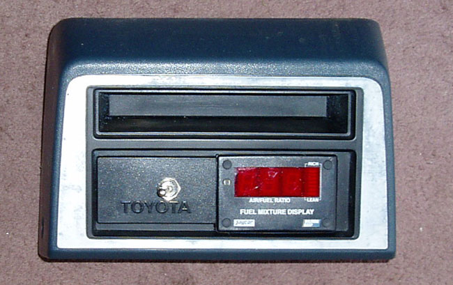

The girl had previously tossed the center console out, so I rescued that for the FMD meter that rb20 rolla gave to me. That was powered off the cigarette lighter.

The meters worked beautifully, the carbs were easily balanced and the needle options sorted. It ran at 7.5L/100km up and down, about 9.4L/100km around Melb and never gave a moments hassle. It cruises around 14.7 to lean, goes instantly rich when booted, and goes to 17 or more lean on over-run. I've got a couple of videos but don't know how to load them yet.

It reads R or L when it reaches the end of the bar graph. I've seen 20 on there for lean and 11 for rich, but really the important figures are 12 to 17 or so. After that its too rich or too lean.
