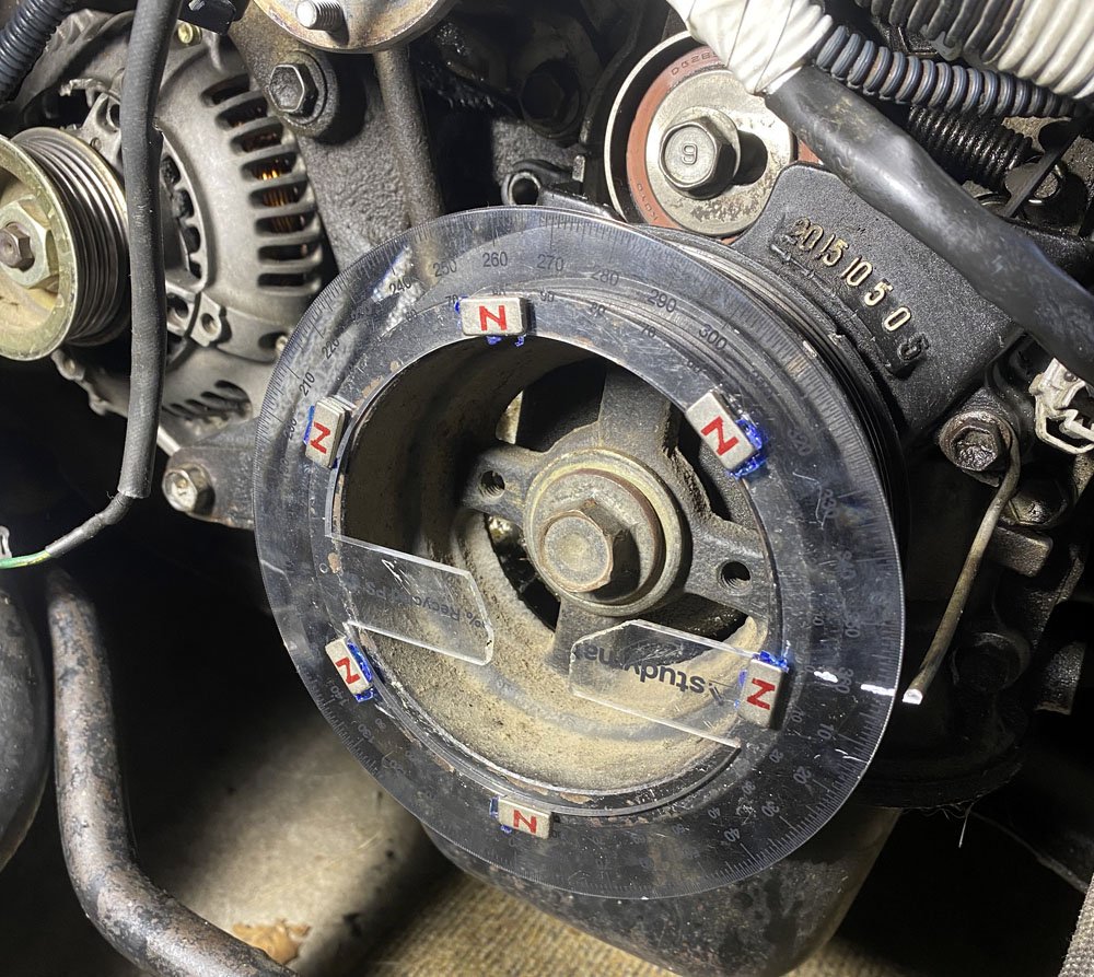

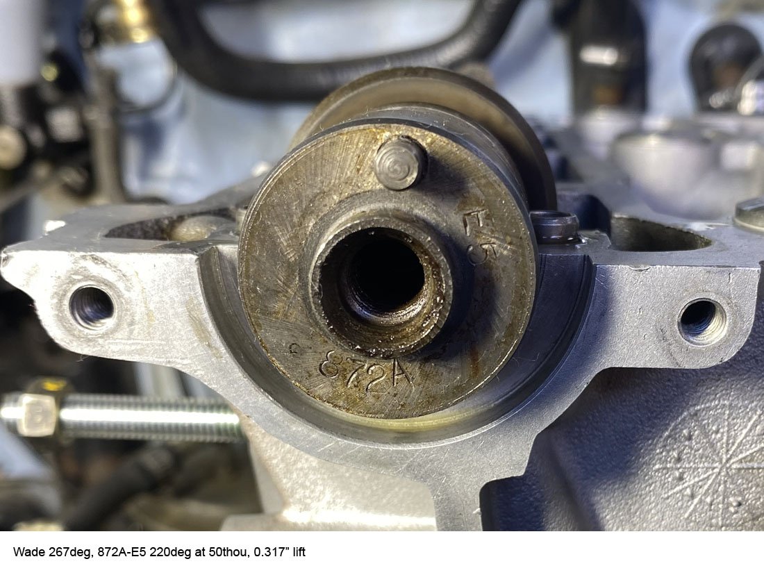

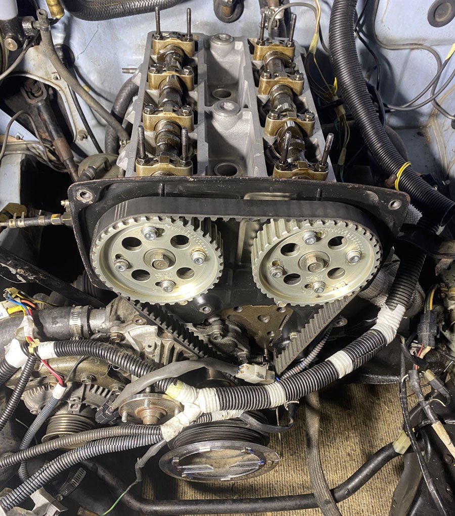

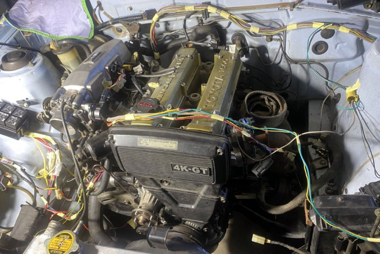

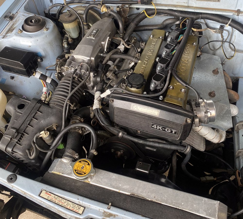

altezzaclub Posted June 14 Author Report Posted June 14 Well I re-set the timing a few weeks back, drove it around for the day and.. the next day it wouldn't start! Fooled around long enough to flatten the battery, tried to get the timing back where it was on the Haltech, then pulled the dizzy out and stripped it. Decided the VR reluctors from factory might be dodgy so spent a couple of days fitting Banjo's Hall Effect dizzy and the COPs kits, rewiring a bunch of stuff to do it. Of course it still wouldn't start, so I popped out to the workshop and borrowed a compression gauge. Two cyls were crap, so, off with its head! Everything inside was carboned up, and once I had the valves out you could see the gritty soot holding the valve off the seat. The head went off and got dipped, came back looking like new, and I have been slowly putting it back together. This time I did the cam timing quite carefully instead of relying on what it was. The cams are Wade 267deg grinds, nothing outrageous. I didn't spend the time re-making my old dial gauge mounts from Datsun 1600 days, with the cam shims you can simply stick a small screwdriver in the cut-out of the tappet lifter and if the valve is open, you can feel instantly when the cam lifts off and the lifter rotates. Same for when the valve is closed, as you rotate the cam you can rotate the lifter barrel back and forth until it suddenly jams as the cam lobe presses on it. The best buy was the $3 150mm protractor from Officeworks, and I had half a dozen strong little magnets from an ipad I took apart one time. With the head off the pistons come up just clear of the block slightly, so I could check piston travel from both directions just before TDC. Turns out TDC is not where the mark on the cam cover is, its 3deg before that. Not that it will make any difference to setting either cam timing or ignition timing! So they're set up opening at 22deg BTDC and closing 120deg BTDC, and vice versa. I've cleaned up odd things along the way as all the cold start stuff wasn't needed with the Haltech, and now the inlet system is on I'm looking at how close the extractors are to the starter motor. That Subaru fuel filter housing still does a great job as a surge tank! This week I hope to be back on the road! Quote
Banjo Posted June 16 Report Posted June 16 The head cleaned up nicely ! Still haven't quite worked out what the magnets are for, other than to actually attach the $3 360 degree protractor to the crankshaft pulley. Hope to hear that it fires up towards the end of this week. Will be really interested to learn what temperature the air gets up to down in the spark plug "valley" of the head, with the Mannon COP conversion mounting plate in place. Is there any way, a tube could be installed, that would naturally force O/S air through that well, & out the back end ? Cheers Banjo Quote

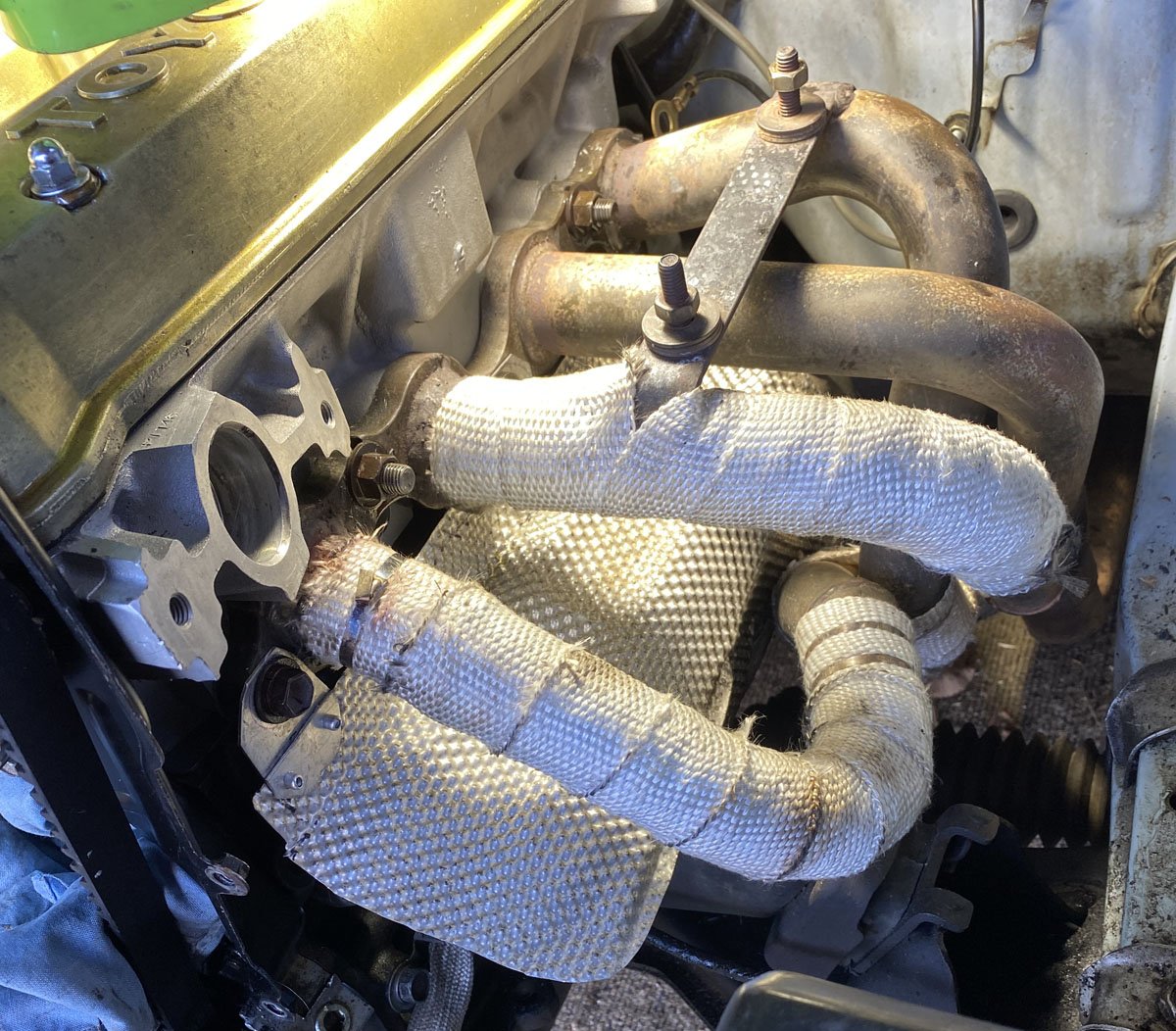

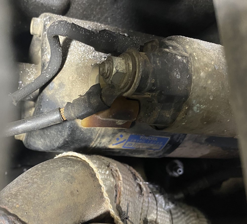

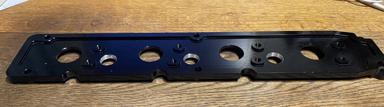

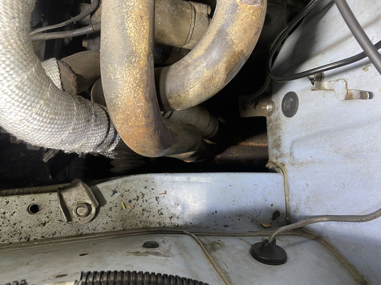

altezzaclub Posted June 16 Author Report Posted June 16 The magnets were for exactly that Banjo! Usually they bolt on to the crank nose. The starter was starting to get cooked from the lack of clearance to the extractors- So this morning's job was a lower heat shield- ..and the beautiful black-painted milled alloy valley cover met a step-drill for 3 extra holes.. I might start chasing airflow around the engine bay when its running, I can pull air in the side vent which runs inside the guard from beside the passenger's headlight to in front of the turret, taking cold air to the original 4K air filter. Its just awkward going across the engine bay to the valley cover. The starter solution will be to either fit an alloy spacer plate milled from 6mm to 4mm so it tilts the extractors towards the chassis rail, there's 25-30mm clearance there, or Josh reckons cut the pipes off the manifold plate and weld an extra 20mm of pipe in, its faster for him to do that. Electrics tomorrow, everyone's favourite! Quote

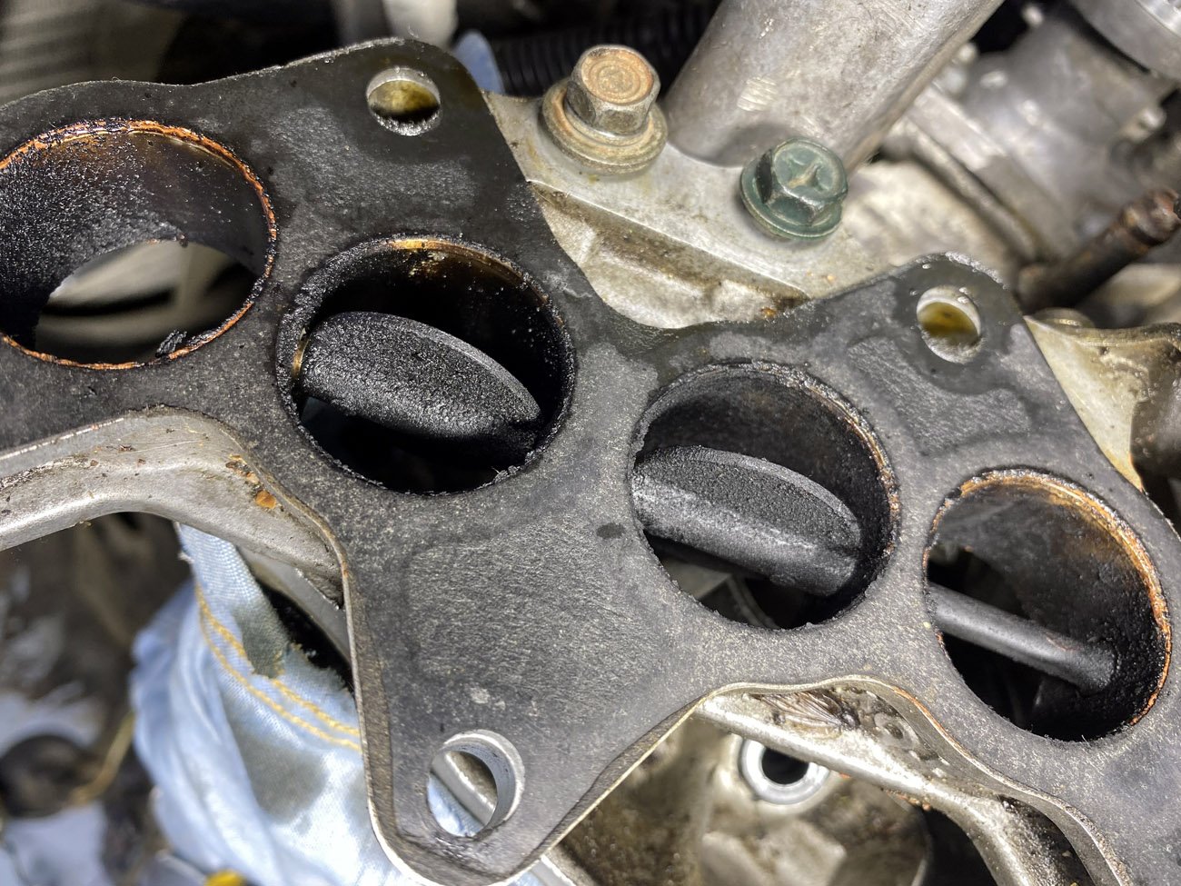

altezzaclub Posted July 6 Author Report Posted July 6 Well, back on the road and better than before.. I saw a clue here where the edges of the TVIS throttle plates are covered in carbon. The edges should be clean where they shut against the inlet runners. A year or two (or three..) back I had assigned a Haltech pin to open the TVIS and a light to indicate it was open, and I relied on that. Nope, this time I figured out a way to photograph the arm that works them, with a bit of white paint on the arm and floodlights under the car, and setting the Haltech to trigger them at 1100rpm.. They are activated by the diaphram, but away from the camera so you can't usually see the arm that moves them. They stayed open all the time, the default Toyota position with no vacuum on them. So I chased Haltech pinouts and found one that activated them correctly, and the car is much better low down! Between the cams, the lack of flywheel and the TVIS the car was running rich and poorly low down. It crossed my mind, fairly seriously, to get a second TVIS plate and move the throttles to the other ports, and run them off the throttle cable with a TPS on one end.. That would give me throttle control right by the head ports, 4 runners for low revs and eight for high revs, and maybe a better control of off-idle power, the 2-5% where you are driving around town. I got hold of Johndee and he suggested just disabling them first to get a base-line of performance while I find a second TVIS setup and engineer the change in throttle plates, and... ..if anyone has a TVIS system lying around I'd love to know! So that adventure has been caught up on, plus I have the COPs from Barry Manon fitted, and the Banjo distributor doesn't leak oil! Quote
