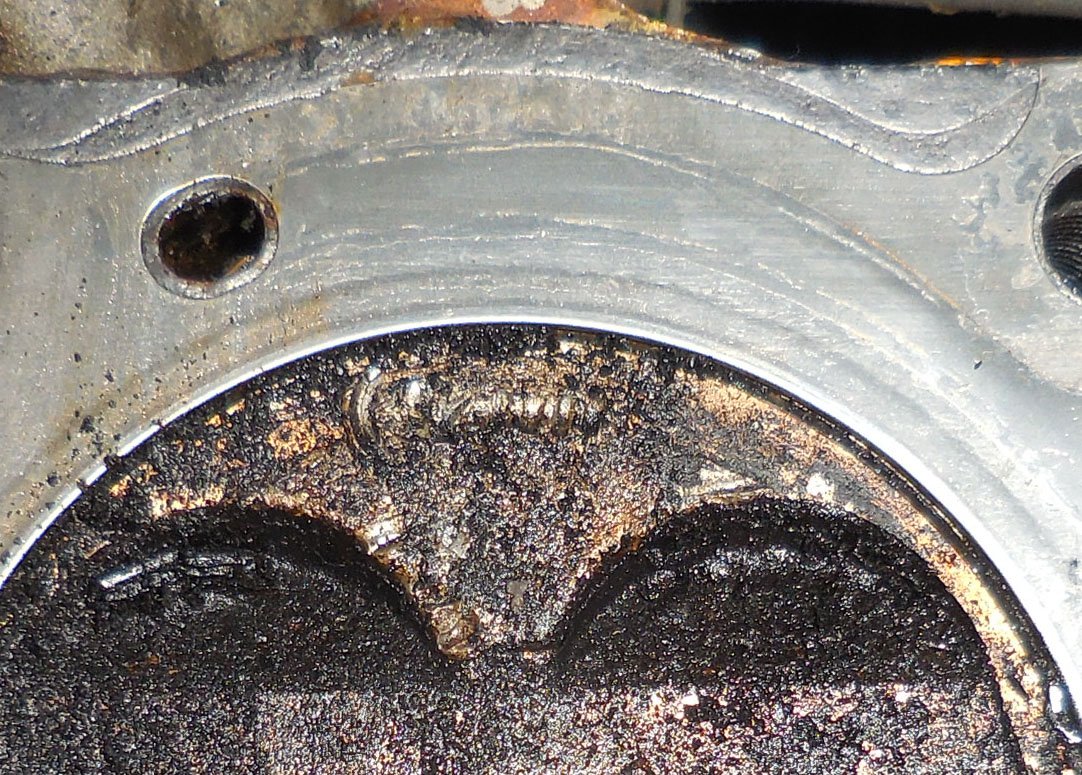

Steve to the rescue and we headed up to Walcha.  It was head off time, to find a perfect fossilised imprint of a phillips screw in the top of a piston-
One of those experiments with the idle speed had got out of the cage some months before, and the screw had popped in, got stuck beside a valve and on the next stroke jammed the valve and bent it!

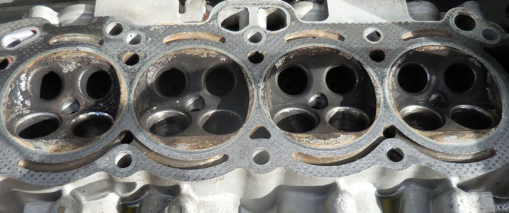

So, we did a compression test & they were all 90-100psi. To check the gauge we tested Mao's 4AGE & that is all 190-210! I took the head off and there is a lot of soft carbon on the piston tops. The bores look fine, no lip on the top and no vertical scouring to suggest broken rings.
The combustion chambers are the same-

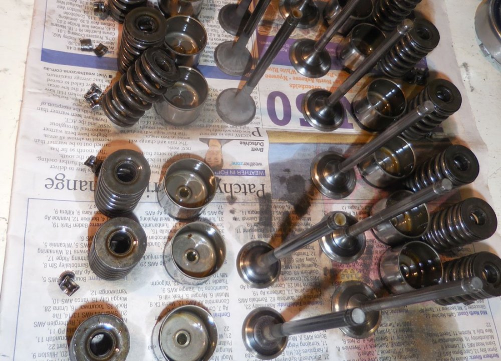

and once I pulled the valves out the loss of compression showed with carbon particles on the exhaust valve seats. The inlets I could've put straight back in they were so clean, but I gave them all a whizz with sandpaper and a quick grind.  I'll assemble it this weekend and buy a borescope to keep an eye on it for the next year. I was most impressed with aaapowerparts on Ebay, $113 bought me a full gasket set with new bolts!

Such even dramatic drop in compression almost leads me think about cam timing. You definitely had the cam belt and timing marks all lined up properly? 90 psi is terrible for any engine.
Edited by ke70dave
  • Like 2
Not a clue about the root cause.  The motor came out of a guy's race car, so it has the biggest cams you can fit without new valve springs, and I thought maybe they give a low compression at cranking speeds. Cam timing looked OK, I'll dig a up a photo in a moment. The catalytic converter was suspected, but that is as clean as a whistle. Those Mazda leads I wondered about, but their resistance is within the range of Toyota leads. Running rich..? I've got the mixture display in there and it is impressive how much time it spends on 14.7, leaning out going downhill. Maybe the oxy sensor is suspect. I'm loath to pull the bottom off and pop the pistons, given the bore condition and the rare times I add oil between changes, but the carbon is coming from somewhere.
