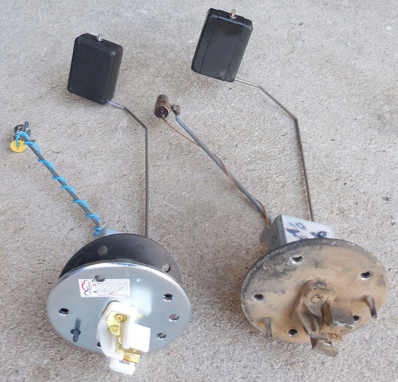

I fitted a new Ebay fuel sender unit as my modified red light didn't seem to work. or maybe it was too dim..  Anyway, the new red light came on at 1/4 full, so I bent the arm to make empty, 'Empty'.
...and naturally now when it is full it only shows half!  So there is a bit of work to do with those Ebay units to make them work!

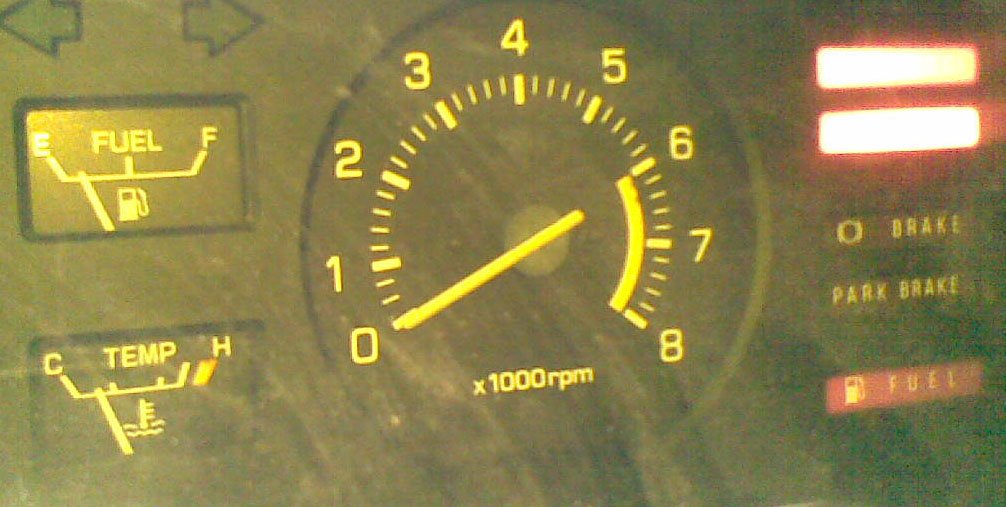

Today the light came on about 20km from home, and when I filled the tank it took 40L, so there was more than 10L left when the light came on.

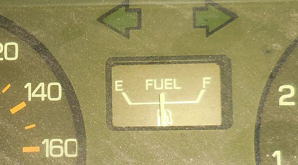

Well, the new sender unit just doesn't want to show how much fuel is in the tank!
The red light came on just North of Wellington yesterday on the way home-   It was still a long way above 'empty' with the red light on, but I added 12L just in case...
and when I filled it today it goes up this far-
So they're no good!   At least I've got the red light, maybe I'll add that to the old stock sender unit.

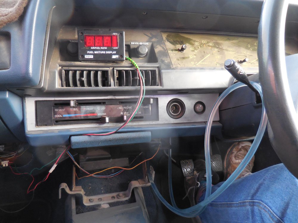

I figure fuel starvation as there are no error codes and so I have re-fit the mixture display, which shows it leaning out as it dies.  I look inside the tank in case the lift pump has dropped off again, but its fine.  I take the fuel rail return line off an run it through the car with some clear hose. It never empties.
I start thinking the main pump may be dying from a bad relay in the COR setup, so put a wire from the battery direct to the pump, tucked away under the air filter...
and that's when I find one of the wires on the pump is not firmly on the terminal at all! I assume it was moving off under some acceleration or other, the motor dies and it falls back into place!
Having put it on firmly and seeing it do two days of running around, I hope that was the problem and the fix.  I've sold the Altezza and its one car each now!

Things improved when I put the mixture display back in and hooked it onto the oxy sensor wire. I'd taken it out to calibrate a mate's system and  ...found I never re-connected the oxy sensor to the ECU as I planned on putting the mixture display back on that afternoon, and didn't!  Its better now it doesn't have to run on the ECU map in open loop, and of course when I took it back to the garage he talked about it but didn't try it!

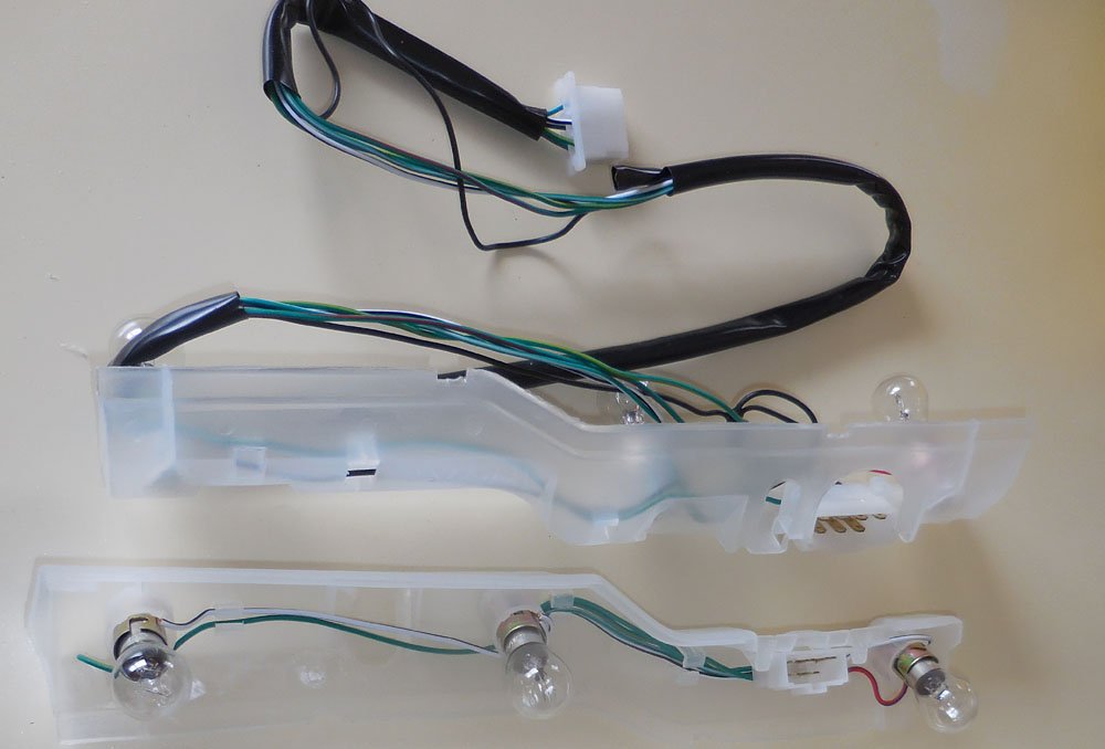

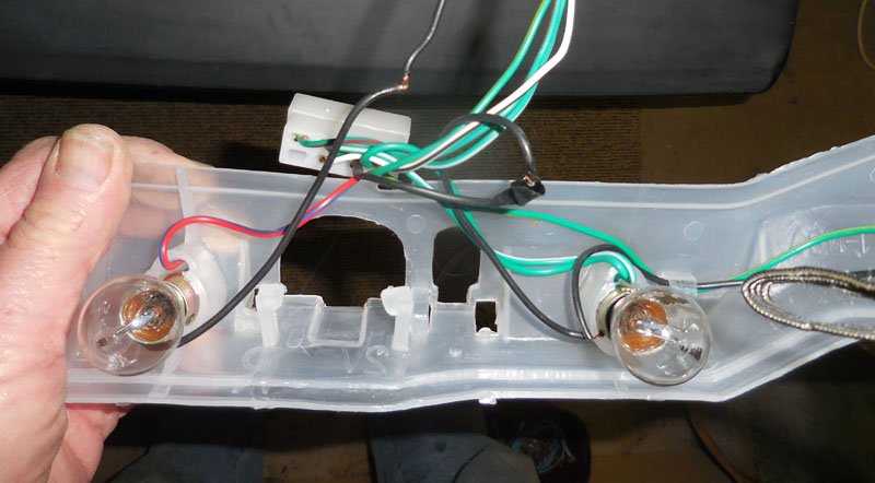

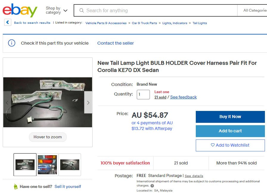

I spent a stack of hours chasing bulb holders to mount on an aluminium sheet and replace the rotted plastic ones in the tail lights.. Then I came across these-
I ordered a set last Sunday, and amazingly they were here Saturday morning.

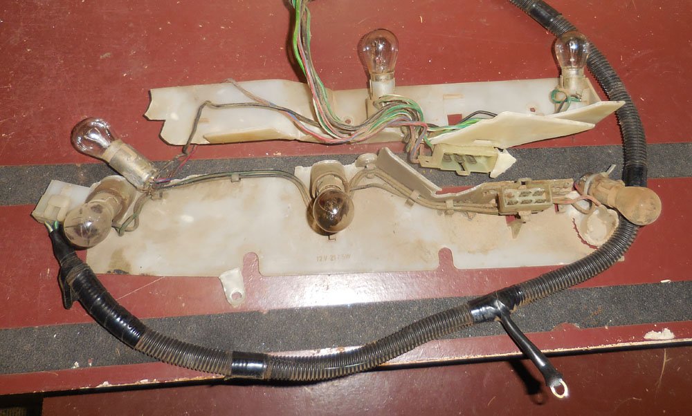

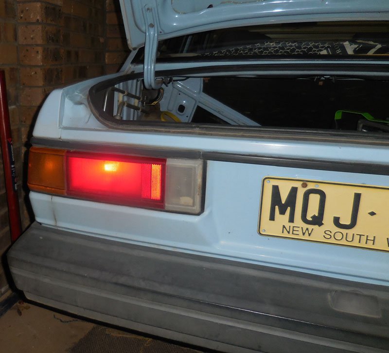

I was pretty excited to plug them and replace these ones-

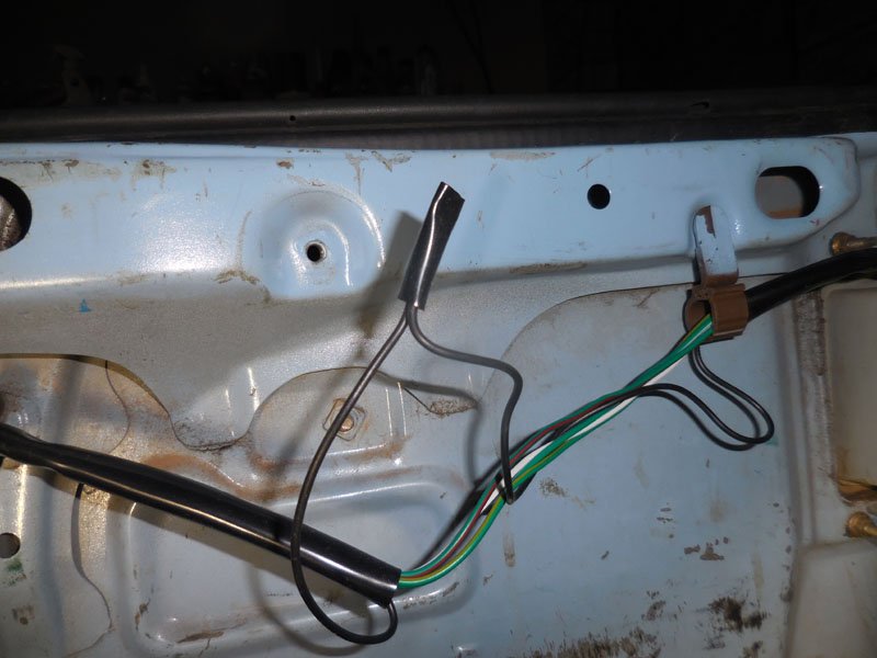

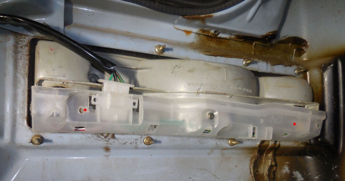

Then I noticed the earth had come apart here, and actually they were just twisted wires with some tape around them and the bulb earths are just the bare wires pushed down the side of the bulb.  Mine are all soldered-.
When I went to put them in I found the earth tag in the middle of the boot didn't exist.
..and of course they didn't fit at all!  The screws are all in the wrong place, although the middle one will do, and they strain to fit at the edges. "Sealing" just doesn't enter into it!
When I plugged them in the left hand indicator was the brake light flashing, the brake light was the reverse light and there wasn't a reverse light..
It was easiest to pull all their wiring and bulbs out and put all the old gear into their plastic cases.  CBF drilling new holes tonight, I'll finish it tomorrow. At least the lights all work as they should-
So, all in all, $55... not too expensive, but the quality is cheap, the assembly work cheaper and its not designed for our cars anyway!!  If they flogged the plastic cases by themselves for $15 it would be a better buy!

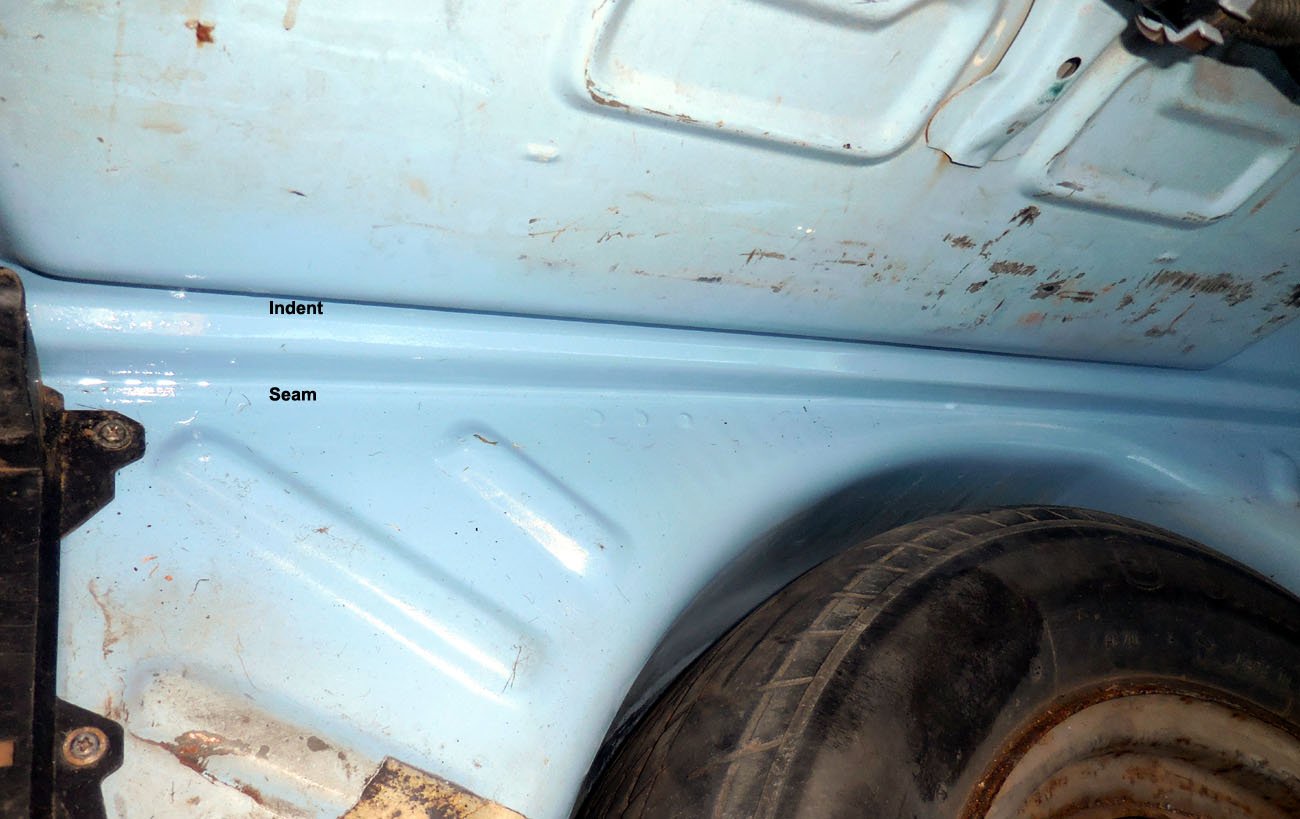

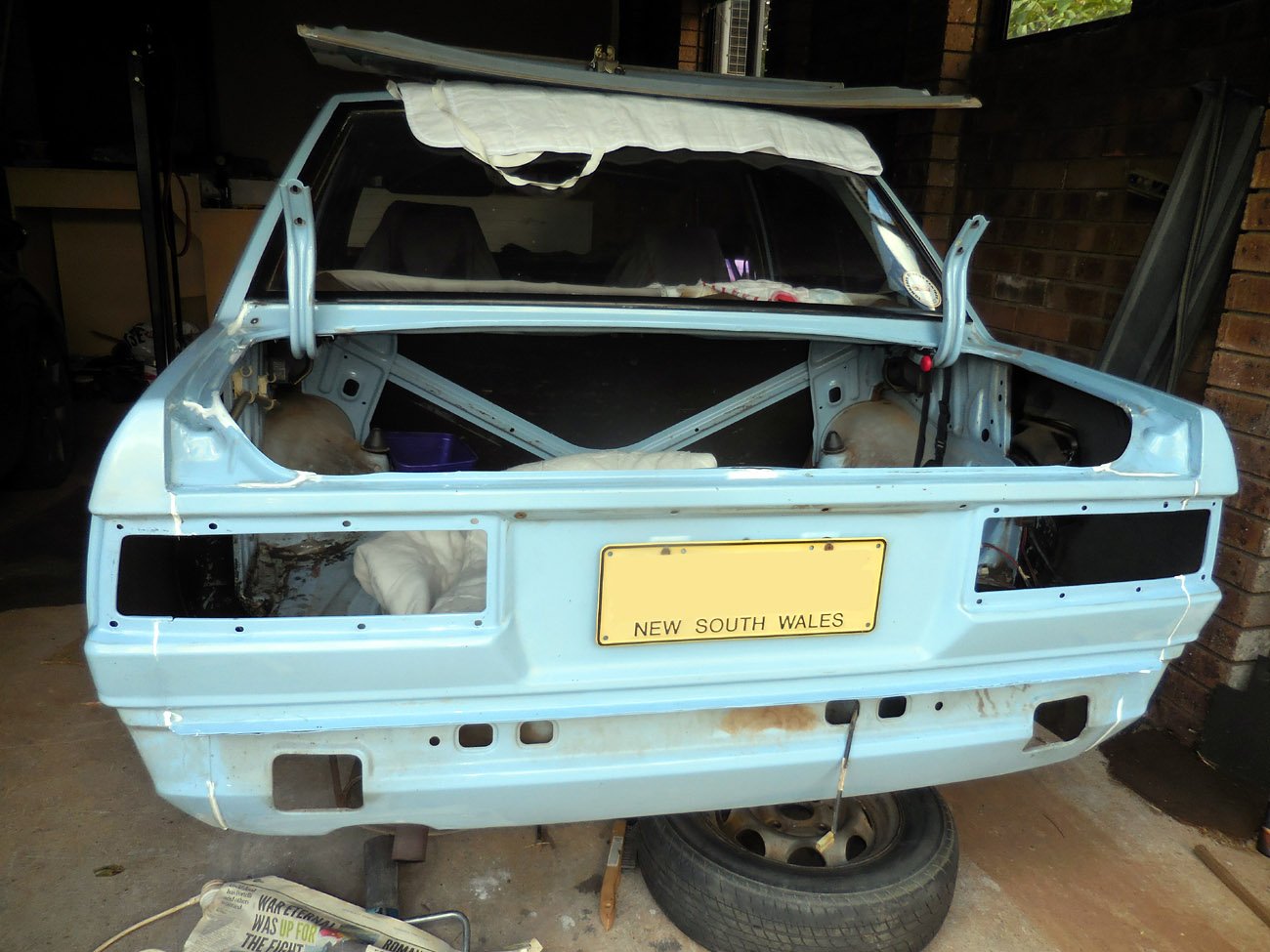

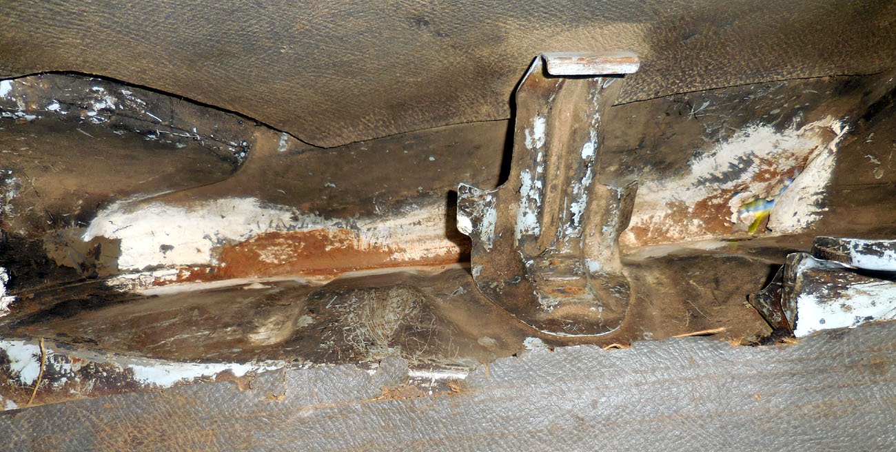

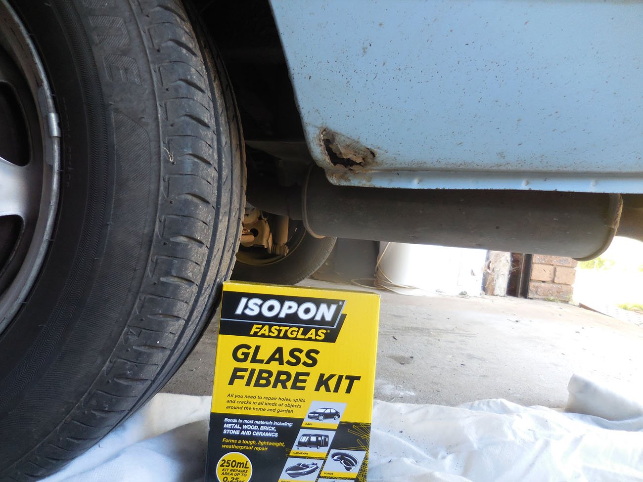

Well, another couple of years of running around..  I was doing the annual polish when I came across a rust hole in the bottom of the rear guard on the nav side..  I'd seen it last Xmas when doing the same & thought 'I must get onto that', and put a bit of tape over it..
Inside I'd painted it with some white enamel just to stop it rusting more, so this time that was all wire brushed, treated with phosphoric acid and then a coat of a high-zinc enamel.1076437570_Xmas...B.thumb.jpg.ed9fd530f9fa40eb7039d7bb8f8e1d83.jpg
Doing that made me paranoid enough to look at every seam very carefully, and any crack in the paint meant the factory sealer was dug out and new seam sealer applied.
Then it as all undercoated and a can of aerosol colour finished it. Down in both side wells and across the back..
Next will be cleaning under the rear guards and re-spraying with some tarry underbody sealer, hopefully to make it last another decade or two.
