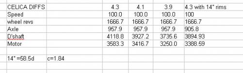

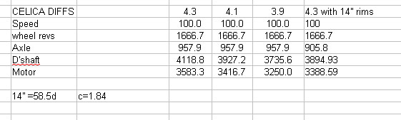

I was wondering if the 4K would pull a 3.9, so I figured out the theoretical revs at 100kph on the stock 13" rims for each diff, then added the 14" rims I'd used up to Cairns and back. It showed the 14" rims gear it up more than a 4.1 diff does, as I'd checked before, and the extra 140rpm drop at 100kph shouldn't be a problem with a 3.9.
So I can run a 3.9diff on 13" rims and cruise at 3250 instead of 3580rpm. So any hill will mean 5th to 4th pretty quickly as the revs hit 3000rpm.

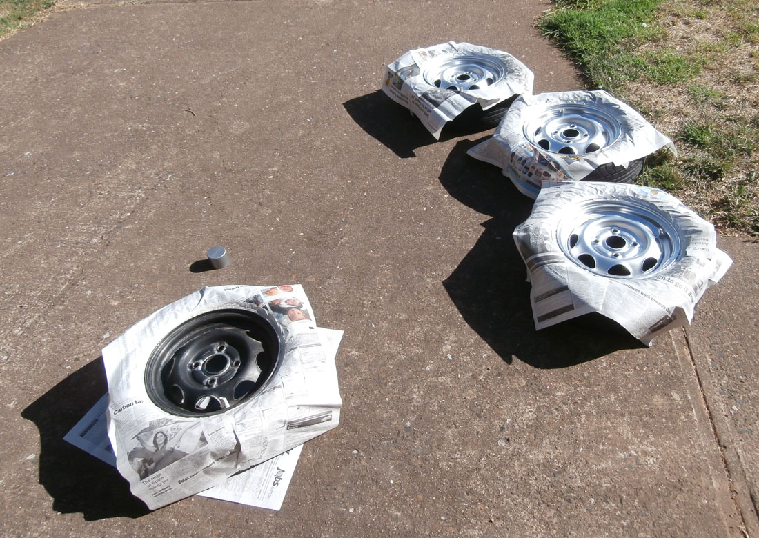

So... Repco had 3cans of spraypaint for $5 and there was one simple job we had never tidied up...
but the end result it worth it. Cops never stop a car on stockies!

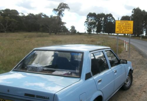

Well, almost the same trip, work needed in Walcha on the rally car, bro in Coolies, leaking water tank in Kingaroy, so a 6am start (its still dark then, do you know!) and we were grafting on the rally car 6.5hours later, 550km away. Misty through the mountains around Kandos, but magic driving. Next day up to Coolangatta through the mountains again, and this time I stopped to get the road sign.. 65km of narrow winding tarmac with corners down to 25kph! ..and that's just one stretch between Armidale and Grafton!
The day after was somewhat more civilised, and the day following going back from Kingaroy, but both times we managed to find some little-used back roads. The final run was 1050km from Coolies to Orange on Easter Thursday, so I gave the twisties a miss and took the inland route through Gulgong. Back roads with no traffic (or cops!) but they are open, fast ones. Just over 12hrs, which makes a long day in the driver's seat.
