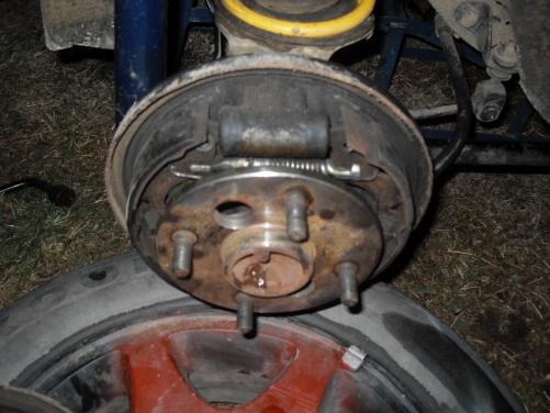

undo the nuts holding the axel in place ,get a slide hammer and attach it to the axel stud and pull.... some times there stuck or stuborn,
if you don't have a slide hammer could try a chain attached to a car ,to give it a yank ,bit dodgy, id try the slide hammer option first,

Once those 4x bolts are removed, put the wheel back on. Put 2x wheels nuts on just a little bit so the wheel can slide back and forward on the studs...... and you just made a slide hammer. Give the wheel a good tug and axle should pop out. I normally use a drum like this....
i dident need any of that stuff to get the axels out as soon as i undid the last of the x4 nuts i pulld ligtly and thay both slid str8 out lol
