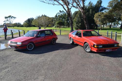

78_7kRolla Posted June 28, 2011 Author Report Share Posted June 28, 2011 Ok, so I haven't updated this thread for while but there has been plenty of progress lately. Fixed back race seat is in but I still need to make adjustments to it regarding height and theWhiteline adjustable blade rear swaybar is now in and is SOOO good :) Recently I fixed the bits of rust that were in the typical AE82 spot on the back of the rear wheel arches. Also cleaned up a bit at the back where the bumper was rubbing through the paint. Also at this time I partly stripped out the interior by removing most of the rear panels, carpets, seat and seat belts. Also fitted my custom springs (4.5kg/mm rate all around) on some new KYB struts. After some mucking around to make the springs captive and a wheel alignment I headed out with a mate for some quick snaps. Also have a set of Genie primary and secondary extractors waiting to go on, and a basic roll cage to follow soon. Watch this space! Rust! 1st round of bog after grinding Cleaned up rear Undercoated Stripping the interior Brakes Springs and semi slicks back on! I'm extremely happy with the way it has come up and will be hitting the track for the first time next month. Can't wait! Matt. Quote Link to comment Share on other sites More sharing options...
