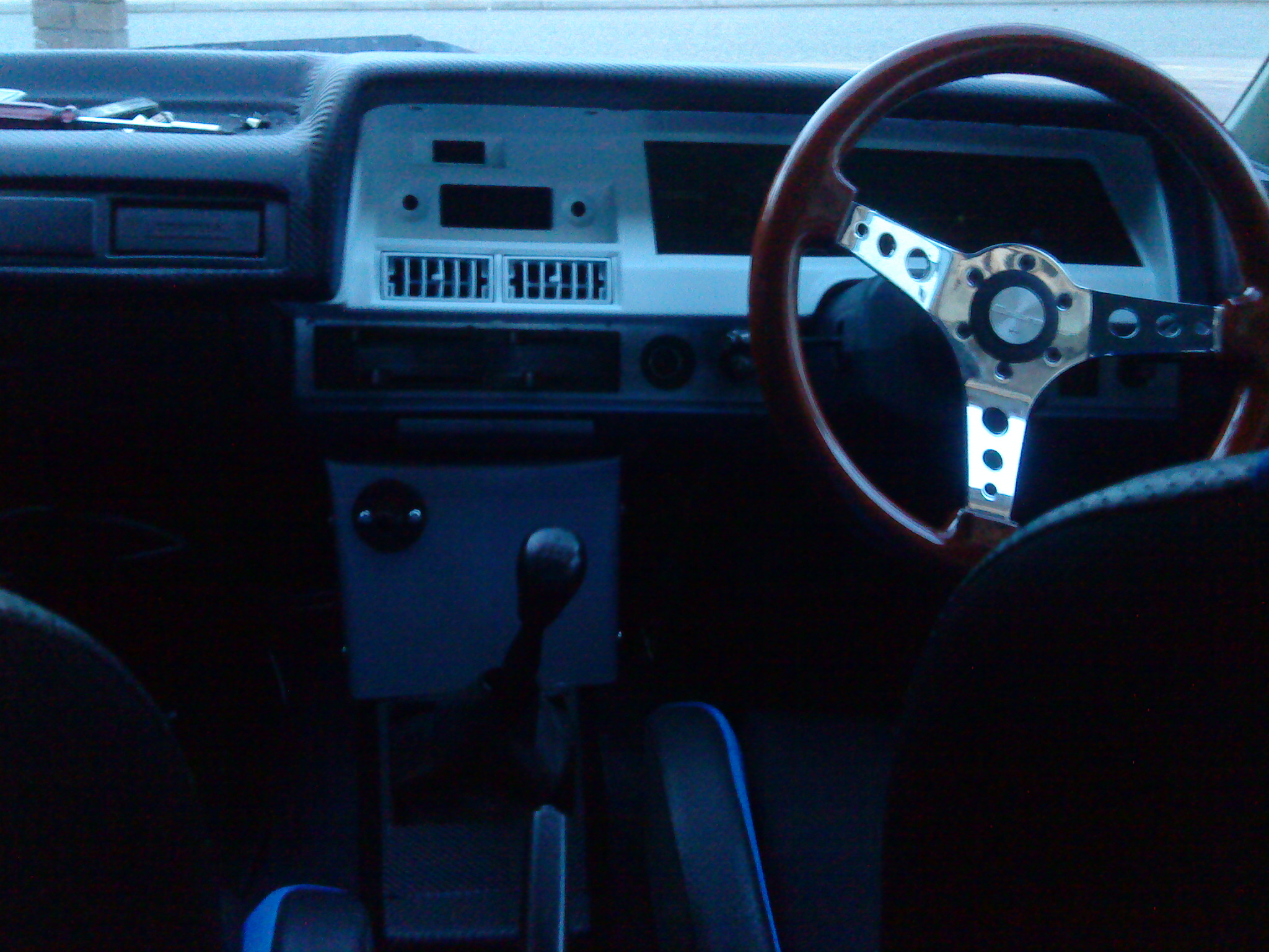

If you put a faggy dildo shifter in this awesome car I will fly to Perth and punch you in the testicles. Get a tasteful one for the love of god. Please.
It's your decision but imagine a nice leather bound one that's comfy and doesn't make your car interior look like a cheap strip club.
