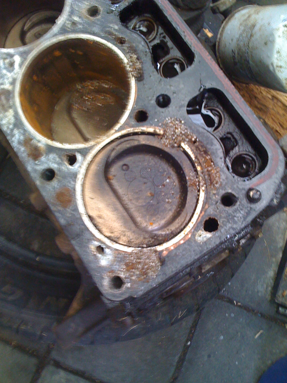

Hmm. Had a look at my 5k today, Started to spin the crankshaft and it only spins 180 degrees and stops :/
I'm wondering if it's 180 out and piston is tapping the valves.. I hope not :/

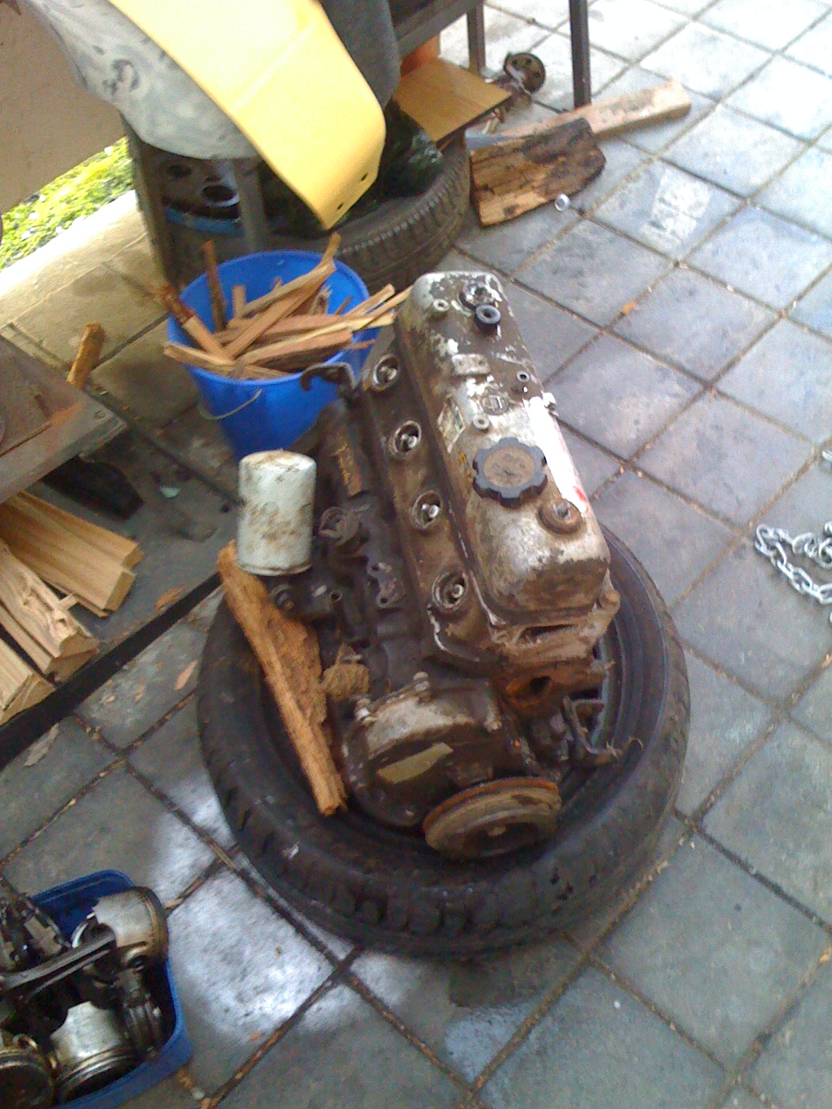

And now it's raining so, 1: I can't finish the bodywork i did yesterday, 2: I can't get the head off the engine to see what's wrong with it and 3: I can't work on the celica :/

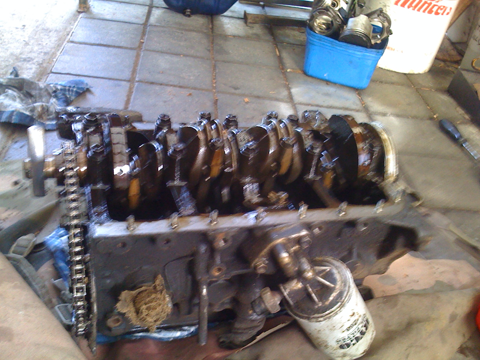

5k's all stripped down. It worried me that even with the head off the block would still not spin more than 180 degrees
So i pulled the off, and out came this shit?
Basically like beach sand/ rocks.. Thinking it might be some stop leak crap or something as it was all in the water system
Turns out, there was water in one cylinder which had rusted the rings and virtually siezed one of the pistons. (number 3)
So entire rebuild is now on, block is being honed, 32/36 weber being bought + extractors to have a decent n/a motor while i source the turbo and efi gear
