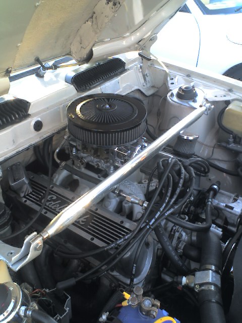

Ha, a 308 fits nicely and it is wider then a chev so I don't know why you need to shoehorn them.
Trev
Nice LJ, and good fit-up.
How did you go with the rack clearance ?
And Hey whats to go like ?
Andy
Trev
Andy
Not mine, it is my brothers, was just storing it at my house.
Rack clearance is fine, has also had the column centred so you aren't sitting offset to the wheel, goes good for balanced 308, best time of 12.20 @ 116 with stockers and 60ft wheelspin but the bigger tyres are affecting the drive ratio so it is only managing a 12.40

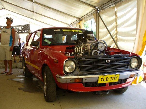

You can jam anything in there man. Just have faith and the willingness to lose your money, wife and sanity :yes:post-8046-039099400 1299017426_thumb.jpg
Below is a Ke20 with a small block in it one of the sweetest 20's I have seen not to mention heard. I say go for it!
Sorry bout the pics quality got caught by surprise with this 1 :dance:

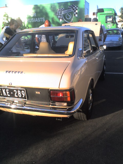

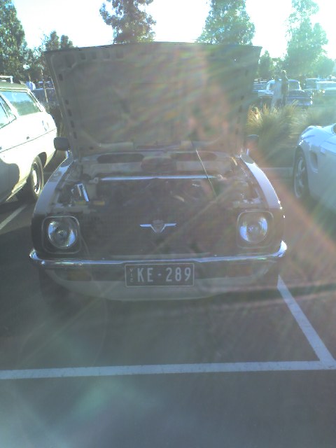

The KE20 pictured above actually has a 289ci ford windsor engine it,
a real nice fit and completely engineered. a few years ago went for a few laps
around sandown and it handled and stopped quite impressively.
A KE30 is quite a bit larger in the engine bay area and a small block
chev will fit, it will require a new trans tunnel and minor firewall mods
Have fun, just go for it
