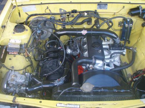

pol090_ke11 Posted March 9, 2011 Report Posted March 9, 2011 Hey guys I currently own a 1970 ke11 with a 7k I haven't had this engine in for long I was happy with the power increase for the first week but now I am chasing more power. I had in mind a full rebuild, balanced, head port and polished, larger valves and cam regrind, electronic dizzy and performance coil, twin webber carbys and match ported manifold, fuel pump and rising rate regulator, and a new exhaust system. I already have an electronic dizzy, set of extractors and a rising rate reg. Is this going to be worth my while or do I go supercharged and fuel injection? I don't particularly want to go down this path but if what i had in mind is not going to satisfy me it probably is. here are some pictures of the setup I'm currently running. Quote
mhmills Posted March 9, 2011 Report Posted March 9, 2011 That is one CLEAN engine bay! EFI, Superchargers and Turbos all help boost power, but all depends on how much you want it boosted and how much money you have to spend :P Quote
abbott Posted March 9, 2011 Report Posted March 9, 2011 (edited) thats is one of the cleanest engine bays ive ever seen! as far as engine goes i think it goes on personal preference, some people love a tough NA motor but other people love forced induction cars! i say go for your plans with the rebuild and then once thats done if your not happy then run the supercharger on it or just go supercharged if you just want the power quicker and easier! thats just my opinion though but theres plenty of people on here that can tell you the pros and cons. cheers tom Edited March 9, 2011 by abbott Quote
pol090_ke11 Posted March 9, 2011 Author Report Posted March 9, 2011 hey guys I'm glad you like it, and yeah I guess how you want to build your motor is up to the owner and of course the money. I'm leaning more towards a tuff NA engine as that way it will still look clean and tidy as there would only be another carby and some extra fuel lines and rising rate reg. How much power and revs do you think you could get out of a 7k with this kind of rebuild, I understand it wont rev as much as its little brothers. Quote
