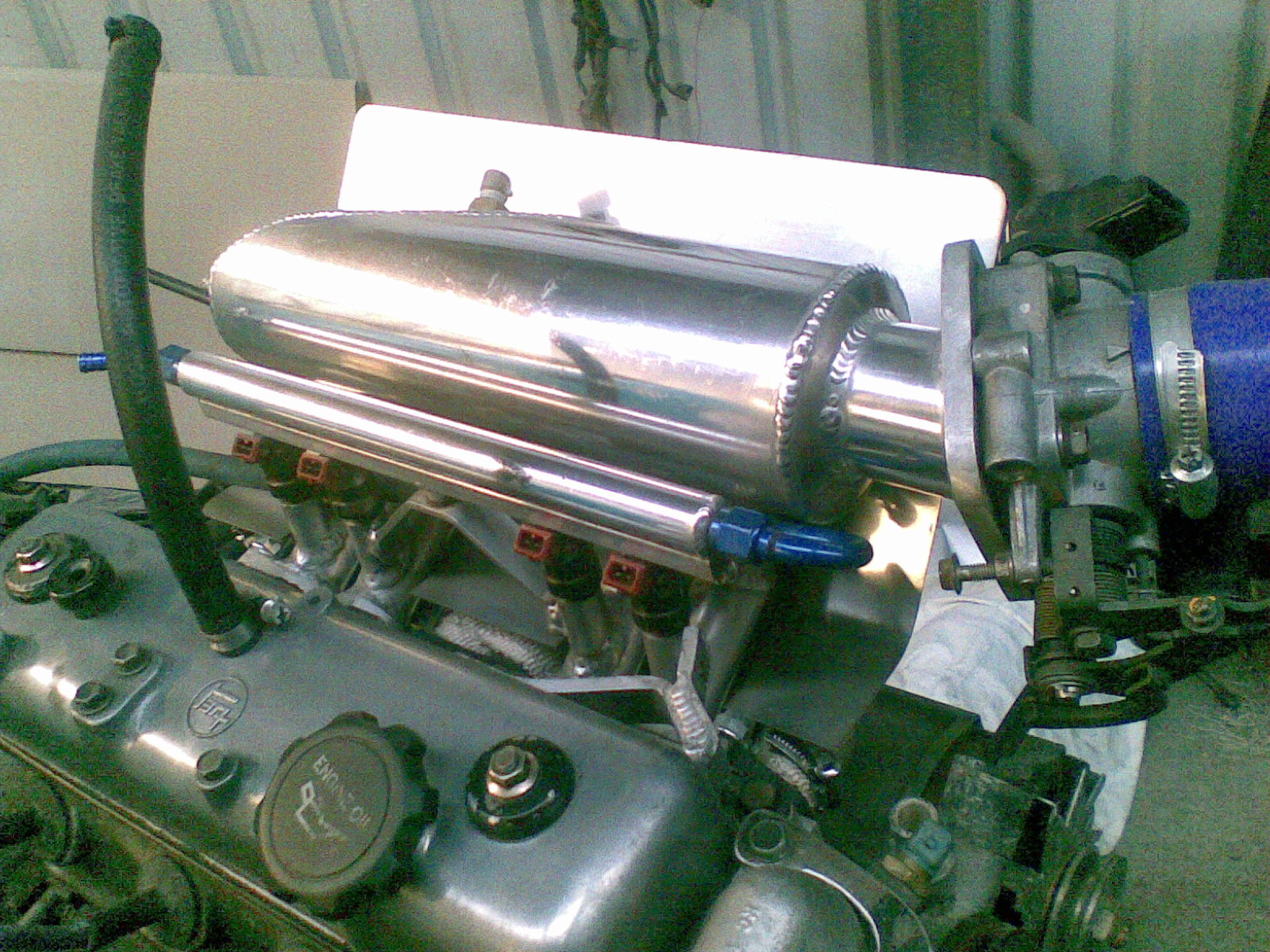

Hey 1jzke55 I have been doing some research and I am going to make my own plenum and inlet manifold and efi setup, with making my own I'm not sure what sensors I'm going to weld in to make it work if you could let me know how you had yours made that would be much appreciated, also what injectors would I need to use if I'm going to be running 8psi.
And with your fuel setup did you just use a better fuel pump or did you use a surge tank?
if your going efi you will be able to run more than 8psi if you intercool it up to 10psi on a standard motor
as for injectors anything 450cc and up we are using 550cc off a 13bt rota and there on 80 percent duty cycle at just over 7000rpm @ 22psi on a 5k almost too big
yes we used a 2L surge pot cheap lift pump from the tank to the surge pot then a 044 to supply the fuel which is over kill and you will need to put a return fuel line in as well
i strongly recommend buying your computer injectors throttle body and everything else you need before you start to make the plenum and inlet
here's a photo of the plenum setup on the 5k might give you some ideas
feel free to pm any other questions you have i'm more than happy to help ya out :)
