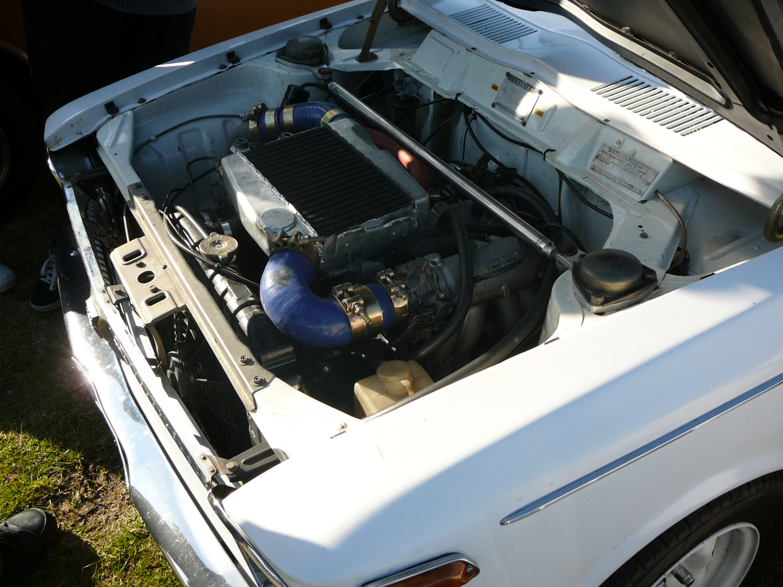

From memory that airbrushed ke10 convertable/roadster runs some sort of "t" series turbo setup. Don't think the owner is on here or toymods but I've seen the car on a couple of radrollaz cruise vids on YouTube might be lucky to catch a bay shot in one of them. Oh I think I have a photo or two of a ke-1x sprinter in the states with a 3t(single cam) turbo I'll see if I can spot any firewall mods on that and get back to ya.

homers ke17 (i think) 4agze set up
you will need a shoe horn!
Haha new it would fit. Didn't think the G head would make it that much bigger. Just gotta put all that cool s@$t hanging off that single cammer in that sprinter photo I sent you and that would be one psycotic ke-1x(that includes the gas).

post-8435-022221000 1301472851_thumb.jpgpost-8435-061665600 1301472827_thumb.jpg
Awesome car that sprinter and yeah it's homerske17.
Yeah man you've seen my car Evan. The 5k is even a tight fit.

And that's a 4agze :huh: It'll be tight!
post-8435-095512900 1301473471_thumb.jpgpost-8435-070008900 1301473494_thumb.jpgpost-8435-054327900 1301473424_thumb.jpg
TIGHT!

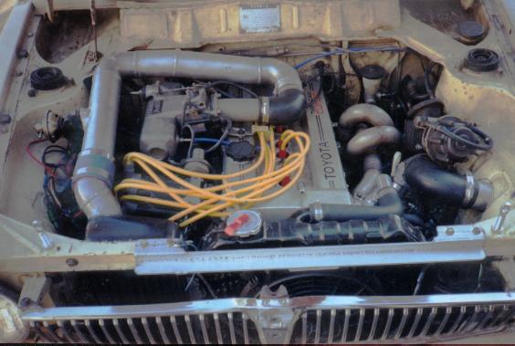

yet here's a 3tc with no firewall, trans or radiator mods?
