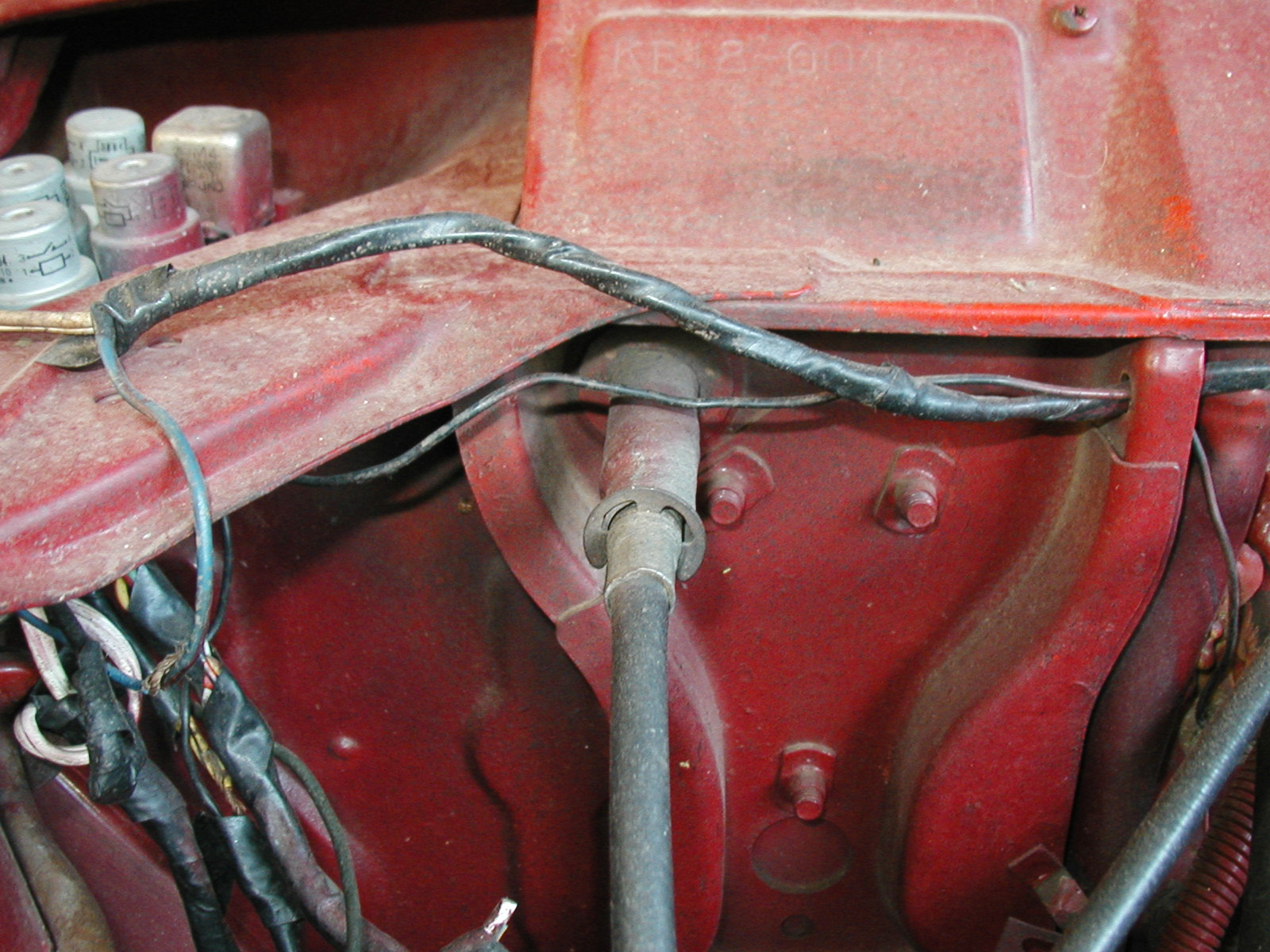

when i put the 4k and flywheel + k50 trans i had to make a spacer for the clutch cable
i made it out of some electrical conduit that i stretched using the handle of my ratchet
