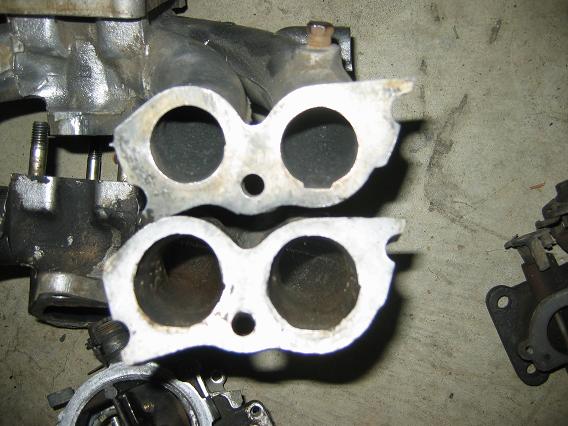

No, the main difference is in the inlet ports.
You buy the extractors for your make of Coroola, for the simple reason KE20 pipes won't fit on a 30 and vice versa.
You would either need to match port your inlet manifold, or find a big port one.

rocker posts ARE different, in that early 3k rockers have alloy posts, later 4k rockers have cast iron posts, but they both place the shaft in the same position, so the difference doesn't really matter. you could theoretically mix and match alloy/iron posts if you wanted to. the iron posts are the better to use, as they don't expand as much as the alloy ones under heat (hence making valve clearances unreliable)
extractors are dependant on vehicle, not engine/head. ke10/20 extractors won't fit a ke30/55 as the floorpan is different. likewise for ke70 extractors, which have a different floorpan again
ALL THIS ASIDE, 3k valve gear is shit and prone to leaking oil down the stems, and the older the head, the more likely it is to either have internal corrosion in the water jackets, or crack when placed under extreme running conditions (such as the extra heat of high compression). i would much rather just take your existing 4k head into an engine builder and get them to skim it for 50 or 60 bucks then bolt it back on
