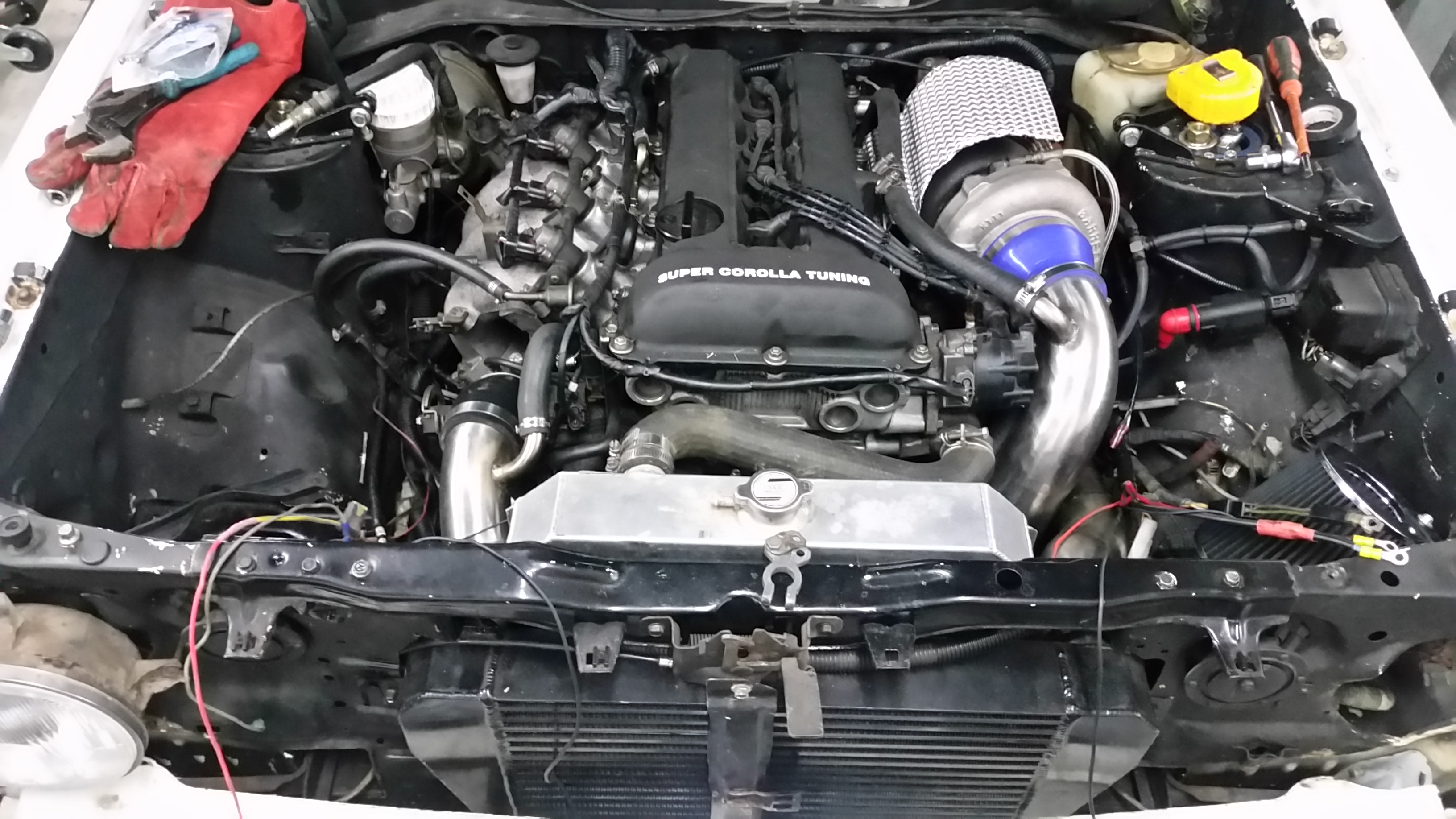

caibs Posted April 25, 2017 Author Report Share Posted April 25, 2017 faultless motoring since running the 12, but the clutch was a bit torched so finally thought it was time to replace it. while the motor was out to do the clutch i fitted a powertune twin scroll manifold with 2 38mm tial mvs gates topped with a gt3076. 82 rear the old intercooler piping was absolutely terrible. the guy i used was an apprentice fabricator. you can see ho he didnt have the right size tube for the iac so he just welded a nut on and rounded it off. i bought a welder a while back and have been teaching myself to tig stainless on my other car that I'm building. so i thought it was a good opportunity to make new pipework. spent the last week and a half making a bunch of stuff, first off i had to modify the dump and make new screamer pipes. it was quite tight getting a 3 inch dump and 2 x 1.5 inch screamers, ensuring there was as much distance to the idler arm as possible. got the dump wrapped in titanium heat wrap, came out very nice in the end. next was new 2.5" cooler piping and a 3" intake. the old intake setup consisted of a 90 degree bend, small pod and no bov so it suffered from reverberation stalling. basically when you jump off the throttle abruptly the air coming back thru the turbo causes the afm to get some hectic signals and it dumps fuel in and stalls. so to remedy this ive made the intake as long as possible with a few 90 degree bends and a 25mm bov port thats hidden and points towards the turbo/away from the z32 afm. on the plus side, air filter now sits behind the headlight. down side - gotta shift the battery. here you can see the bov port behind the intake throttlebody side piping, also with bov port hidden underneath. i have a turbosmart kompact plumb back to use, or if i want the zutututu ill just chuck a bung over the ports and you wont be able to see them. then made a new hardline to the heater core around the back of the motor as the rubber hose was looking tired. excuse the absolute mess next step is to replace the lower rad hose with stainless as its currently 2 hoses joined together. then shift the battery and neaten up the wiring because it bugs the shit out of me. after that it will be time to fire it up and go in for a tune. stock cams will limit the power, I'm guessing it will go 315 ish rwhp. i have also made a couple other things that i will post up once its out of the shed. Quote Link to comment Share on other sites More sharing options...

caibs Posted April 30, 2017 Author Report Share Posted April 30, 2017 (edited) cheers its nearly ready just got to finish tidying up the wiring and a few other small items to address before the tune on thursday. going to have to pull my finger out as i need to pop away for work for a night as well. i actually had a heavy dig through your thread of how much you had to modify the tunnel to fit the jatco in, as i hope to go auto in this at some point. i have one on the shelf with a 3000 stall and a b&m shifter Edited April 30, 2017 by caibs Quote Link to comment Share on other sites More sharing options...

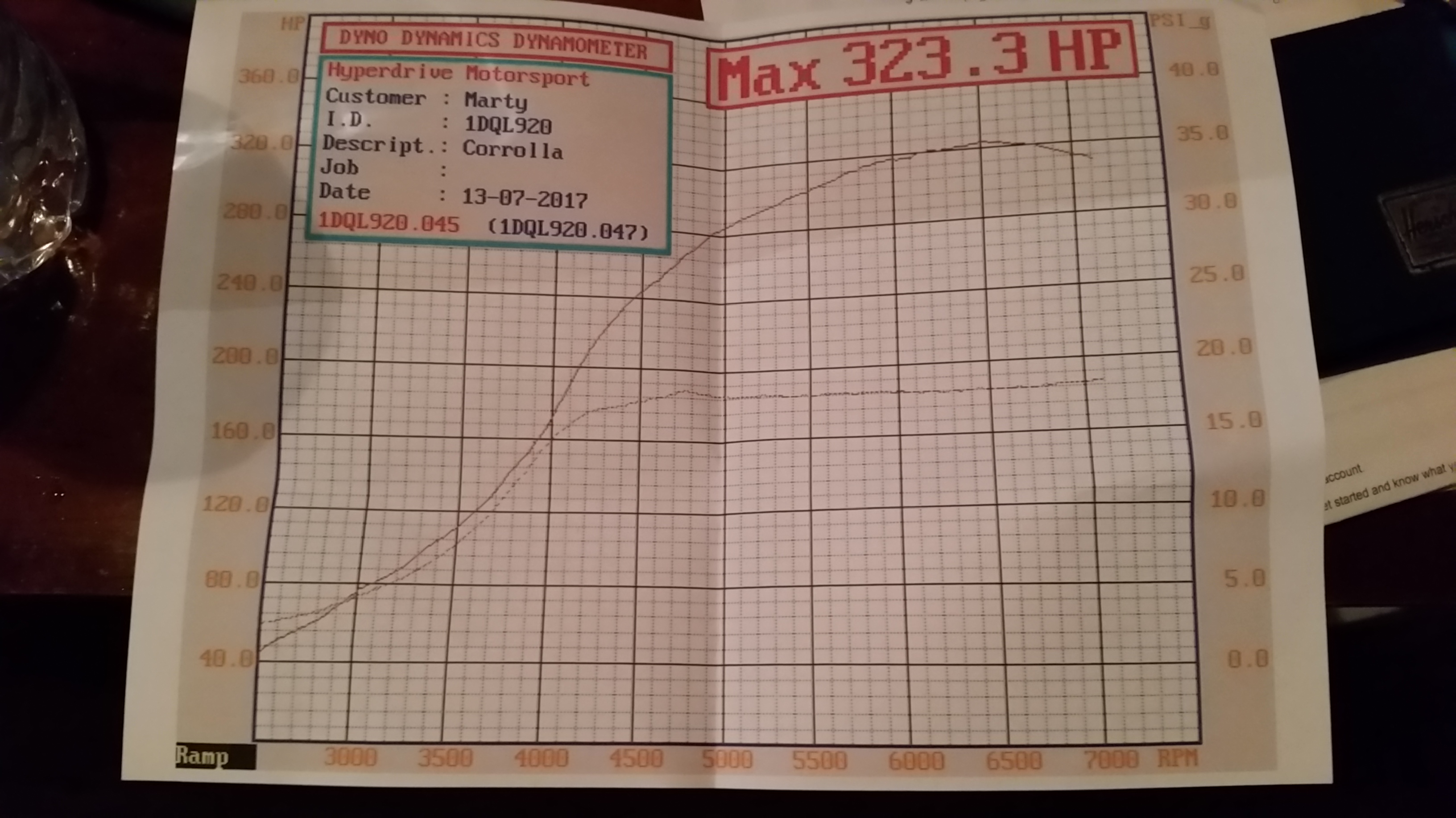

caibs Posted June 5, 2017 Author Report Share Posted June 5, 2017 thanks for the offer mate id love to go for a lap in it. unfortunately I'm in perth though. so it went on the dyno and fell on its face at 6000rpm. we think either soft valve springs or ignition is letting it down. so i got 270 degree camtechs performance valve springs crane hi6 and lx92 coil ported manifold with a 70mm throttlebody (free off a mate so i figured why not) motor and box came out again to fix a few leaks and do the manifold. now just need to put it all back together and get it back on the dyno. also going to coble together a catchcan. Quote Link to comment Share on other sites More sharing options...
oh what a nissan feeling! Posted June 14, 2017 Report Share Posted June 14, 2017 Valve springs is pretty likely, especially if the engine sounded OK when it fell on its face. Depending on the boost you are running usually seat pressure Is the issue. I had that problem with my car, it was really hard to find springs that aren't mega overkill, mazworks for example had springs that were more than twice the pressure at full lift than what was required. I ended up with performance springs as well as they offered a set that was spot on what i was chasing. Quote Link to comment Share on other sites More sharing options...
caibs Posted July 9, 2017 Author Report Share Posted July 9, 2017 well I'm glad youre happy with your performance springs as thats what i have got now haha! so now its running and ready to go for a tune. as long as i can get work off this week its all booked in and good to go. compression tested and came up sweeeet at 155psi across the board when at running temp Quote Link to comment Share on other sites More sharing options...
caibs Posted July 13, 2017 Author Report Share Posted July 13, 2017 didnt quite make as much as i thought but 54rwhp over last time should still be noticeable. idle sounds cool too Quote Link to comment Share on other sites More sharing options...
