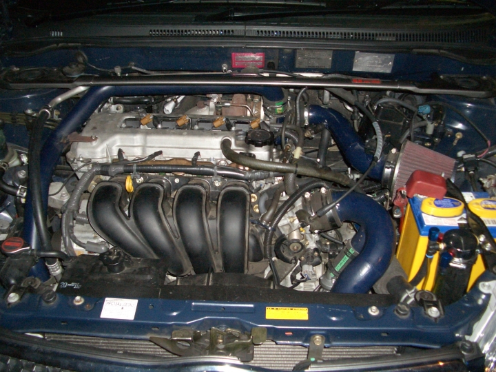

December 19, 200520 yr comment_90270 heres one i fitted for a friend, its in a zze123 corolla levin. the turbo's a td04 wrx run through a front mount intercooler & running a e-manage computer. it got dyno at 230hp at the wheels at 10psi boost with no engine work done. the only thing i would change is the computa for a Link or Motec or something like that as we had alot or problems getting e-manage to work with the toyota computa Report
