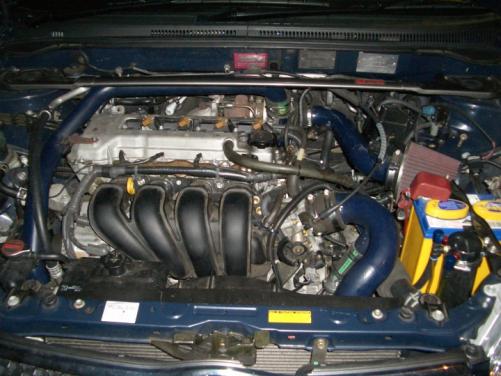

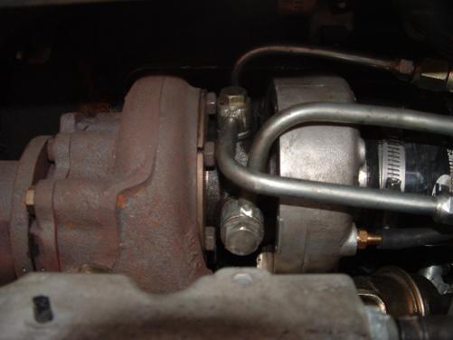

heheh, I guess inline with the thread dig, I'll post some pics of the conversion I finished.
It's using an MY08 WRX TD04L on a merge collector manifold, st215 injectors, walbro, 6-speed with LSD, XR6 turbo cooler and Vipec V44 ECU with gear based boost control. Has been running for 40,000km now turbocharged, makes for an awesome daily driver. It was running a MR-S powerfc initially before installing the v44 in 2009

Turbo/dump/heatshield:
http://www.simplyeservices.com/1zz/project41.jpg
Installed:
http://www.simplyeservices.com/1zz/project56.jpg
http://www.simplyeservices.com/1zz/project58.jpg
