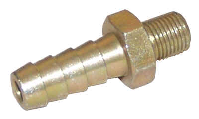

Unsrew the fuel line fitting from the fuel pump. Chop your fuel line a few inches short of your carby. Then screw a barbed fitting into your fuel pump. *shown in the picture*. Clamp some fuel line to the fitting and then clamp the other end to the existing metal fuel line on your carby.
