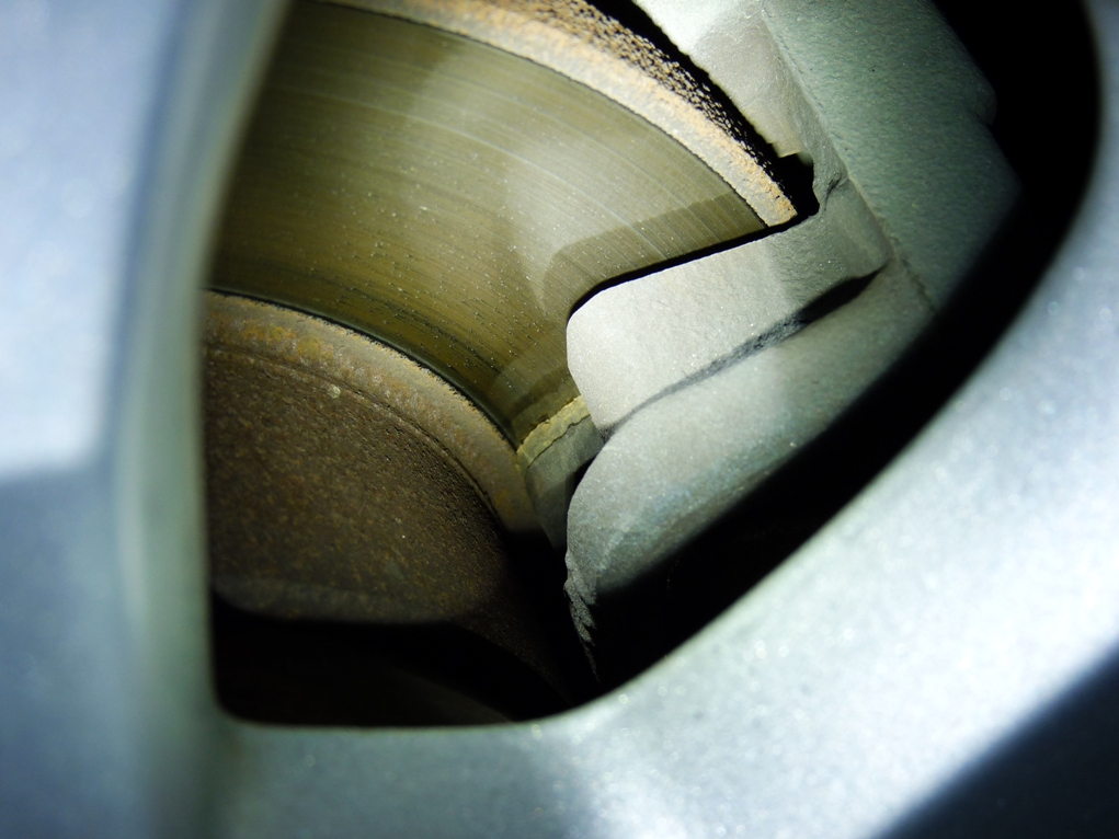

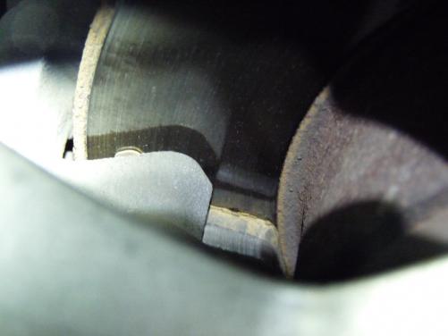

Photos:
P1580857 & P1580858 Front right
P1580859 - Front left
P1580862 - Rear right <-- I think it's this one
P158065 - Rear left

on the last pic its looks like the disc is slightly glazed on the inside edge?
I think it could be that brake that's causing the sound too... how do I stop glazing?... stuck caliper?

have a look on the otherside, see if its slightly glazed aswell.
does your handbrake work off the caliper or is it a drumbrake inside the disc brake?

Question what is that Metal clip thing touching the rotor?
(What ever it is, I bent it back to see if it was the culpret but it wasn't)
