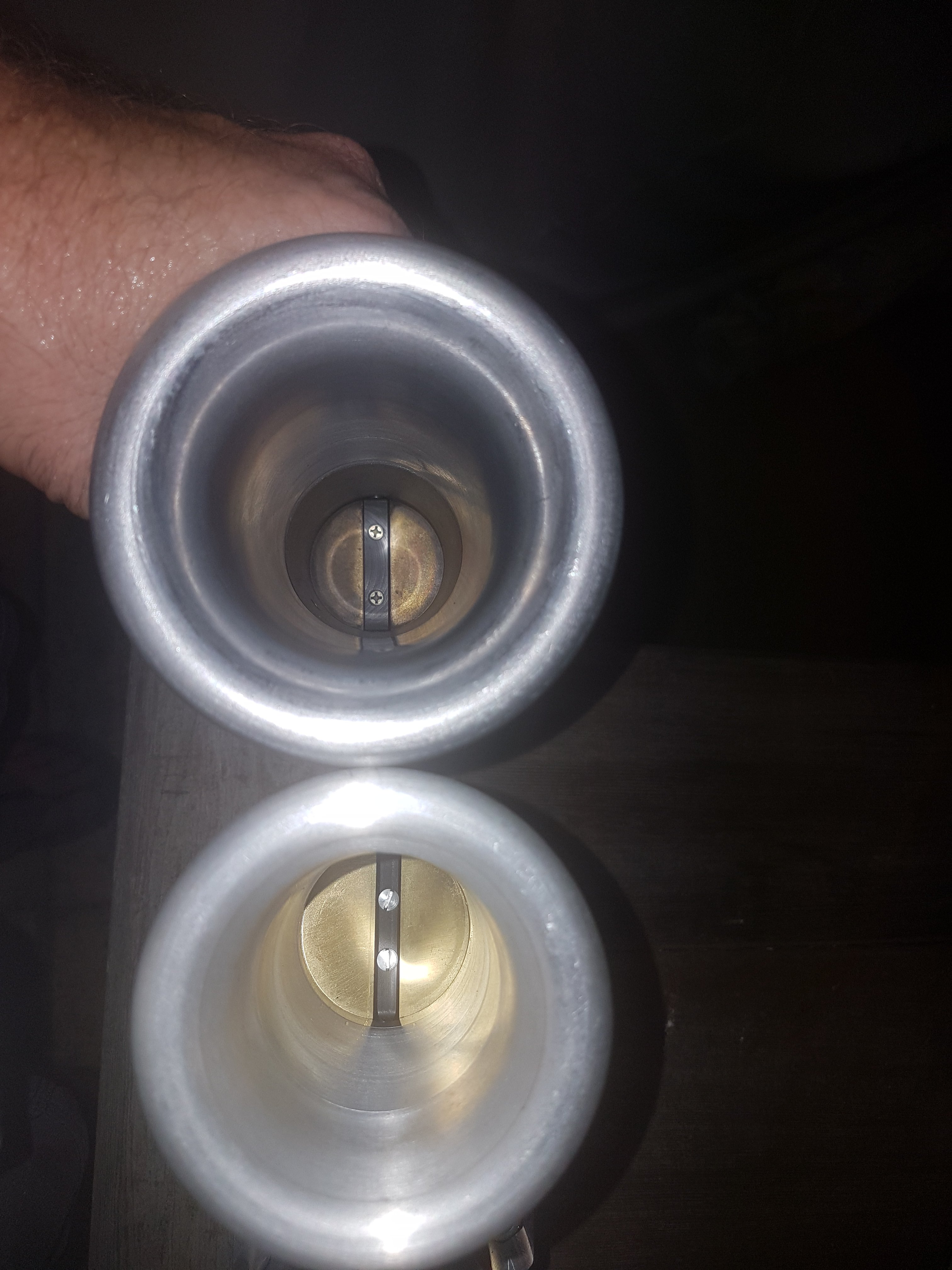

So this is off the road at the moment still.
Waiting for the machinist to make the throttle adaptors for me.  Then we will have improved breathing and hopefully more top end.
I'm on the hunt for 8x identical oem Denso 1nzfe injectors from a Yaris for the upstream injection.
Also looking for a fuel rail setup to make it twin rail on 97mm spaced injectors, I think sr20 is real close, but I'm not sure if close enough, I would love it if it was cause you can get a good rail for 45 au from china.
Have a quick shifter to put in now also.
Considering what I can put the silvertop itbs on which are now spare...
China ebay seller messaged back with dimensions, seems like its 97mmor thereabouts between injectors on the sr20 so I can use the 45 dollar rail.  Now I just need to find 8 injectors from 1nzfe part number 23209 21040.
Then hopefully I can play with it this weekend and get it running with the 48mm itbs.
Went and saw it yesterday.  CNC is the best.  The ports look amazing, I have a 30mm thick adaptor that gives room and adaptability for days.  My trumpets are made up of a spacer that's 80mm long, and a trumpet thats 50mm long, so I can experiment with the position of the butterflies and see how it goes in either position because the itb bolts to either the adaptor or the spacers depending on how you decide to set it up.  The 80mm spacer might be the business for top end with the extra time for fuel to mix, might be able to get a fair amount more air in and fuel to match, so that should equal some power in theory.
I have designed the plate so that the ports transition from 48mm to 45mm then I can port match the manifold top to transition smoothly from the 43mm it currently is to the 45mm that matches the adaptors cnc port.  Its also oringed on the base of the adaptor plate and the throttles have o rings either side, and the manifold to head union has the factory Toyota o ring seal, so everything in the inlet will be oringed.
Hopefully put pics up in the next day or two.
Compared to the old intake this has the butterfly farther away from the head, upstream injection, and its o-ring sealed either side of the throttle body and underneath the adapter plate also.
You can see the step down inside the ports where the cnc adaptor meets the inlet manifold, I need to do some port matching there.

I might swing past a wrecker today and try to find some injectors for the second rail.
I was talking with the guy who makes the itbs, Rama, Yesterday, and he was saying they tested an LS1 by moving the itb up to the top of the linlet on 80mm spacers and got 4 percent power increase from the movement alone and that it ran on just the upstream injectors fine for idle and general low rpm work.
I like the sound of that and I will probably end up installing mine up stream as far as possible and try to take as much advantage from the injector location as possible.
I just ordered the Orings I need for the adapter plate, and some clamp style trumpet bases from Rama so i can trim some of my spun trumpets and install them and not buy new ones to get a bigger bellmouth effect.
Also the machinist made me 4 x injector Bungs on a 24 hours turn around so I could try and put it together this weekend and see how it all fits.

I just ordered 8 identical new Denso Yaris Injectors.  Pretty cheap at 66 US a set plus shipping, under 200 AU for 8 new injectors shipped.  You couldn't have old ones cleaned for that much these days and afford to buy the injector as well.
So I will have to work out the wiring as well, when I get the injector Ill order some plugs too.  Then I have to rewire the injectors for semi sequential injection, and I should be able to have the VE tune natively move to upstream as the Yaris injector I will p[lace in the head maxxes out at mid revs.  Should have more headroom in the tune, as the total delivery capability from both injectors is 400cc/min, and the stock injectors in the head are 330cc/min.  It may well demand more fuel if the injector is upstream, as the upstream injection will not only have the effect of fuelling the engine, but also absorbing the heat of the inlet walls as well.  It should run cooler with that much fuel evaporating in the length of the manifold.
Im hoping for a 10 to 15KW gain from all this re engineering, probably an expensive way to get 10-15kw, but I dont rate boost for daily driven cars and I love the NA feel of an AE86.  You never know, if the motor can make use of most of the 17 percent extra air that should be available, and I can get a similar gain to the ls1 of 4 percent from moving to upstream injection, then I might get close to 130KW at the wheels, which would make me very happy.  Cant wait to see.
