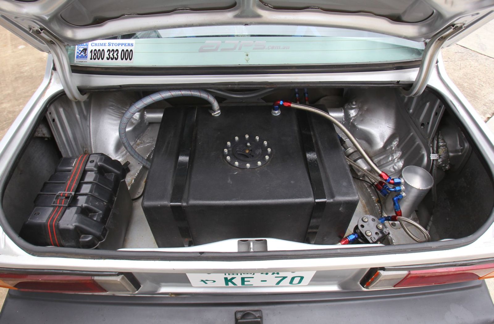

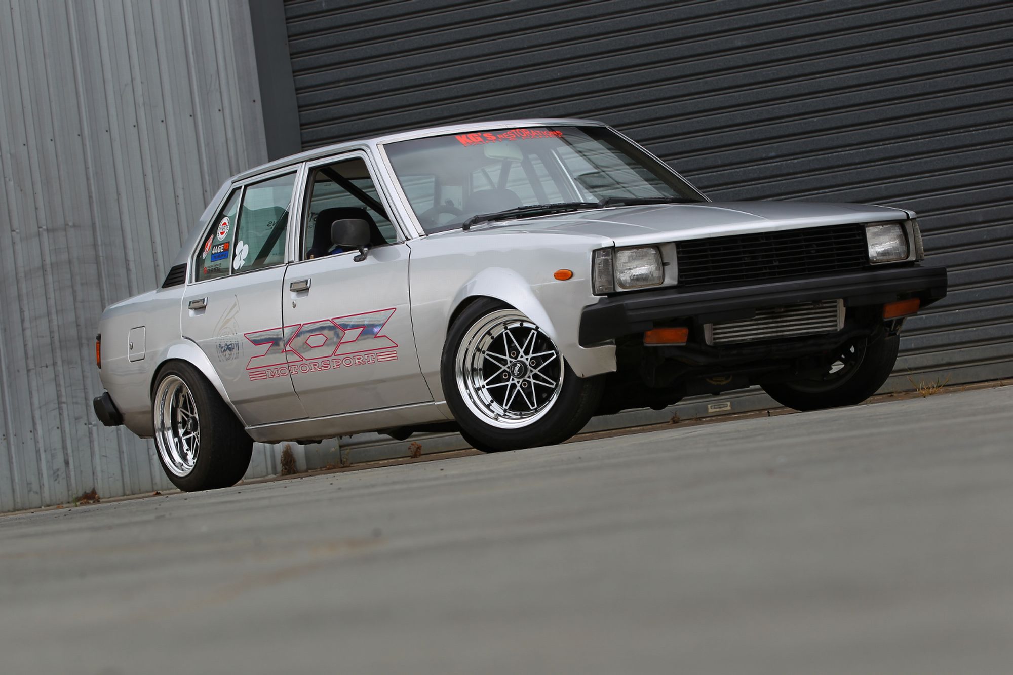

I have been building this car for around 5 years it was beige with a 16 valve and a bit of suspension work.

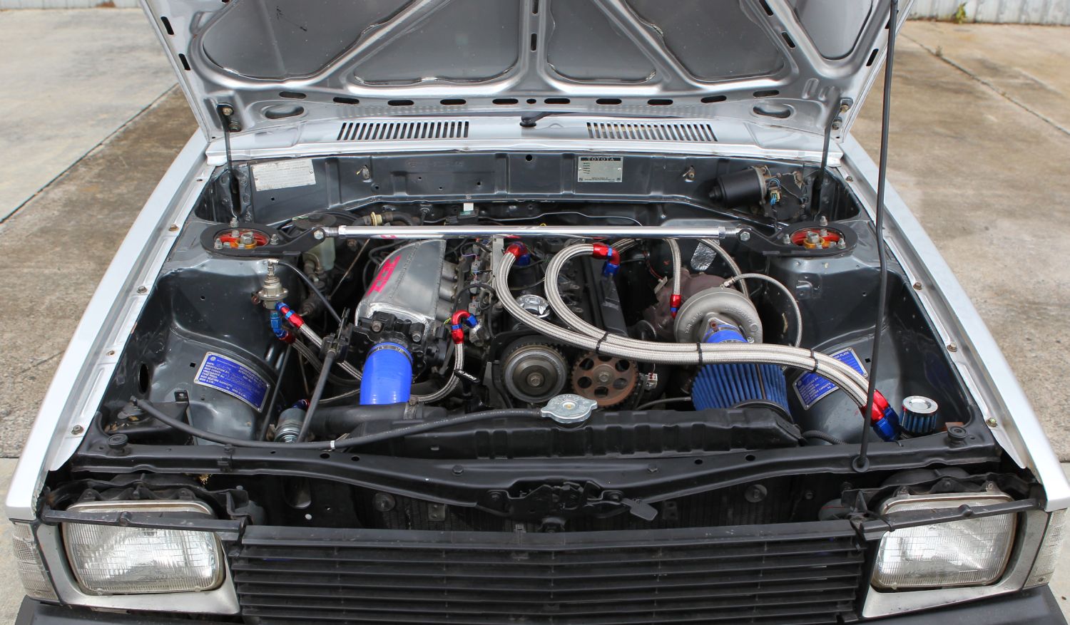

Engine:4AGE 20 Valve Silver top
Engine hardware
Custom oil cooler kit and filter relocation kit, custom oil catch can and modified baffled sump. Nissan trx bluebird radiator with dual thermos, Ground and balanced standard crankshaft, 20 thou over boar with oversized weisco forged pistons 8.5.1, Shot peen and polished 4agze conrods with arp conrod bolts. Arp race bearings throughout, Arp head stud kit, Angular block modification for big end bearings, Aftermarket valve springs, multilayer metal head gasket, bush bearing 28/60 turbo, 38mm external waste gate and screamer, Custom plenum chamber with 3sgte throttle body,1jz injectors, Adaptronic ecu, ae101 coil packs, Straight through 2.5inch side pipe, Custom surge tank with braided line and bosch 044 fuel pump custom surge tank and fuel cell.

Hand flared guards front and rear, Repaint in Alpha Romeo Silver.

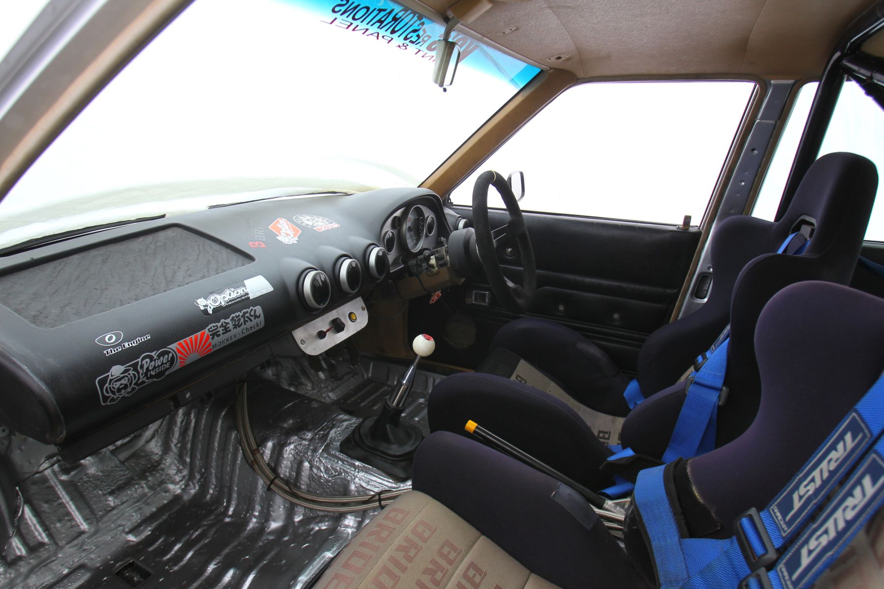

Interior
S15 dash fitted with digital sabre gauges and ace well digital dash, Bride recliner for driver and passenger and Trust harnesses, kkr deep dish suede steering wheel, Trust gear knob. Jap spec turbo timer and custom made hydraulic hand brake and line lock kit.
Car puts out 201.9kw's at 16psi plenty more to come :)
