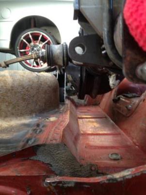

So a little more progress today which was good. Fabricated up a panhard rod mount and made an adjustable rod out of a KE70 item just to get things in and located.
I welded the original KE70 diff mount to my EF diff and mounted the panhard rod (i'd already shortened the panhard rod by about 130mm and welded in a thread for adjustment)
I then folded up some 1.6mm mild steel sheet in two pieces to make the body mount. I then welded both pieces together and braced the open ends.
To ensure I drilled the holes in the right spot I marked one side with a centre punch and installed the rod end to ensure the mount didn't crush while I was drilling.
post-10705-0-66149500-1375689074_thumb.jpgpost-10705-0-27644300-1375689076_thumb.jpgpost-10705-0-13249100-1375689078_thumb.jpg
Now I've had to position the body mount so that under full suspension compression the panhard rod will clear the spare wheel well and still be aligned correctly with diff mount when the diff moves back with suspension travel.
Things are only tacked in at the moment due to wanting to put the car back on stands and make sure everything is going to clear properly with weight in the back of the car.

Have you looked at the watts link bracket behind the diff and have two rods fixed to the housing?
Appears to be an easy approach from what I have read
Share this post
Link to post
Share on other sites
Yeah Buz440 I've looked at it since putting the panhard setup in but there is no room on the passenger side due to the exhaust running through the available space, also the lack of room between the diff and spare wheel well is limited so fitting the diff bracket in would be super tricky.

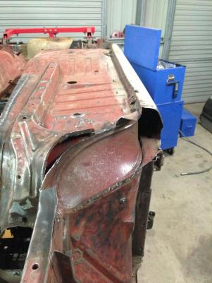

So I've been concentrating on the rust in the drivers side chassis rail. I was lucky enough to be able to get my hands on another section of body that was in much better condition than mine.
So I just unstitched the area I needed to repair and cleaned it up.

The replacement panel had some rust so I had to replace that too. I did this while the section was all together to ensure the panels didn't distort with the welding heat.
post-10705-0-37804600-1377294526.jpgpost-10705-0-45611400-1377294528.jpgpost-10705-0-46409400-1377294530.jpgpost-10705-0-66772600-1377294531.jpg
From here I unstitched the replacement panels and got them ready for welding into my chassis.
post-10705-0-27261200-1377294709.jpgpost-10705-0-03579200-1377294713.jpgpost-10705-0-13850700-1377294714.jpg
One of these panels also had some rust in it and I can't access it once the panel is welded into place so I repair this area once everything was separated.
And here is it all starting to go back together :)
