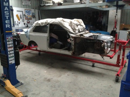

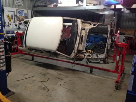

Yeah orangelj it's great. Heaps of adjustment to allow for a good centre of gravity and plenty wide enough to be extremely stable. I just need to sort the front mounting points a little better before I roll it all the way over. I've had to install some mounting points in the rails and they need some reinforcing before I flip it. Apart from that was super easy to assemble and is easy to use and wheel around. Very happy with the purchase. Ill upload some more pics tomorrow.
your build looks really good , I'm thinking about rebuilding my dads old '69 corolla
Do it cohenbateson97, the more old rollas on the road the better :) what plans do you have for it???

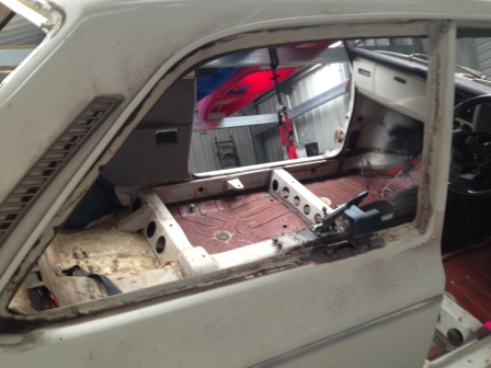

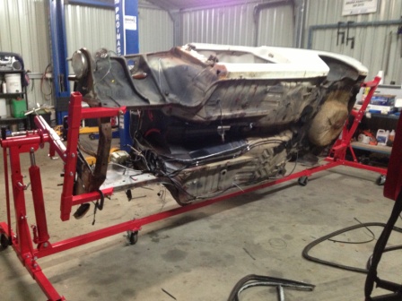

So Heres some more photos of the old girl on the rotisserie. Just need to make up some brackets to brace the front end and I'll be able to roll it all the way over :)

going upside down for the first time is one of the coolest and scariest things you will ever do! haha

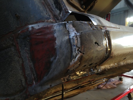

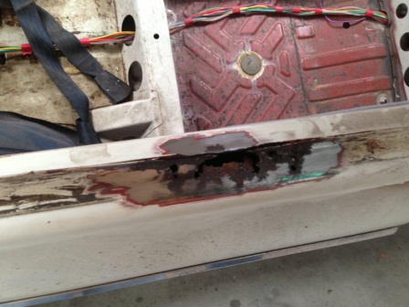

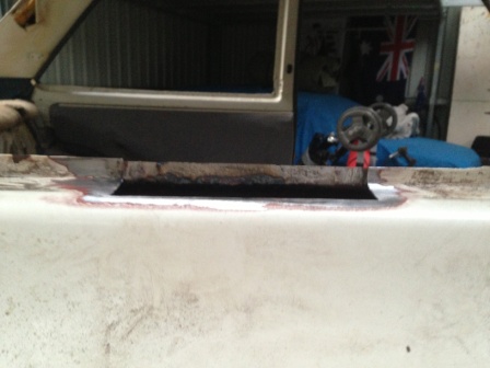

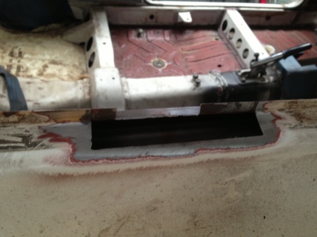

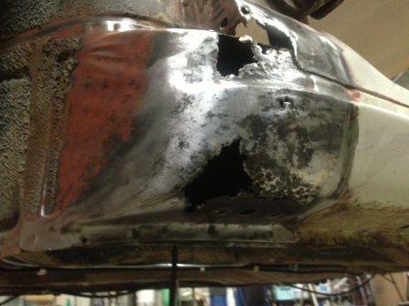

So while I was taking the windows out the other night I found some rust under the drivers side quarter window. I decided to clean up the area today using a black 'wooley' wheel that attaches to the air drill as it removes paint really well without putting to much heat into the area or getting messy like paint stripper. It turned out like this.
I then measured an area to cut out that would give me good solid steel to tack weld the patch to. I used an angle grinder and air hacksaw to cut it out. I was really lucky I found this early as it hadn't spread too much and is in an easy place to repair. So cut out it looked like this.
post-10705-0-58123100-1367656131.jpg post-10705-0-32705800-1367656136.jpg post-10705-0-53438200-1367656144.jpg

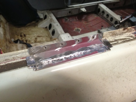

I made up a repair patch out of an old door skin my neighbour had layin around using a sheetmetal folder, angle grinder, hole punch and notcher. I made it so it sits under the existing panel allowing me a good edge to tack weld too.
post-10705-0-57408500-1367656149.jpg post-10705-0-62131300-1367656159.jpg post-10705-0-19346400-1367656168.jpg post-10705-0-14362300-1367656093.jpg
For now this is how it will stay as the car is going to bee sand blasted soon and there is no point putting filler in if it just gunna get blasted out. I'll etch it tomorrow and move onto the next repair :)

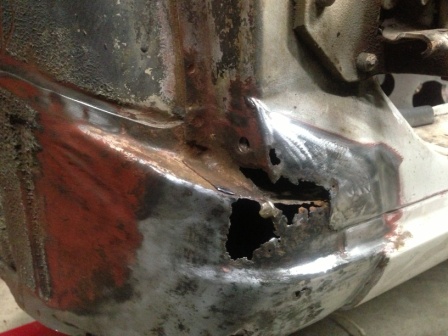

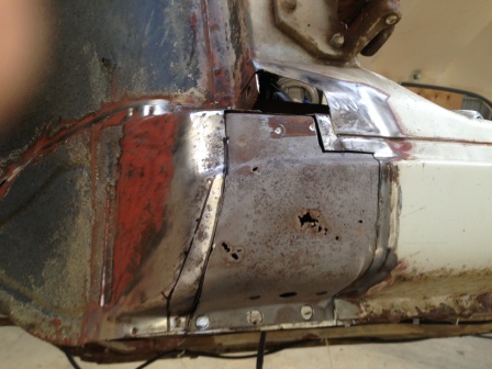

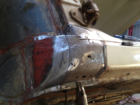

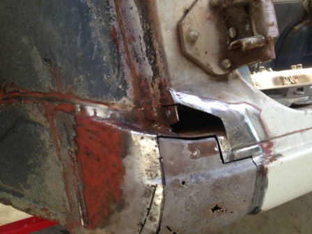

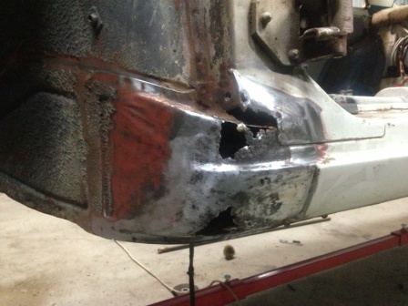

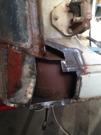

So I moved onto the A pillar on the passenger the other day. I started to remove the rusty section with the angle grinder w/cutting disc and 'flapper' disc and the dremel drill w/cutting disc. First I cleaned the area with the flapper disc to see where the worst of the rust was. As you can see there was a bit in this corner but it is mainly contained to the outer layers thank god.
post-10705-0-63430700-1368673510.jpg post-10705-0-08418000-1368673525.jpg post-10705-0-49048800-1368673542.jpg

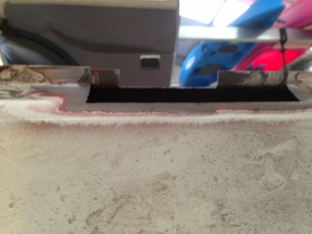

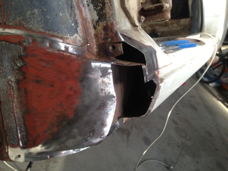

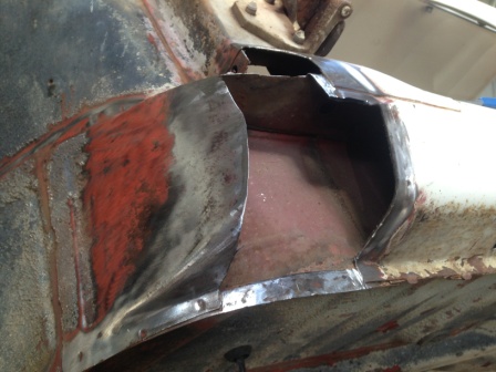

Once it was cleaned back I proceeded to cut the areas out that was affected without going too crazy.
post-10705-0-90224100-1368673559_thumb.jpg post-10705-0-76653400-1368673574.jpg post-10705-0-67706700-1368673593.jpg

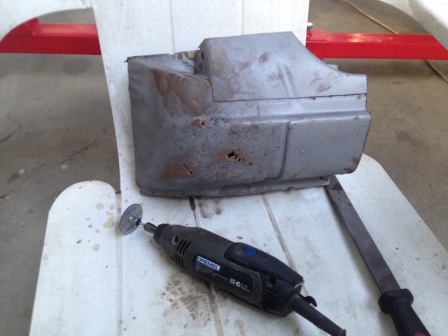

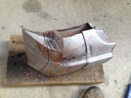

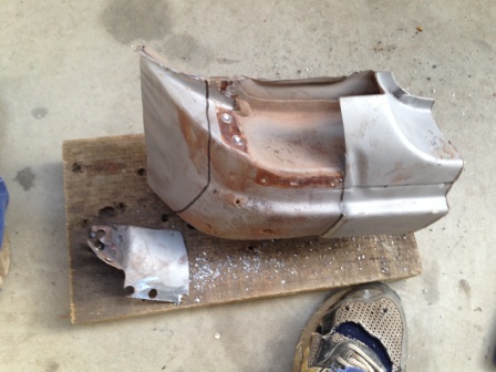

I was lucky enough to buy a wreck of Jordain on here a few months back, this has allowed me to cut the repairs I need out of unrusted sections. This means I don't have shape or form anything, just cut the new sections to size and weld them in. Here is the section I have to work with.

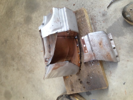

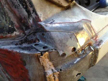

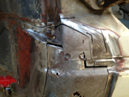

So I was going stir crazy and couldn't help myself. So I loaded up on the pain killers and headed down the shed. I set up a seat and got stuck into the passenger A pillar. I started by unstitching the repair section I had. I used an angle grinder, dreeml tool w/cutting disc and a spot weld drill bit (see photo) these are used to only drill through the top layer of steel which releases the spot weld.
post-10705-0-21234000-1368924994.jpg post-10705-0-14909400-1368924746.jpg post-10705-0-91333600-1368924762.jpg post-10705-0-45265800-1368924769.jpg post-10705-0-91282100-1368924772.jpg

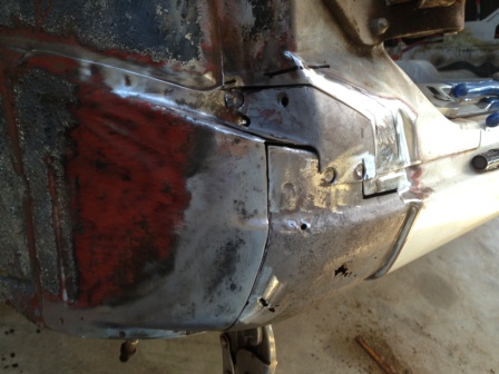

I then cut the pieces down until they fit into the missing section with only minimal gaps, this will allow me to butt weld the pieces in and plug weld where the spot welds were.
post-10705-0-91282100-1368924772.jpg post-10705-0-83157300-1368924778.jpg post-10705-0-60270700-1368924791.jpg post-10705-0-28421400-1368924799.jpg post-10705-0-45413500-1368924815.jpg post-10705-0-65139500-1368924827.jpg
So now I need to treat the pieces with some rust converter weld them in and patch up the little rust holes and she should be all good, much better than the rusty old section thats for sure.

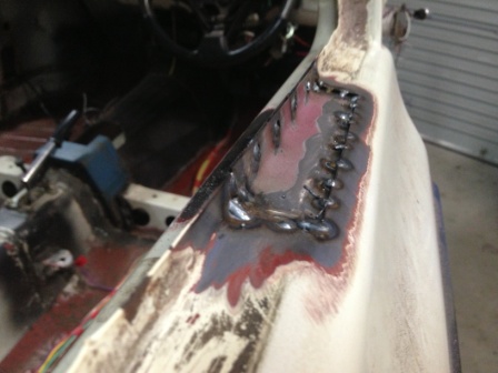

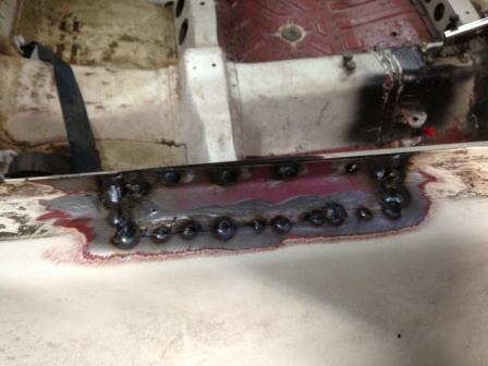

I also spent some time tack welding the A pillar rust patch in started to grind it back when the grinder decides to shit itself :rant: but ti made me a little happier considering my situation.
