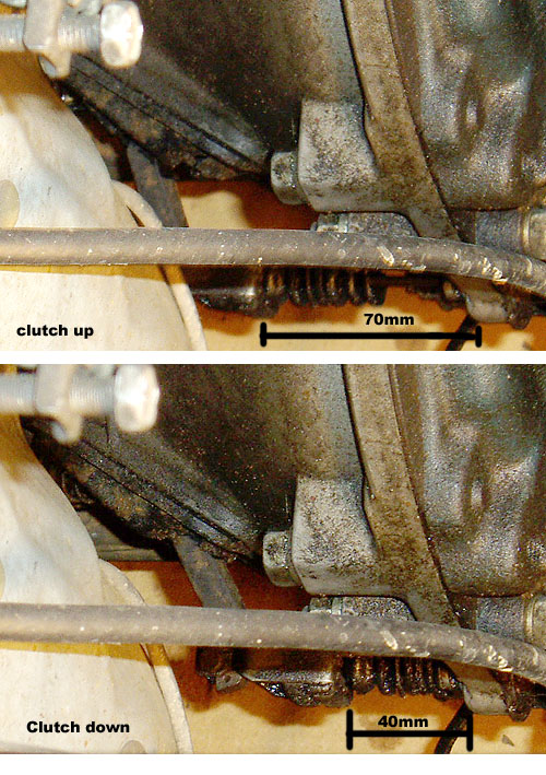

November 11, 201114 yr comment_565574 there is a weird grinding noise which is apparently the release bearing rubbing against the pressure plate Not if there is free play at the fork. That freeplay is a measure of the gap between the pressure plate the release brg- only needs to be 2mm. I'll get a photo-. Edited November 11, 201114 yr by altezzaclub Report
November 17, 201114 yr Author comment_566544 Not if there is free play at the fork. That freeplay is a measure of the gap between the pressure plate the release brg- only needs to be 2mm. I'll get a photo-. cheers for getting the pic man :) helped heaps, ohk so now it takes gears perfect etc etc but a wierd grinding/rubbng noise is evident? took the 5 speed out and put the 4 spd in and it still does it? (not as much) the tailshaft isnt rubbing against the chassis, I'm thinking wheel bearings? or both my boxes are f@$ked? Report
