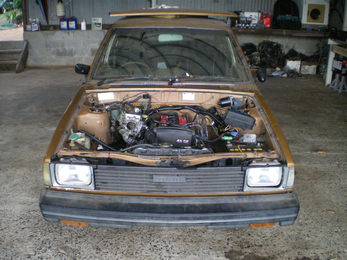

rian Posted January 9, 2013 Author Report Share Posted January 9, 2013 (edited) Pretty much finished, there's a few loose wires hanging in there but they are for the gauge senders that I'm still wiring up.: Gauges in: My friend and I are starting work on the exhaust tomorrow, then it's time for a test drive ;) Edited January 9, 2013 by rian Quote Link to comment Share on other sites More sharing options...

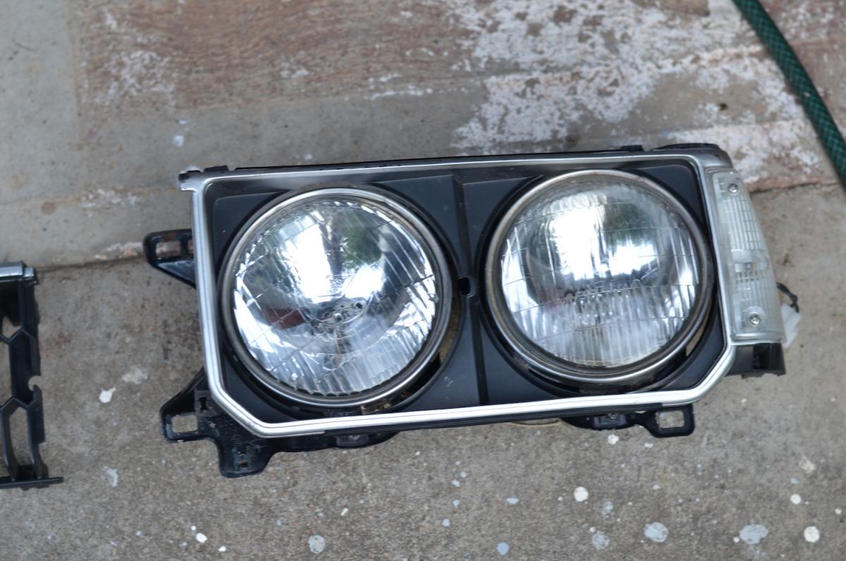

rian Posted January 12, 2013 Author Report Share Posted January 12, 2013 Surprise! I made the drive out to Toowoomba today to see Stenzel (thanks again man :thumbsup: ), checked out his 4AGE KE70 wagon and picked up the lights and bumper pictured. The bumper has a bit of surface rust coming through the chrome unfortunately, but I can live with that. Quote Link to comment Share on other sites More sharing options...
