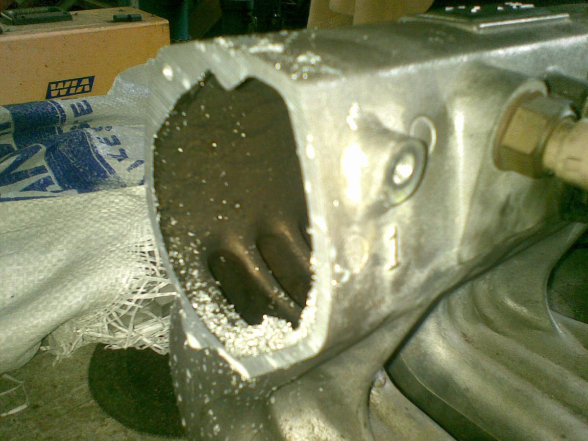

Did this a week or so ago:
Then my mate welded it up (I forgot to get pics of the final product), the manifold is finished and mounted on the engine (this got done on the same day I got the engine running). Pretty happy with the manifold, it's just got a blanking plate blocking off the old throttle body opening and a new aluminium plate welded on for the new throttle body mount. It doesn't look amazing but it works fine.

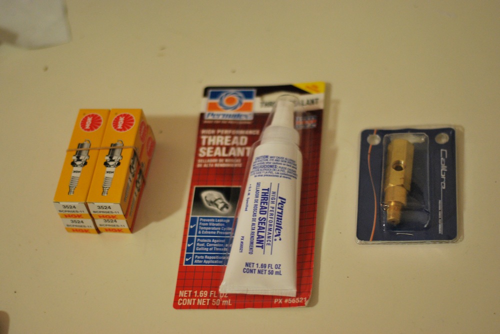

Bought my oil cooler lines today, I know everyone always goes for Earls/Aeroflow/Speedflow etc braided hose but that shits pricey and you need AN fittings and I cbfed doing all that. So I bought some Gates SAEJ1019 spec trans cooler/oil cooler hose (rated to max 150*C and max 400PSI) and I was wondering if anyone can see a problem with running this on a car that sees occasional track use? I know it's not the best but I'm pretty sure 4AGEs come from the factory with the same shitty spec oil lines?
Then I bought some shit to put my oil pressure gauge in, as well as new spark plugs.

the lines are fine, and so are all the fittings etc. so long as you have the correct sized hose for the fittings.
make sure your oil cooler has some sort of flow limiter when its cold though.
id suggest you use the 20V oil cooler sandwich plate (possibly the same as the one you have?), i belive it has a pressure switch in it, so it only pumps oil when your up in the revs.
oh and don't use those shitty hose clamps, get the ones with the bolt. you get them from diesel spares shops.
