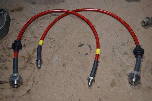

Almost ready to put my HEL braided brake lines in:

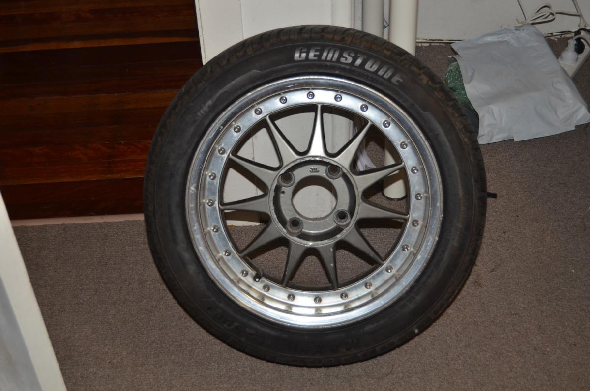

Bought a pair of wheels: Hartge 15x7, offset is +19 which means I'm less likely to get defected. All that matters is I can fit 195/50 and still have fully functional suspension. Plus they look cool and are 3-piece, made in Japan too!
If anyone wants to sell a pair of 15x7/8 wheels let me know, I'd much like to get another pair of wheels in a similar size.
Edited by rian
Bought another pair of wheels, Work Ewing mesh 15x7.5 +10. Now I can run 195/50 all round which I am stoked about.
