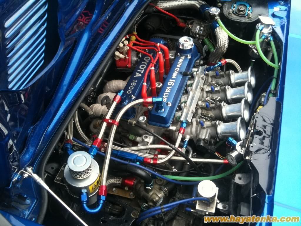

Just a thought. How much height to you have from cam covers to under the bonnet??
What about 7age with quads?
It sits quite deep, the 3sge conversion is probably the most common conversion into these exluding the 20valve.
Whats the extra height of a 7age? I don't even know what it is!
16 or 23mm taller block.
7afe bottom end with 4age pistons and head. Basically an 1800cc 4age.
Is the pain in the ass worth the extra 200cc? whats the mounting like of the 7afe? If I even thought about putting it in might as well put that sc14 on it ...hmmmm
