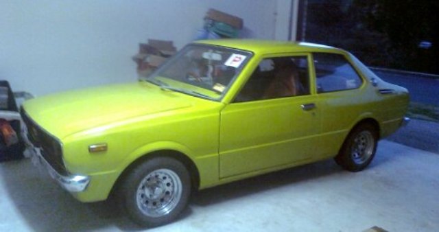

My project is a 74 ke30 2dr 4k,4 speed minor rust in couple of places but good for age
My plan is to try and build tough little 2dr and attempt to do most of it myself,

Hey mate, looks like a bloody tidy 2 door! Plans sound good too. Nothing better than the satisfaction of doing it all yourself! Keep us posted! And what are those wheels?

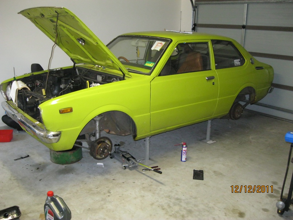

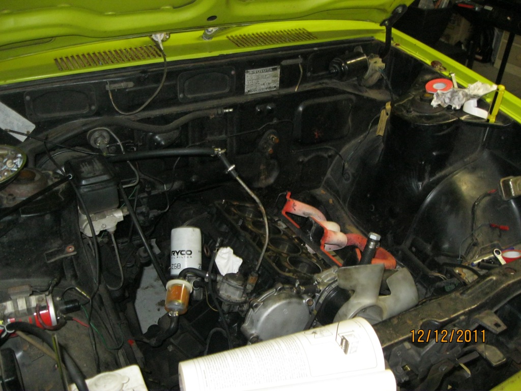

Well made a start last nite removed the head, i was suprised at how basic and straight forword everything is once you crack it open
i have always been a touch to intimidated to even crack a motor open in case i stuff it, so i was pedantic when it came to taking

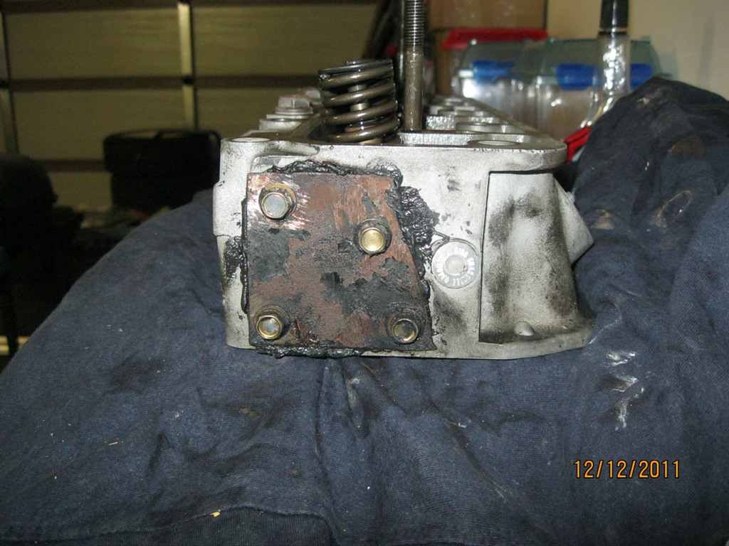

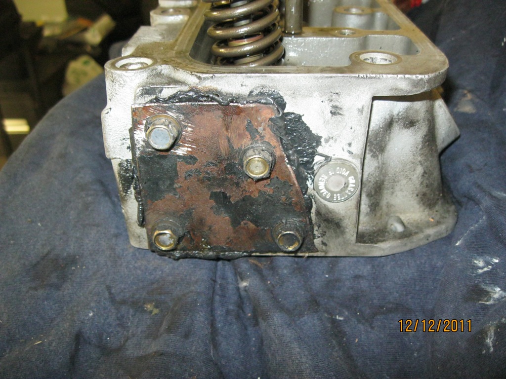

Quick question does anyone know whats up with this head, ports are only 25-26mm i wouldn't think bigport?
Edited by ohwhatafeelinke30
cheers man they where my old modgies but at 13x8 played havoc on my steering components
That's stock sized ports. Not impressive. Looks like you've got a good sensible plan as far as work goes, good luck with the project! :)
cheers buddy its not the port size that gets me whats that backing plate for?
Hi mate, earlier 3k engines had a water outlet on the back of the head for the heater. Some one has blocked it off and havent done a very neat job, thats all.
