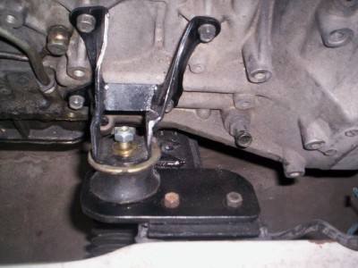

now for the gearbox xmember:
this will be probably be very different for your car (ive not worked on a ke20 before), but all we did was use some 25x25 SHS, and a bit more of the 6mm plate above. got a nissan rubber mount, bolted this to a bit of SHS, and then figured out where to weld the plates on either side, drilled a hole in it and bolted it to the chassis. looked something like this:
which came from this thread, where a guy put a ca18 into some sort of ke35 thing, probably similar to your car:
