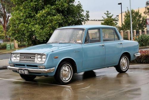

My 2 Rt40S
An RT81 '73. She's all original just lowered with some Whitewalls and venetians. Check her out in the members tides section :)
