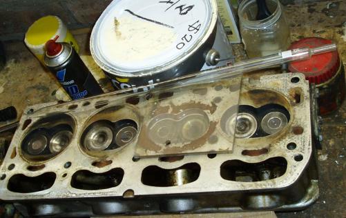

JordyKE Posted April 12, 2012 Author Report Share Posted April 12, 2012 Alright this topic is back up, finally after much time wasted. Took the engine and all the bits, the 4K and 5K heads down to my engine builder in Montrose. Turns out the heads just aren't great, pitting everywhere and are soft as. So i'm trying to source a good 5K head with minimal work done to it, (anyone have one?) I need the shallow 5K head suitable for deep dished D pistons. Or else i'll get flat tops (how much are they?) Also will the need hydraulic pushrods, as i'm going to stay hydraulic as i'm going for a reliable engine, not a fast engine. Cheers. Quote Link to comment Share on other sites More sharing options...

JordyKE Posted May 14, 2012 Author Report Share Posted May 14, 2012 Quick question... Did the vans that came with the 5K's run a particular head? Like the shallow top or the deep dish? Cheers. Quote Link to comment Share on other sites More sharing options...
Evan G Posted May 14, 2012 Report Share Posted May 14, 2012 Different cc in the head Quote Link to comment Share on other sites More sharing options...
JordyKE Posted May 14, 2012 Author Report Share Posted May 14, 2012 Different cc in the head Smaller or larger? I have the D dished psitons. So would it suit? Quote Link to comment Share on other sites More sharing options...
GJM85 Posted May 14, 2012 Report Share Posted May 14, 2012 If you have the D dished pistons you want the head with the small combustion chamber. Quote Link to comment Share on other sites More sharing options...
JordyKE Posted May 14, 2012 Author Report Share Posted May 14, 2012 If you have the D dished pistons you want the head with the small combustion chamber. Thanks GJM85, I know that. Just wondering if the vans came with the smaller chamber or the larger. I guess they'd all be different. It's just the one i can get is a fair drive and i have to pull it all off. I guess i'll just go for a drive and do it, if i can't be certain. Quote Link to comment Share on other sites More sharing options...
JordyKE Posted May 14, 2012 Author Report Share Posted May 14, 2012 Scrap all this shit, i'm spending the money and buying a brand new head. Quote Link to comment Share on other sites More sharing options...
GJM85 Posted May 14, 2012 Report Share Posted May 14, 2012 maybe you could get a standard 4k head and have it shaved 6mm. Then it would suit your deep dish engine. Quote Link to comment Share on other sites More sharing options...
