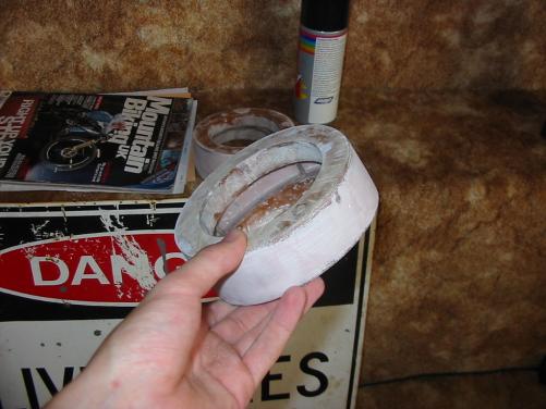

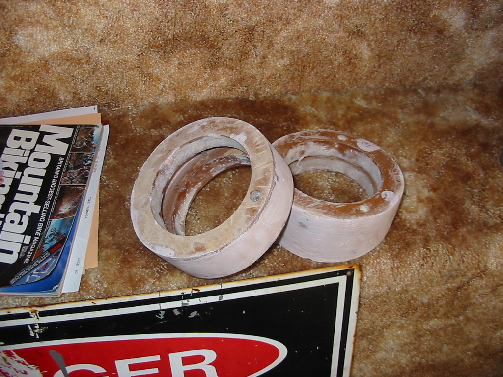

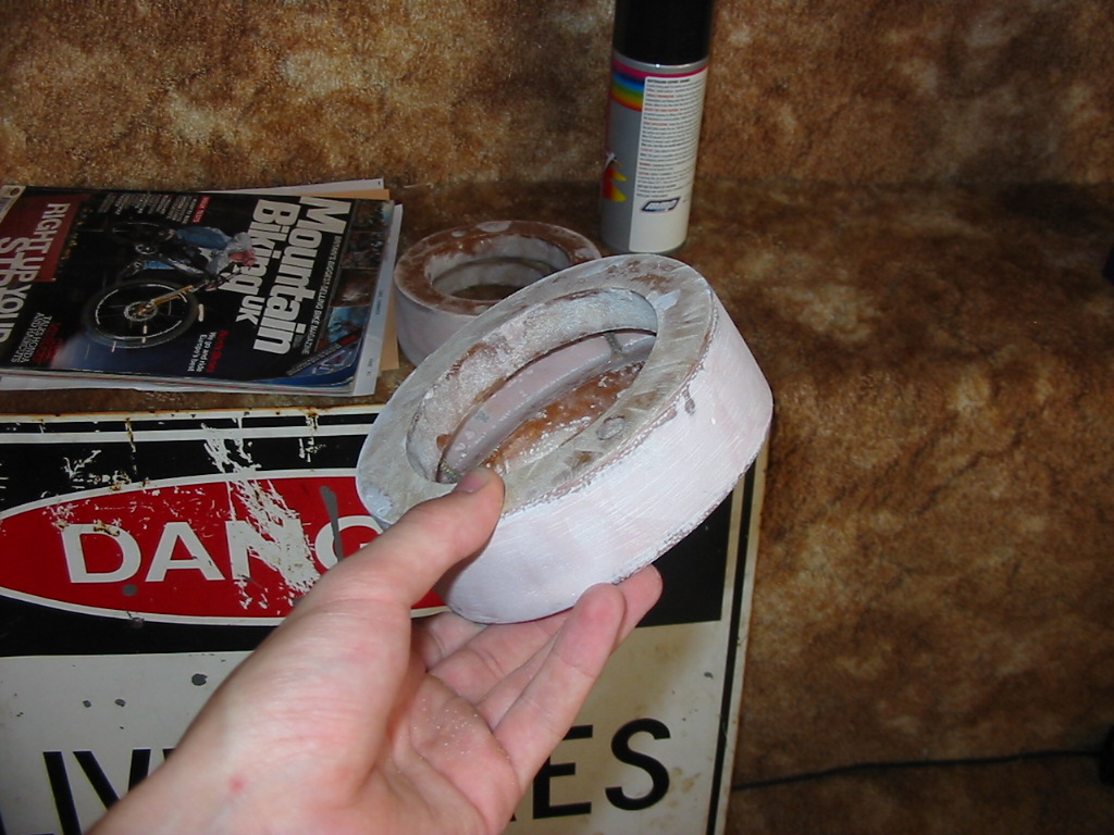

exactly why i did them that way :wink: they don't tend to hit my leg when the door is closed, but they sound good enought for me!
i just held the speaker up with a laser pointer to get the right angle then glued the supports for the ring in at the same time.
Top stuff, bloke.

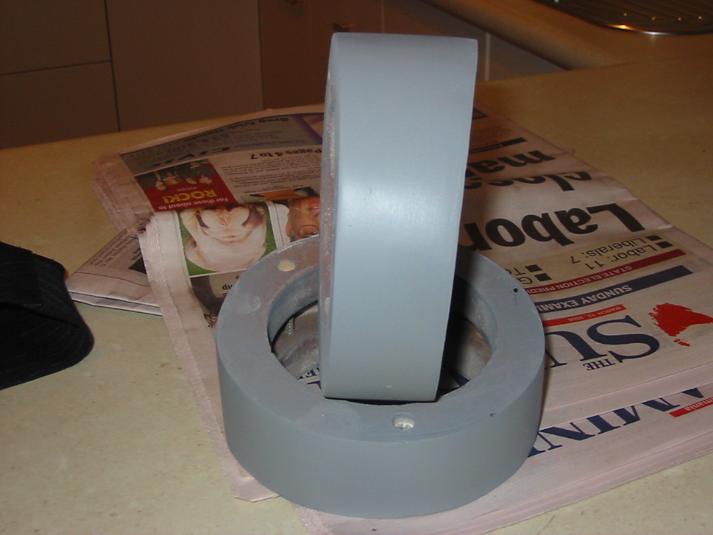

these are my door pods, i put them on an angle so that they point to the other side of the car cause i didn;t have enough room for them to curve around and point to the person on that side!! just finished sanding the bog (first time fiberglassing made a few holes lol) they are wicked ass smooth now!! undercoating this arvo and then top coats 2morrow then hopefully into the rolla soon after!!
Today i did several coats of undercoat with a very very light sand in between coats!!
tomorrow night after work, top coat will go on!

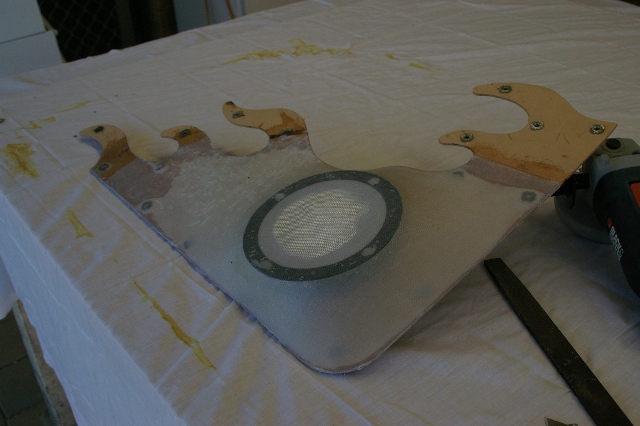

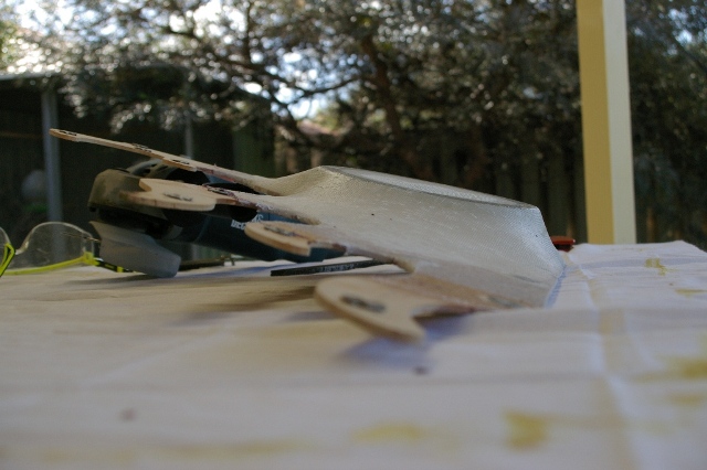

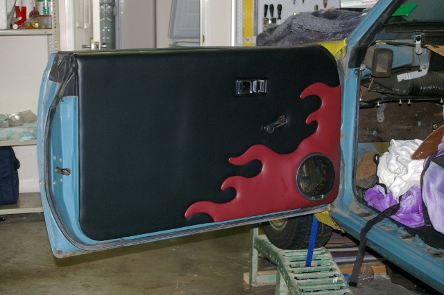

Hi all, I just joined the site and I've already had a go at making door pods for my Ke55. I started with 3mm MDF sheet. Plastic speaker spacers that were already cut on an angle. Cotton fabric, resin and glass.post-2420-1163562443_thumb.jpg.post-2420-1163562452_thumb.jpg. SO far that was the easy part. I used 'T' nuts and counter-sunk bolts to attach it to the door card, so the 'T' nuts needed to be placed in before upholstering. It has 3mm hi density foam covered in dark red vinyl. That took about a 4-5 hours to complete. But it doesn't look that bad. post-2420-1163562460_thumb.jpg I had to remove some of the metal from the door so I could sneak the magnet in and under the window mechanism.
that is really cool man, well done!!
