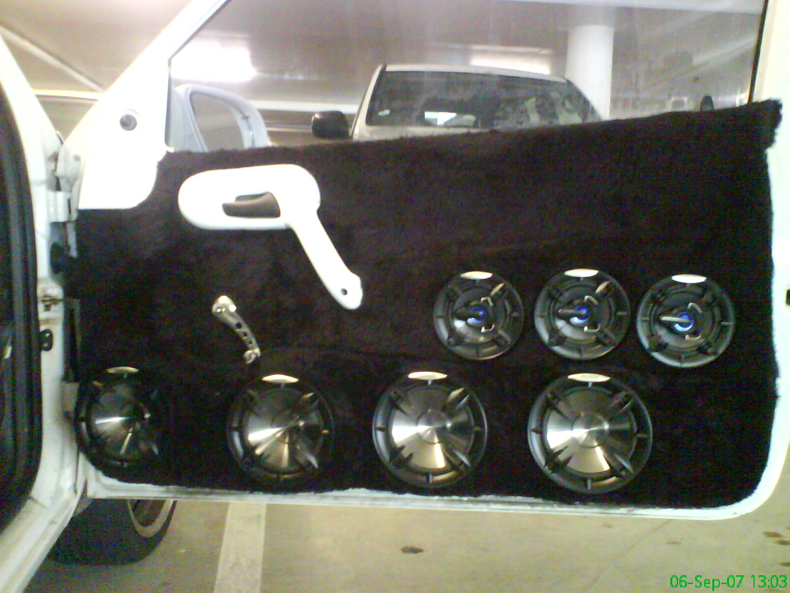

here is my attempt at a door pod well lol a full fiber glass door :( in my barina

For some reason or another, I never made a comment on this pic... hacksaw, crazy man, you are! :D I LOVE IT! haha. The volume from the fronts alone would be insane! :paw:
