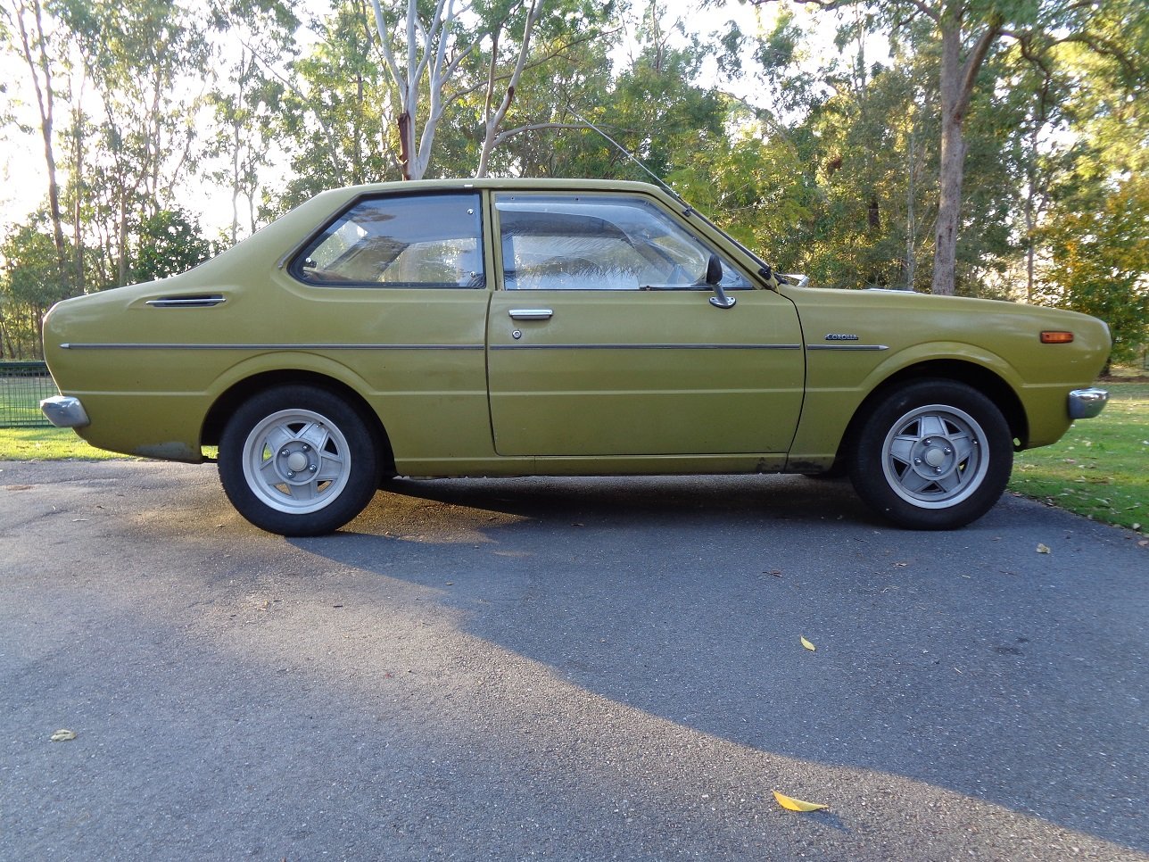

Hi Bruce,
                 Sorry about the delay, but I misplaced my camera.   Here is a pic, which gives you a good look at the ride height I finished up with, after the front end mods I carried out, described in this thread..
Cheers Banjo

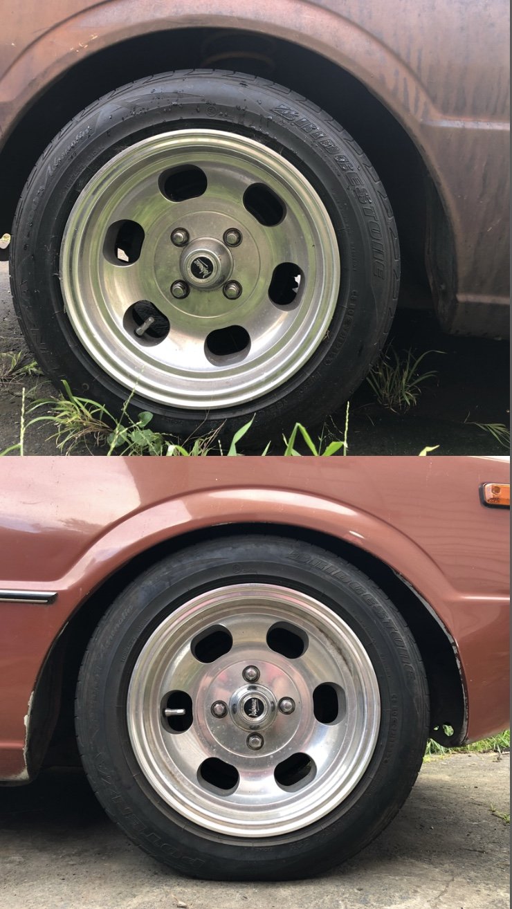

I'm doing some test fitting of RA60 struts converted to coilovers.
Top photo is with stock KE30 struts and lowered King springs. Only lowered by ~20mm.  Space between the top of the tyre and the top of the wheel arch is around 50mm.
Bottom photo is RA60 struts cut 40mm, with Otomoto HSD coilover sleeve kit, and KYB front MR2 shocks. Wind down to lowest setting.

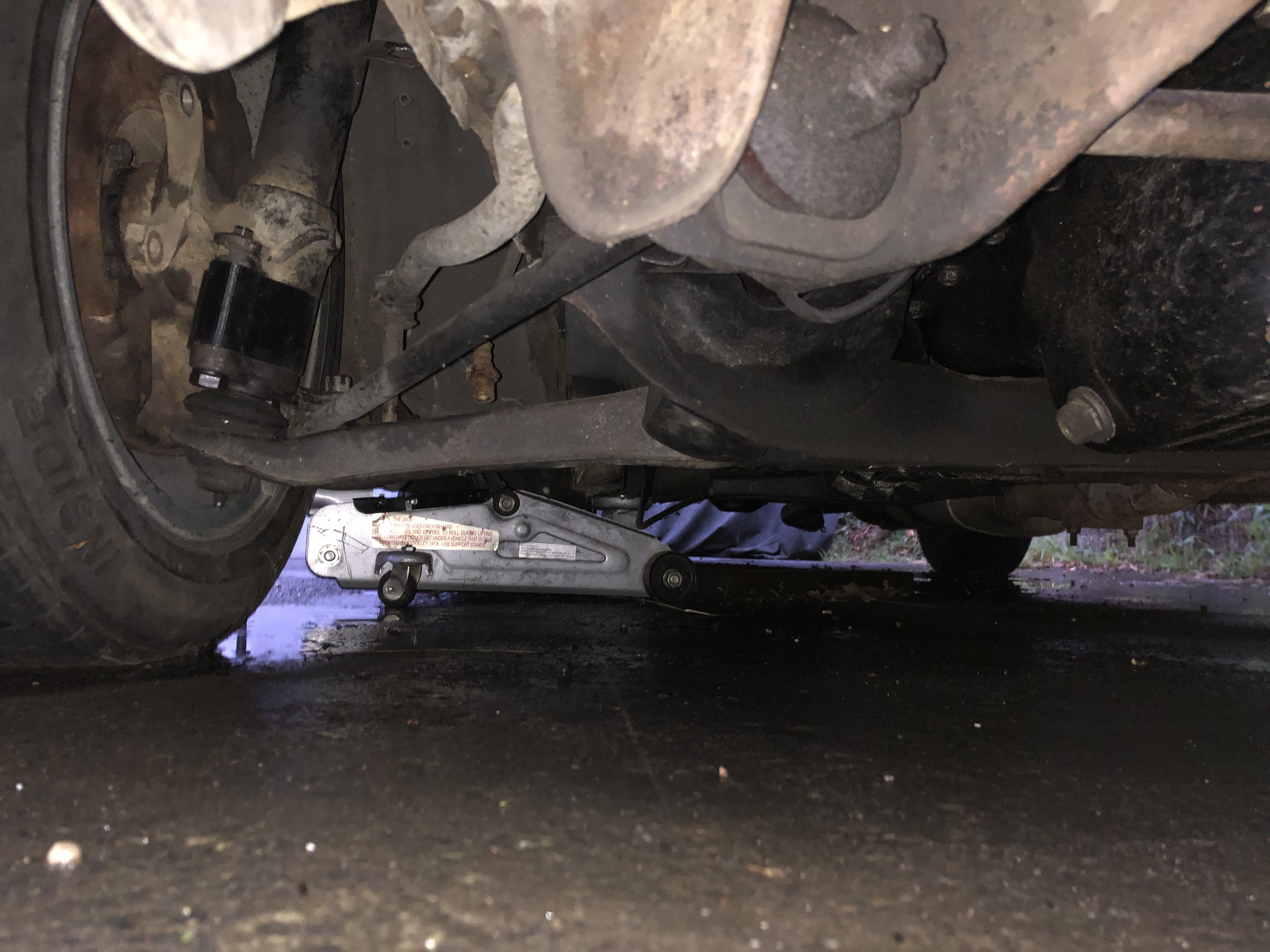

I also had the issue of putting the RA60 strut onto the lower ball joint thread. So I got around it by installing RCAs (50mm), printed in PETG filament at 30% infill for test fitting.
