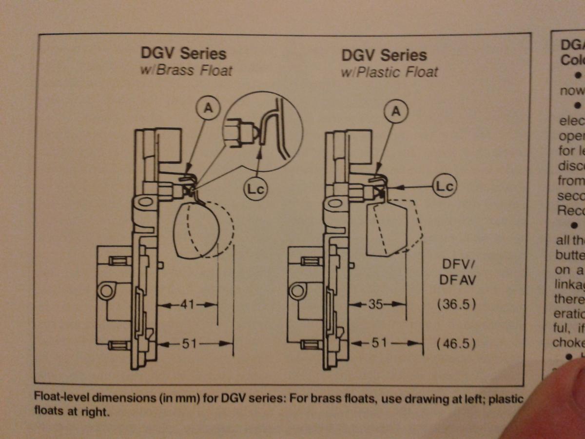

Havee you set the float level correctly?

Is the job of the float to close off the fuel inlet when it reaches the desired level? after i had it running i pulled the top of the carby off and the fuel bowl wasnt overflowing or anything, from memory it was about half full which seemed to be ok?

The float does close it off when it's full, but it can only do so much. Generally they're designed to handle only a few psi of pressure on a Weber, so if your pump is putting out more than that it will overcome the float and cause flooding. Doesn't sound like the problem, but you want to eliminate as many possible problems as you can when trouble shooting.

rito so i pulled it all off last night. Gave the carby a clean and set the float. It was pretty much spot on anyway. Need to get another manifold gasket as i tore it taking it off Grrr. its stuck to the exhaust pretty hardcore even tho it was only sitting on for a week.
