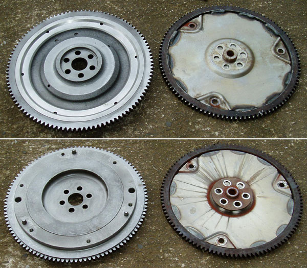

I don't believe I've bolted the ring gear on incorrectly. That middle protrusion in the ring gear should recess into the hole at the back of the crank area, where the otherwise spigot bush/bearing would sit if a manual if I'm not mistaken?
If I am, well....that's probably my problem hahaha.
I reckon. It was quite random, but the flywheel and the flex panel are the same way up in each photo. If you enlarge it you can see where the starter gears hit the flex plate in the top photo, so that side goes onto the crank.
So it appears I have installed it correctly. I'm hoping the issue is a simple misalignment and nothing more.
Thanks for all the input guys, I'll keep you posted.
