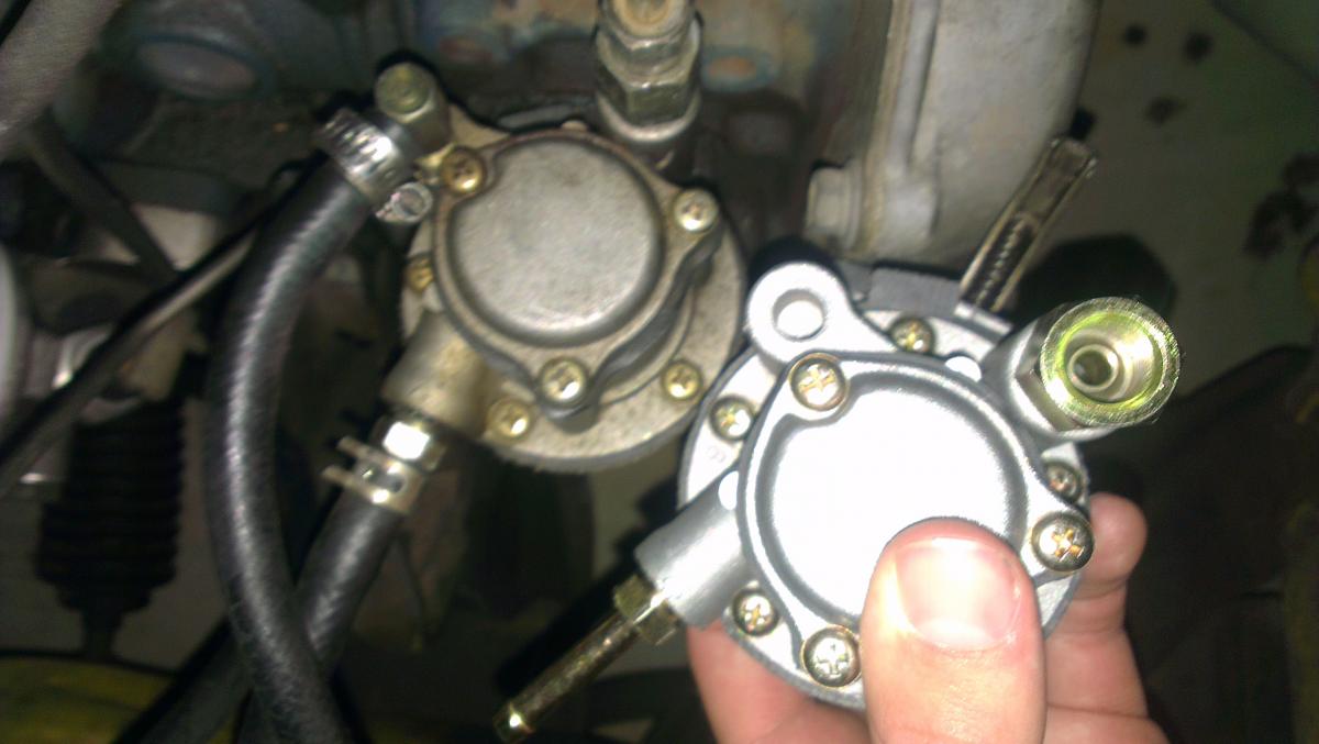

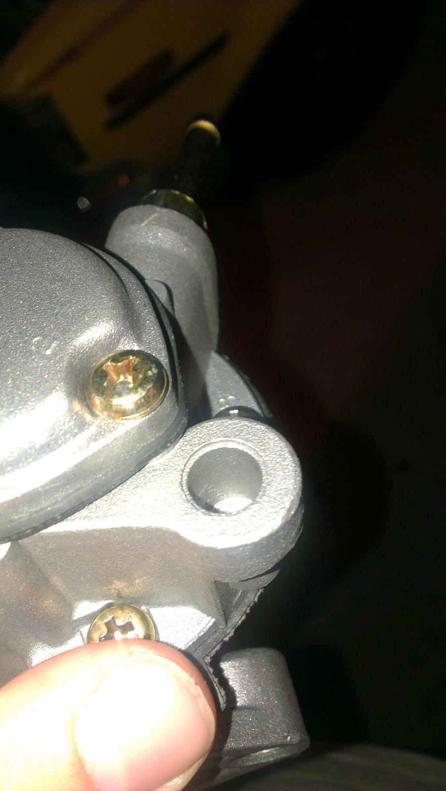

Got a new pump from Bursons today, the pump itself is exactly the same as the one on the motor at the moment, except it doesn't have a return line.
It has the hole where it should be but it doesn't lead to anywhere and the inside of it isn't threaded. But it came with the necessary return line fitting.
Have I been given the wring pump?

Looks like it's the wrong pump.
It's not wrong for a 4k-c in a ke 55 or earlier (no return line on aus delivered cars) but it is wrong for a 4k-c in a ke70
not sure how critical it is though as usually when you get a pump for an earlier model it is a ke70 item that you then just block the return line for.

Thanks mate. Looks like I might need to do a bit more research into blocking the return line I guess.

i had this problem with a fuel pump that was on an engine i bought. i just bought a brass bolt and put that in there and it works fine and doesnt piss out fuel

Yeah, I thought about just running it without the return but I don't want to risk fuel spewing out everywhere.
Yeah like it says above, just pull them apart and swap the internals, just mark/ remember where everyhing goes. Once you take one apart you'll know how it goes.
Or just return it and make sure the new one you get has the return
Just stick a brass fuel bolt in there. It works and doesnt leak i did it to my car and it runs perfect. I wouldn't risk pulling it apart as it will break the seal and wouldn't trust it together again as it would leak
