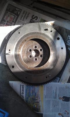

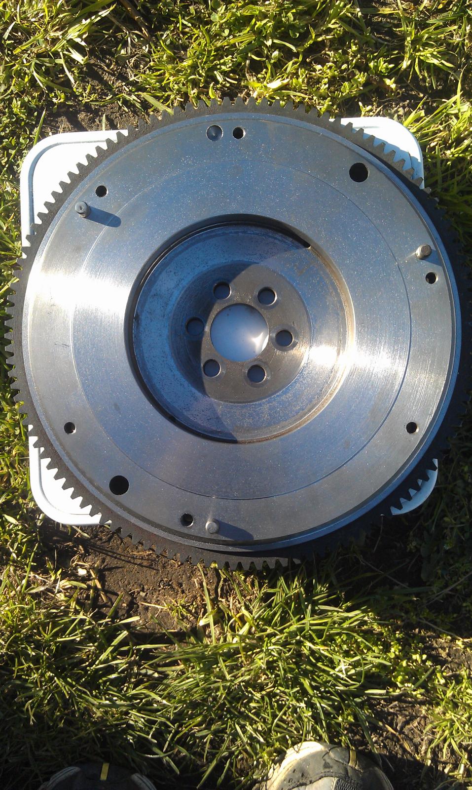

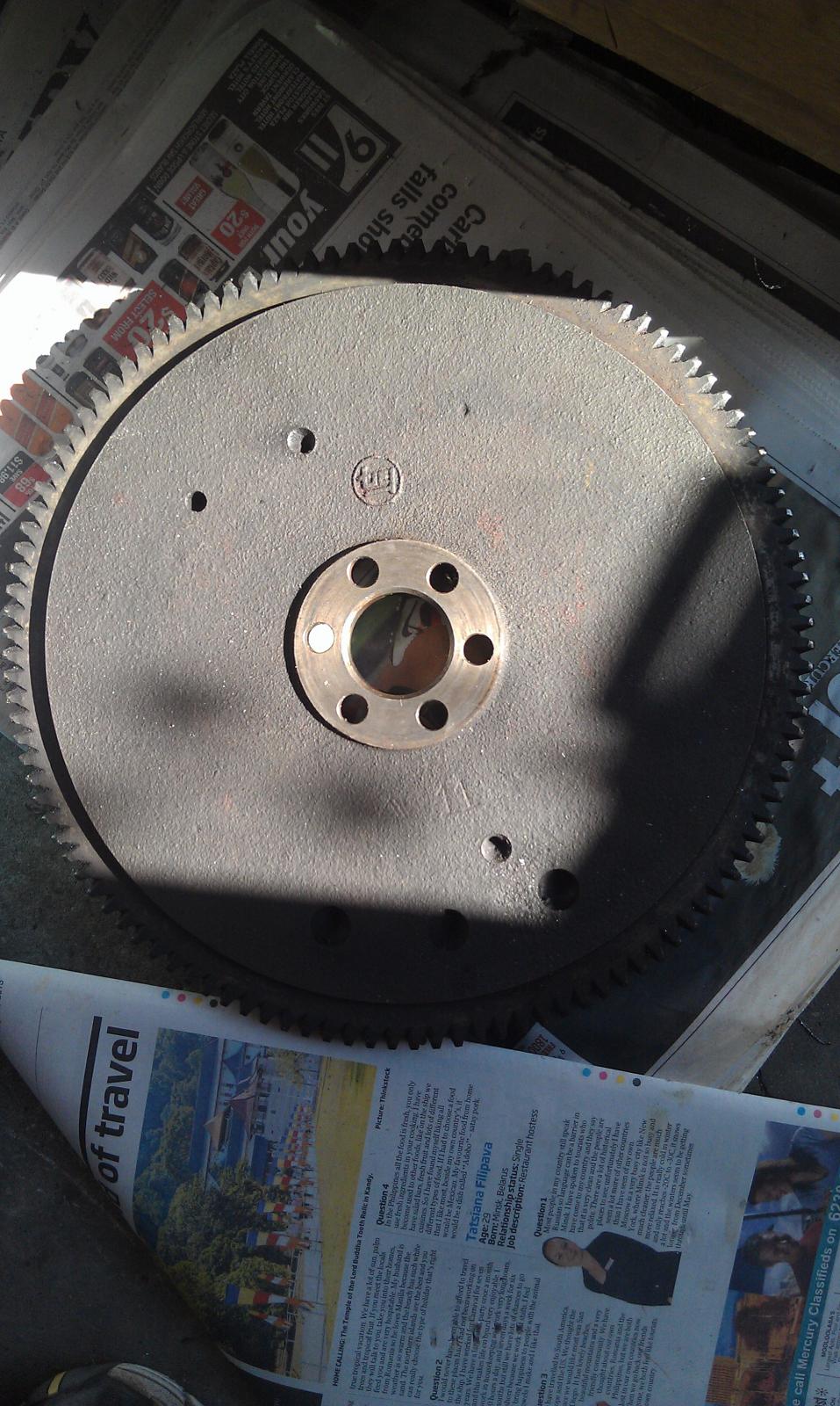

I ended up getting the original flywheel lightened. Went to Tasmania Engine Reconditioning and they were pretty helpful. They've dealt with 2tg/3tc engines a bit and knew how much to lighten the flywheel.
On the bathroom scales the stock 3TC flywheel weighed around 11 Kg. It had 11 stamp on it. They said they can get it down to 14 lbs (~6Kg) for $230 or a bit over 12 lbs for $80 more. Here are the before and after photos:

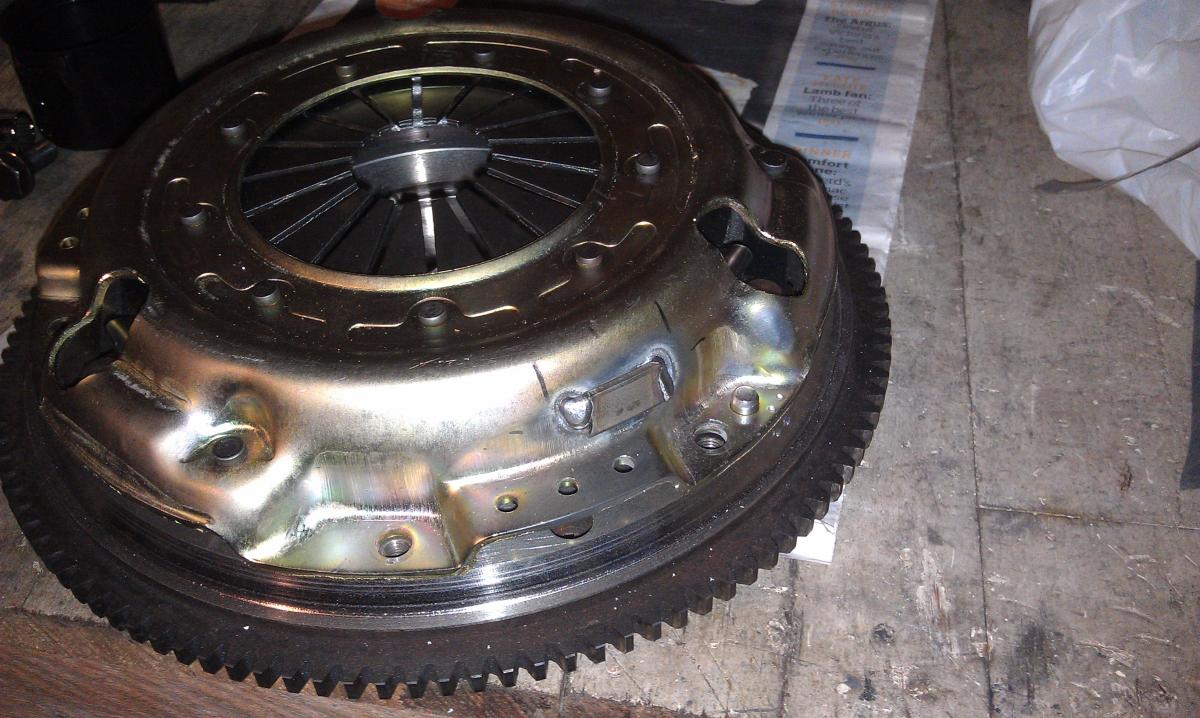

I went with the 14 lbs and it came just under 6 Kg. They also balanced the clutch pressure plate. It was an RPM Clutch Industries one, and it was so out of balance they had to weld a piece of metal to it.
Crikey! id never considered that a clutch coudl be out of balance. i would have thought that would be the most important thing for a clutch manufacturer....

Yeah I would of thought balancing would be one of their quality control measures during the manufacturing. They must have low tolerances for cheaper manufacturing costs. The kit was pretty cheap, bought it for $124 online. It's a Clutch Industries Heavy Duty RPM clutch. Not sure how well balanced the more expensive Exedy HD clutch would be. That was around $400
Here's a photo of the metal weight welded on:
