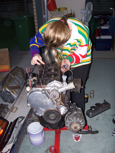

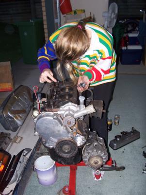

I have a dying 3k and many many parts that need replacing. I have myself another car for 5 weeks starting tomorrow. I also have a fair chunk of what was formerly known as Mango, thanks to Jamie. Can you guess what is going to happen over the next 5 weeks?
Here's a little hint. My wife stripping down (get your minds out of the gutter) a certain worked 4k so we can inspect it before a quick gasket change and head rebuild. Mechanical first. Visuals later.
It's just too easy isn't it. Hahaha.
Finally got to get stuck into it this week. The head is off getting rebuilt. Unfortunately (and Jamie wasn't to know) 3 of the exhaust valves were sitting 20thou too low into the head, there was a couple of cracks and the head face itself was 3mm out because whoever skimmed it only managed to skim one side of it. Bugger. Oh well. It's all fixable which means it should get up and haul ass once I have it back. The block disappears some time this week to check that over as well.

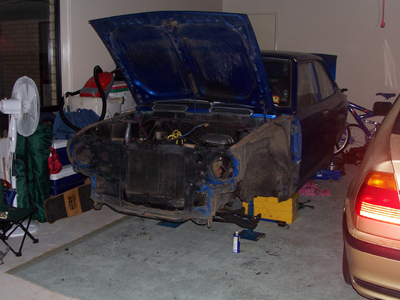

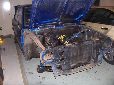

Started the big strip down on the car. Upon removing the front guards I found some unfinished accident damage. Guess I'll need my sledgy out for that one. ;) Anyways diff, struts, tailshaft and springs are out.
