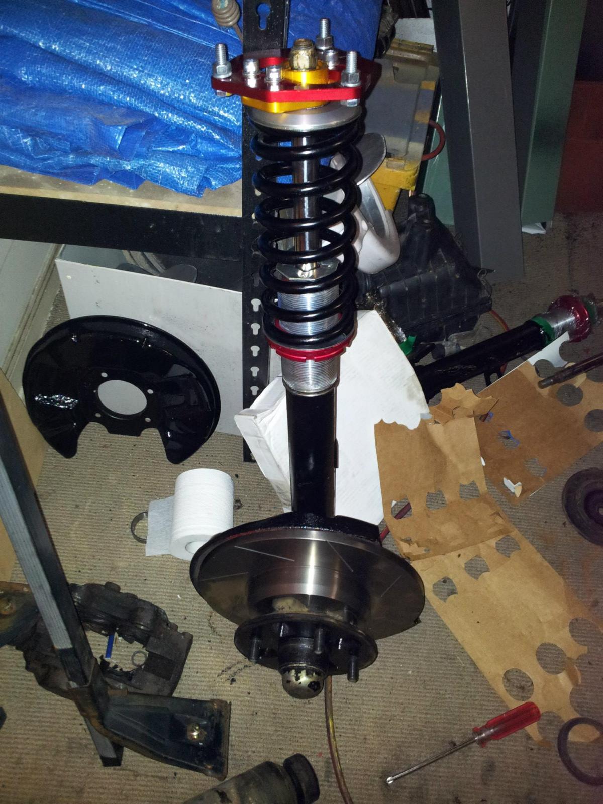

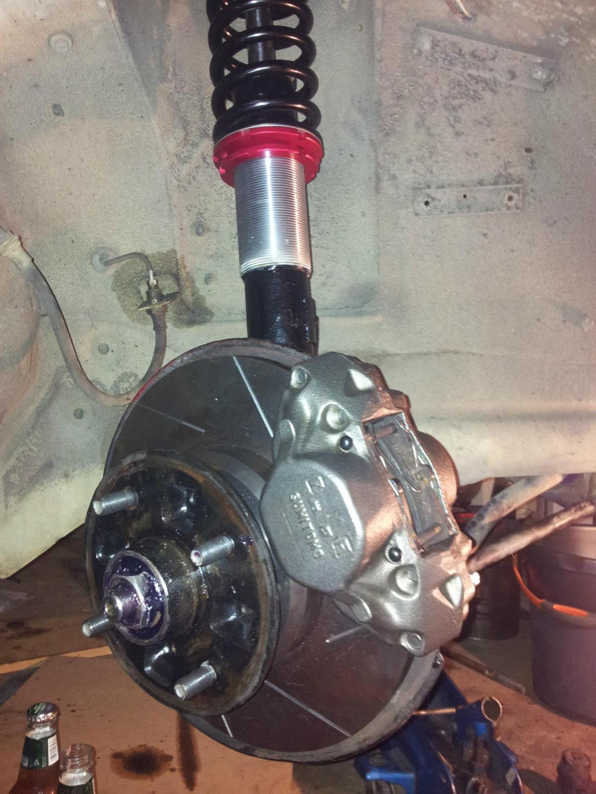

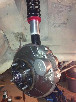

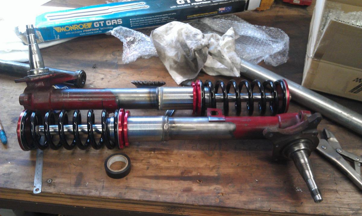

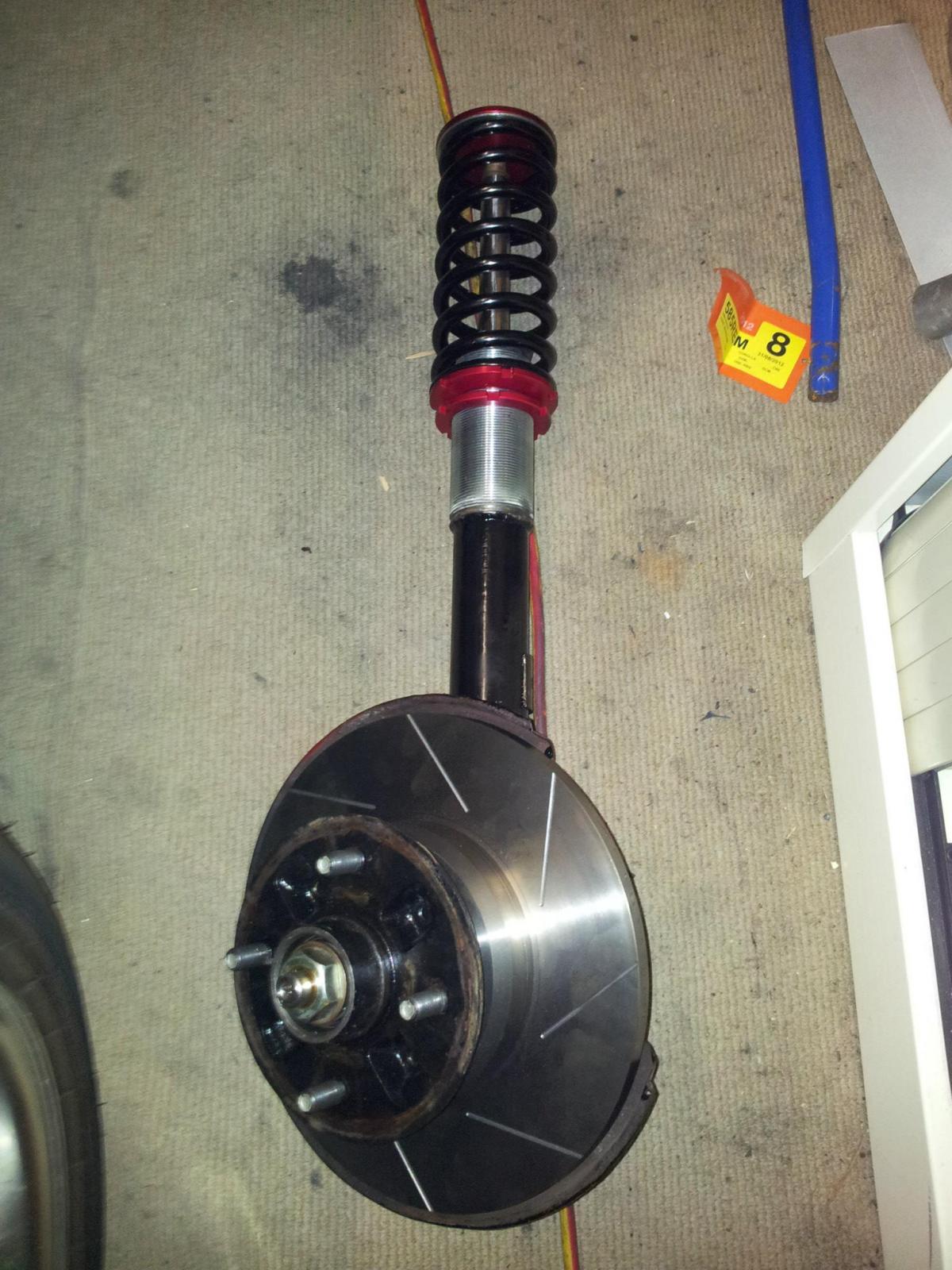

You wont pass a blue slip with coilovers anyway. Throw your uncut shocks back in and build the coilovers. Definitely use the HSD kits from Otomoto, I used them along with shortening my struts 40mm. Perfect.
Edited by B.L.Z.BUB
Wow they look nice mate, how much did the inserts cost you, I was thinking about KYB sw20r but if the monroes are cheaper I might go with them.My friend had coilovers in his supra and it passed blue slip, why would they not pass it? it's safer than the old claped out stock suspension.
Also do you have to run camber tops with the coilovers? or can you use the stock strut tops I don't want any camber wear on my new tyres that's all.
Just using Monroe GT short strokes (got dirt cheap mates rates), really need to upgrade to some adjustables. Yeah I have T3 camber tops, because of my wheels and the slight extra track the XT gear gives you I need to tuck in my wheels so they fit under the guard. My car is only a weekender so camber wear isnt an issue.
