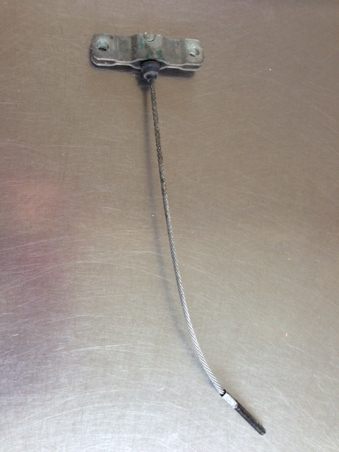

September 30, 201313 yr comment_668038 The Camry front cable is shorter than the AE86 front cable, from memory it was from an SV11 (edit: but could have been SV21). It can be used to get your handbrake back into adjustment when using a Disc brake rear in an AE86 with factory rear cables. The splitter makes no difference. Of note, The factory front cable is identical in both a T series equipped AE86 and an S series equipped car. The difference is in the cable location on the handbrake lever. As KE70Dave says, what do you mean by they don't fit? Edited September 30, 201313 yr by parrot Report

September 30, 201313 yr comment_668040 When I first discovered the SV11 cable solution, I went to the wreckers and pulled front cables from various Toyota's. Most were longer. The SV11 was the only shorter one. Note your AE86DC thread quotes SV21 cable part numbers. There is an SV11 at Centre Rd wreckers in melbourne at the moment if you know anyone who can grab it for you. I can have a hunt around as when I fitted the GT handbrake lever to my AE86, I had to remove the SV11 cable. Report

September 30, 201313 yr comment_668043 Just went out and found my old one. Yours for $15 posted. Report

September 30, 201313 yr comment_668046 Its still a wee bit long, but you just stack a few washers on it. Report
