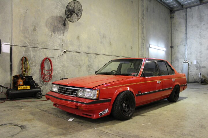

January 15, 201412 yr Author comment_675518 Can be cheap or expensive. Depends how much you do yourself! Mine has been fairly cheap as ive done nearly all of it myself. There a very basic engine and wiring them up isnt that hard. Give it a go but i highly doubt it can be registered! Heres a photo if my rolla atm. Club reg brother! yeah will see how things go how much have u spent so far? Report
