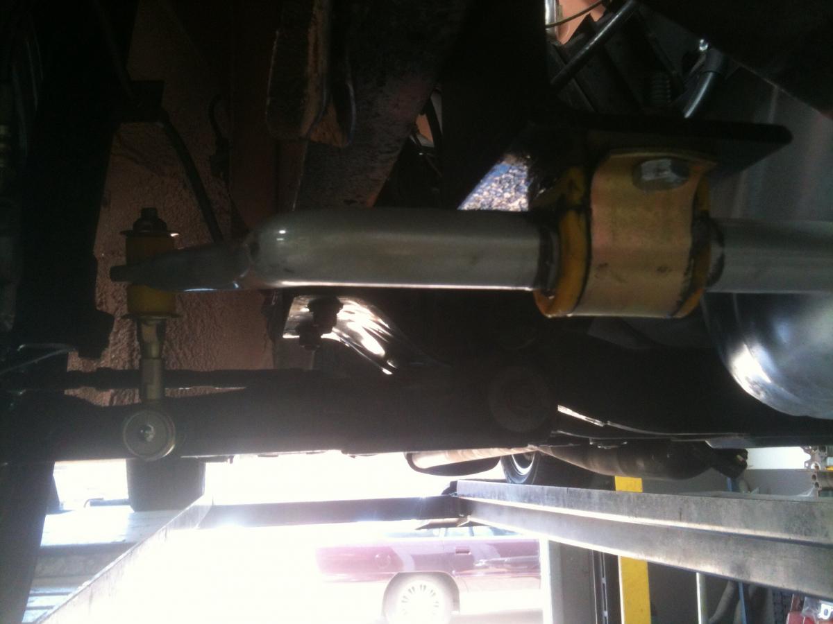

So I got my sway bar today. Has anyone took any pictures of their assembly? I'm not quite sure how it's supposed to be assembled to the car.

The large L bracket bolts to the chassis rail, I used a custom control arm mount but the kit has a bracket
That bolts to the arm in a similar position.
Hope this helps.
Removing the front leaf is a good idea if you use a stiffer coil springs on the struts, otherwise you will bottom out the original front shocks and the ride will be terrible
