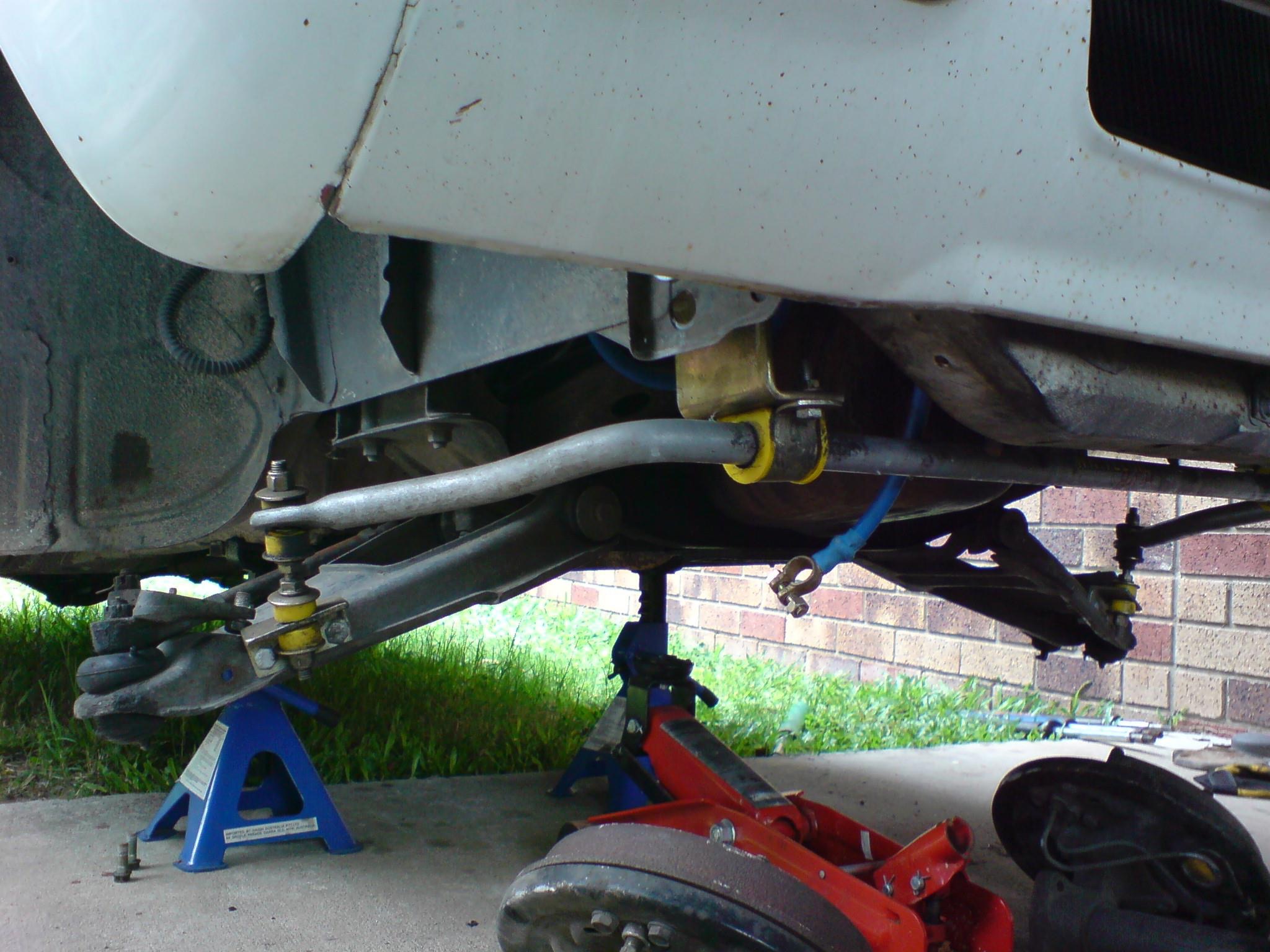

April 13, 20179 yr Author comment_708938 Long time since I last posted. I'm currently serving my time in the finnish defence forces, so I haven't drove at all. Corolla is still working fine and I'm waiting for summer when I can cruise it hard again. I'm having a easter holiday atm and thought I should finally assemble the sway bar! But obviously it does not fit as it is. I'm just wondering how have you guys solved the problem with the bar hitting brake calipers? Thought of making a new L-brace for the dog bones, but just wondering if anyone has a better solution. Hope I could upgrade the car a bit and give you guys updates again! Report
April 14, 20179 yr comment_708951 The bar was originally designed for the cars fitted with drum brakes. The way around it is to have a slight bend in the bar to keep it away from the back of the caliper. I asked for this when I had mine made at Signature swaybars, who have the original patterns white line use now. I have pictures somewhere I will try and dig out Report
April 14, 20179 yr comment_708952 Here we go. Not my car. Eye measurement centre to centre is now 895mm. Report
