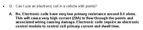

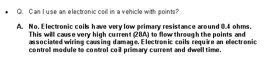

There are two types of coils. Those designed for use with "points type systems", which usually have primary coil resistances of several ohms. I think the GT40R is 3.4 ohms. Kirill, I think you are OK.
Then there are coils designed for use with electronic ignitors, which switch the primary current. Their primary coil resistances are usually less than 1.0 ohm. 0.4 ohm is common. These should not be used with points type distributors. Even the Bosch website states this clearly in their FAQ section.
