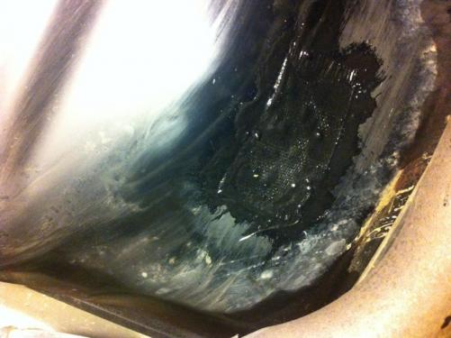

Well i thought id close this one out, as everyone loves some photos.
Pretty good success, the stuff took longer to mix up and way longer to harden than the packet suggested, i suspect cause it was quite cold in my garage.
I left it from about 9am till 5pm, and it was still a bit tacky.
Here is the area after some sanding and cleaning with the alcohol wipe. See the hole? yeah me neither, its sort of right on the crease, i couldn't see it even after i sanded it.
Here is me getting enthusiastic with the putty, i sort of maybe put it all on.....i squished it out much more than this after photo was taken.
and here is the final product, what a freakin mess. (no photos between as i was working fast and that black crap gets on your hands and is like tar!
Not the easiest applying fibreglass upside down.
