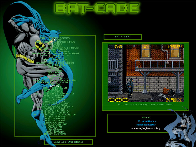

I have all the software I need from Mame and a front end from mameWah
I have designed a custom 'skin' for mamewah to suit the cabinet design I have in mind
Note the number of playable games list at the bottom left 2900+!!!

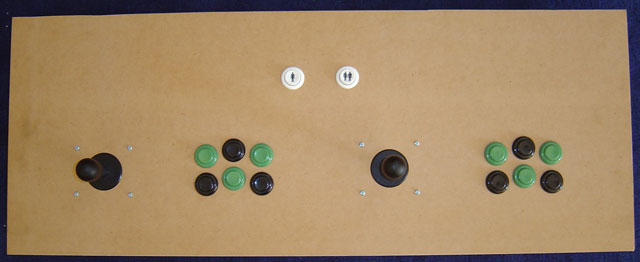

Last weekend I put together the layout for my control panel (joysticks and buttons) just to see how it felt. I wanted to make sure there was enough room between the joystick and buttons to be comfortable, also that the buttons were comfortably space and aligned and that if two players were at the machine that there was enough room between the two sets of controls.

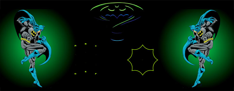

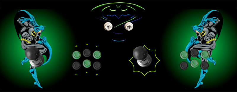

Being happy with the physical layout I then proceeded to make up some graphics to overlay the control panel with the same basic style as the 'skin' above.

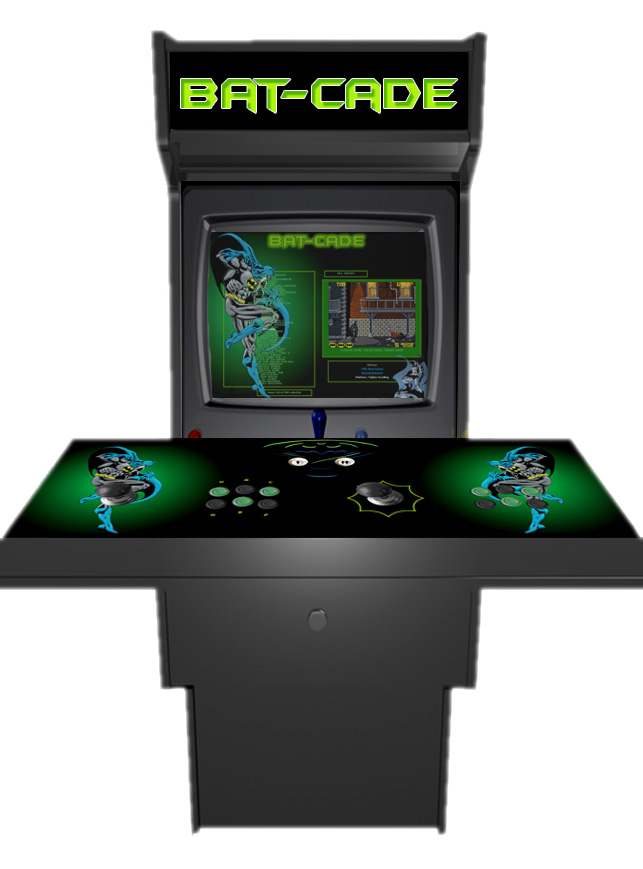

Just so I had an idea of how this will look with buttons and joysticks on it I created a mockup so I could identify how crowded it would look and if too much image/detail was obscured.

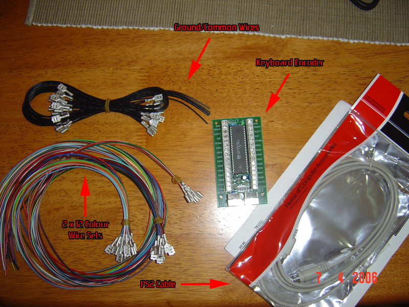

So some bits turned up in the mail today ...... (insert happy dance here) :P

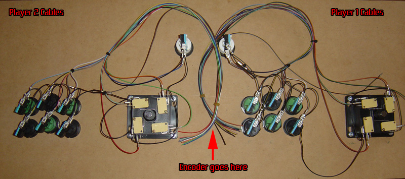

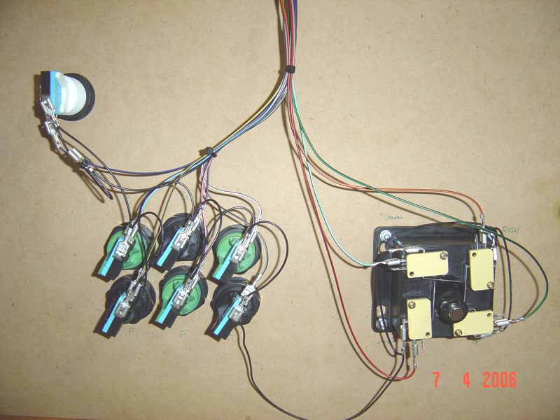

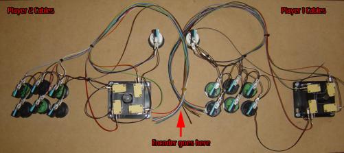

I jumped in and started wiring
Player 1 Controls
Its not as neat as I'd like but as Nick said ... "only I will know"
Having done side one (count the wires - friggin things) I realised it would make sense to wire player 2 in the same colours (it was only moments before that I had discovered both sets of wires were the same colours with one set having a black stripe.)
So here is everything (except coin slot/credit button) wired and kinda neat - still contemplating heat shrink on the cables - but as this panel is only temporary I'll wait for now.
Tomorrow its finish the timber assembly, add the credit buttons and strip ALL those wires to go into the keyboard encoder.

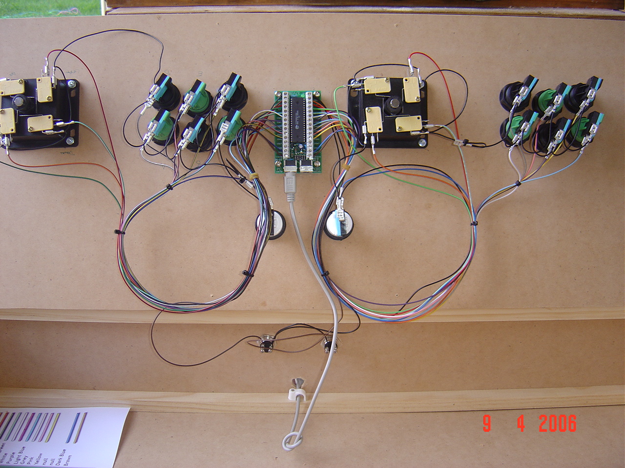

Finally finished the control panel today - yesterday I had to do family stuff (gahhhh)

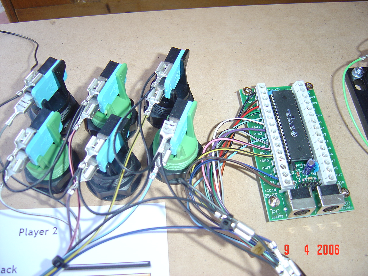

So I finished building the box for the control panel then fitted the encoder into a useful and accessable position.
The challenge was to try and work out how to attache the circuitboard to timber - in the end I drilled some small holes and used spare mounting poles from my motherboard.

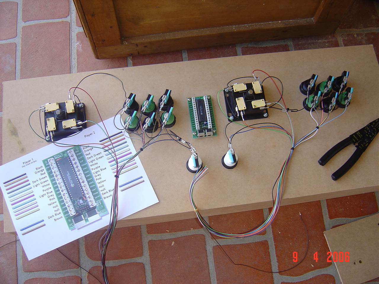

Then the challenge was to wire in all the switches - notice the 'cheat sheet' I created so I didnt have to trace any wires back. and the loom actually looks tidy-ish
Finally wired up player two and the two credit switches (below the main circuits on the back of the control box.
Just tested it - and it all works - every switch detects properly and is wired into the right position !!

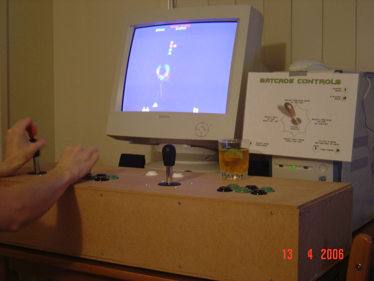

Bought an upgrade kit for me - and retired the old pc to the arcade box
quick swap of a few parts ....... (damn those bunny chairs are uncomfortable)
and the whole thing is ready to go

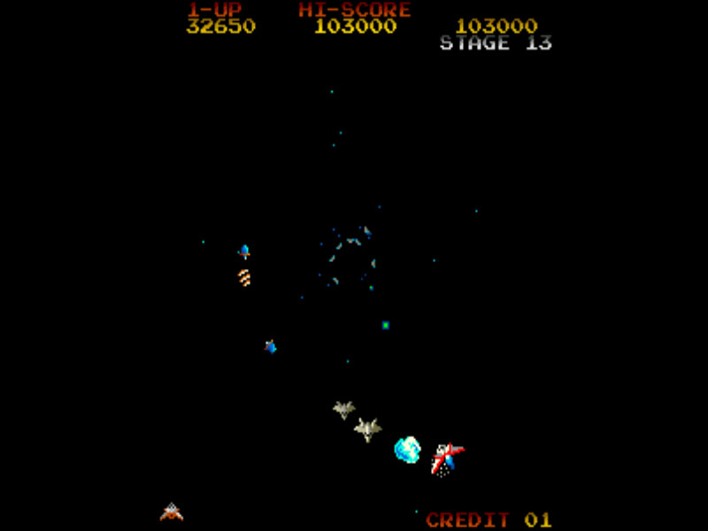

here it is being put through its paces by my girlfriend (she likes Galaga)
ps. having the control panel did improve my gyruss score ...... 109k up to 176k
