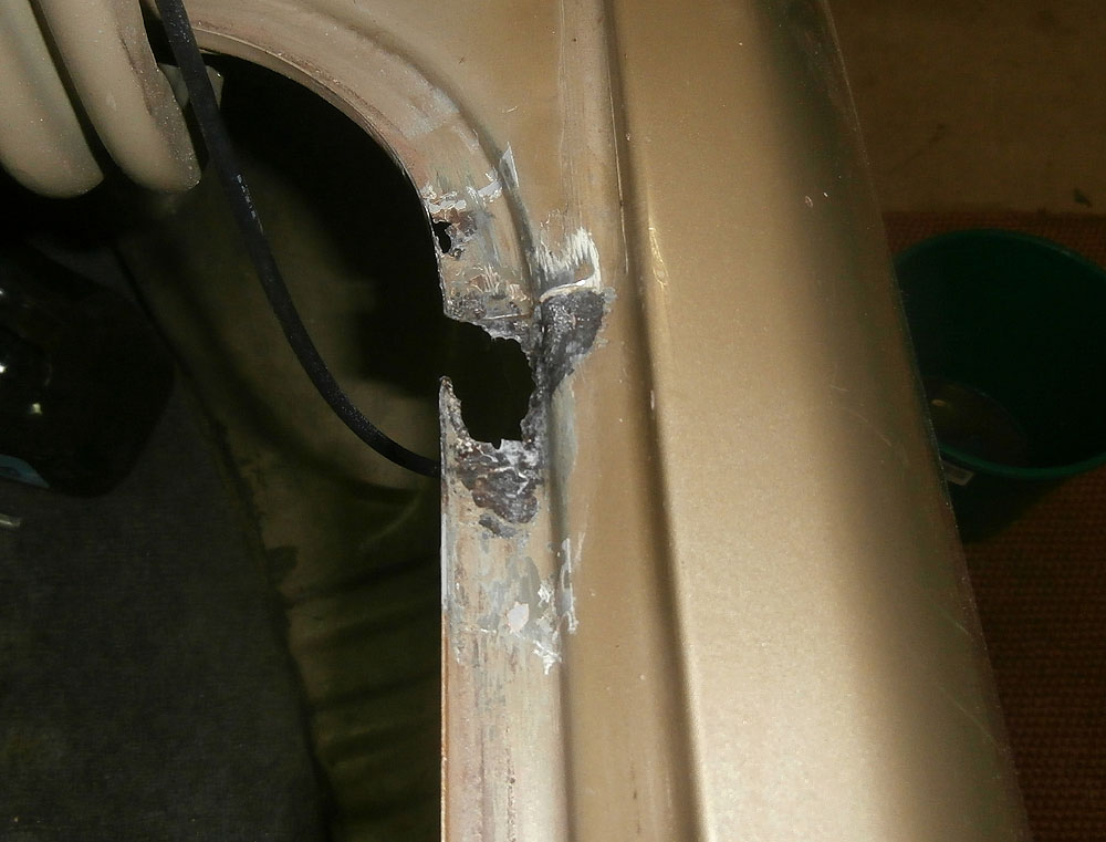

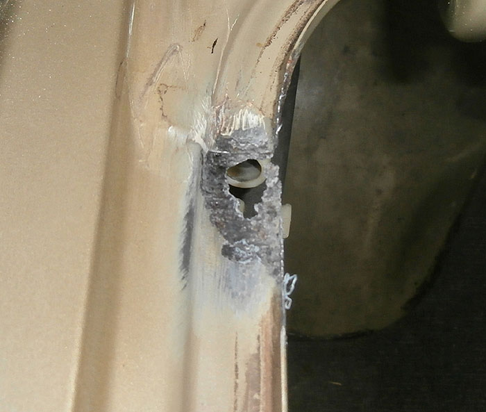

What was it like when you took the boot seal off?
These were the front seams on each side of the boot gutter when I took the rubber seal off and cleaned them up with a wire brush. So they are beside the hinges, just where panels are welded together.
You might also want to look at the rear windscreen seal. I have this exact problem in my KE30.
A new windscreen seal is $130 posted from Phils Rotaries, and Novus will charge you about $155 labour to put it in.

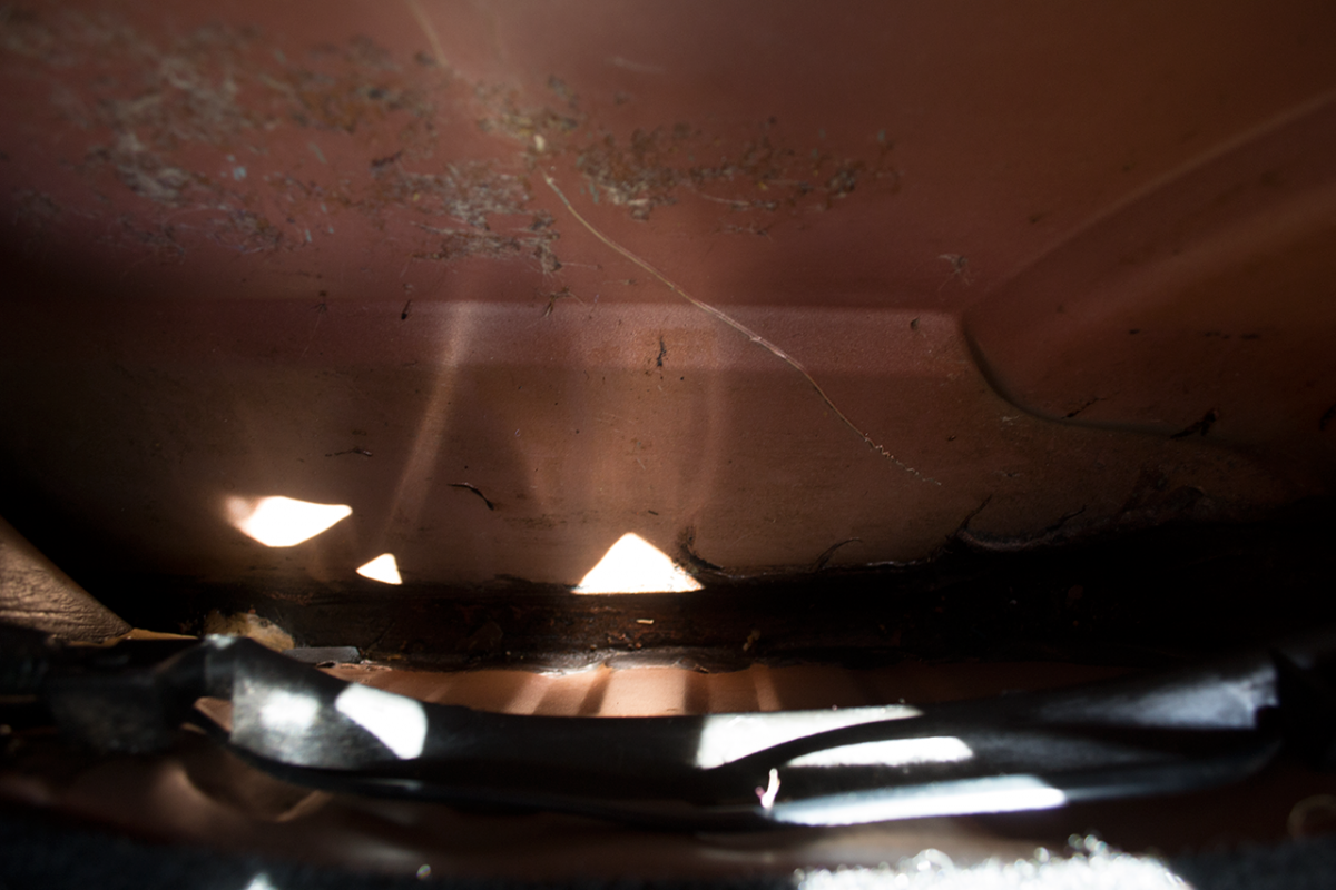

Crap, just discovered the same problem in my 30
Found it when clearing space in my boot, and we were getting heavy rain just a week ago
My boot lid lip is rusty, my seals aren't stellar but should be adequate. Thinking about making drain holes to avoid it again because no money for new seals
